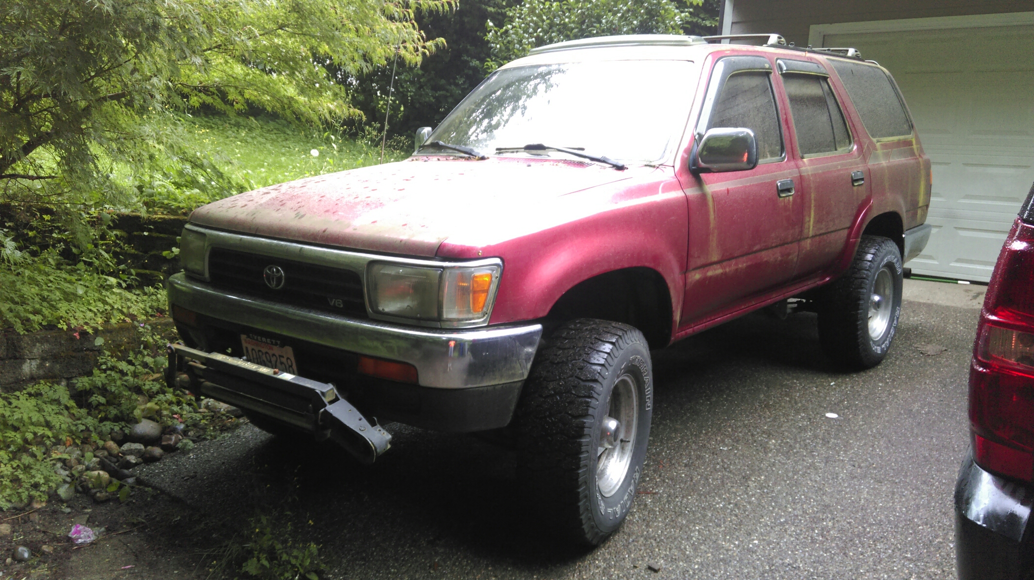

here it is I put a battery in it and started it up and drive it out had to use 4lo cause the brakes were stuck but yeah it's home now

Yuk...the horrid fade and peel prone red.
But on the other hand it was cheap. Hopefully fixing the vac leaks and sanding the ignitor earth mounts will help. Jeep us informed on the issue

Yeah it's more of a maroon color and that paint is in really good shape just a few scratches no rust or peeling I cleaned out all the mold yesterday. I'm hoping to have time to work on it this weekend and wash it real good it's nice to know some ones watching my thread haha
