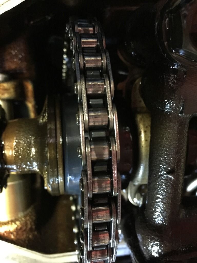

The chain had some galling on the links. Below is a picture with 14x magnification. The galling can be felt with a scribe. I still have my original chain that had 128,000 miles on it. There is no galling on the original chain.

Galling on chain...

Galling on chain...

I'm thinkin, maybe not so High quality.
The loading on timing chain and gears is relatively light, and constant.
The heat treatment of the chain rollers must be weak.
