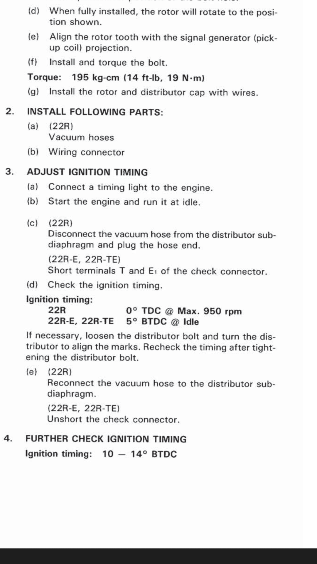

the toyota is almost alive but I've read i have to jump power between this connecter to reset the computers timing. My question is do i jump the connecter then turn the ignition on then set it to the correct timing or would i leave the connecter jumped while i try to start the vehicle again

This is all I got

On my 1993 22re I did it while my engine was running.that is if your talking about timing it. It's the t and e2 by the fuse box.

You can connect the terminals at any time. The manual you are referencing has the engine running when you connect the T and E terminals. Make sure you do plug off the engine side of the hose if you have a vacuum mechanism on your distributor. Prevents a vacuum leak and gives you base timing before the vacuum actuator does its job. Otherwise your timing will be way off.
