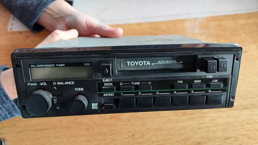

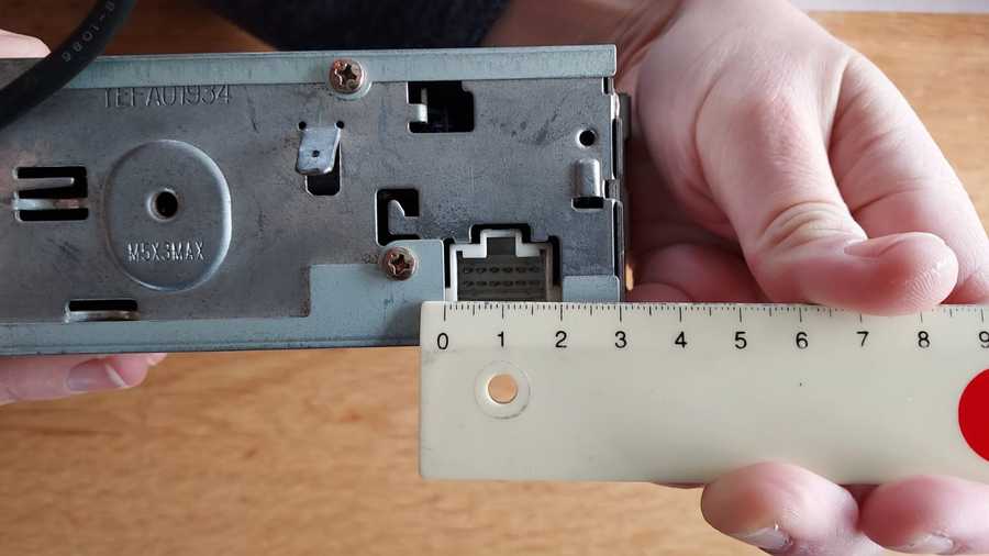

I got an OEM Toyota radio for our pickup,the problem is the PO removed the oem plug and replaced with the one that came with the modern stereo.
Do you know where I can get an adapter for this radio or a way to solve this situation? (2cm = 0.79")

Interesting. Last time I looked, my OEM Radio had a 10-pin connector; you've got 2 more pins. (Not to mention the "LW" band on your radio.)
The 10-pin harness is pretty easy to get: https://www.ebay.com/itm/253281726370

5193? I do not recall that radio number here in the USA. That trim around the edge I'm unfamiliar with, too. But that doesn't mean anything.
edit: ah, ok. that was probably a radio that was sold separately over the Parts counter to be installed in vehicles at the dealer when no factory radio was installed during assembly(which was a lot bitd). Still, they used the same harness and connector.
Like Scope103, my 1987 has two harness connectors for the radio. A 10-pin(with 9 wires actually installed) that handles most everything; and a 6-pin(with 5 wires) that handles the rear speakers. So I'm guessing this radio only handled front speakers(don't see anything for fade, now that I think of it)
What year did the seller claim it came out of?

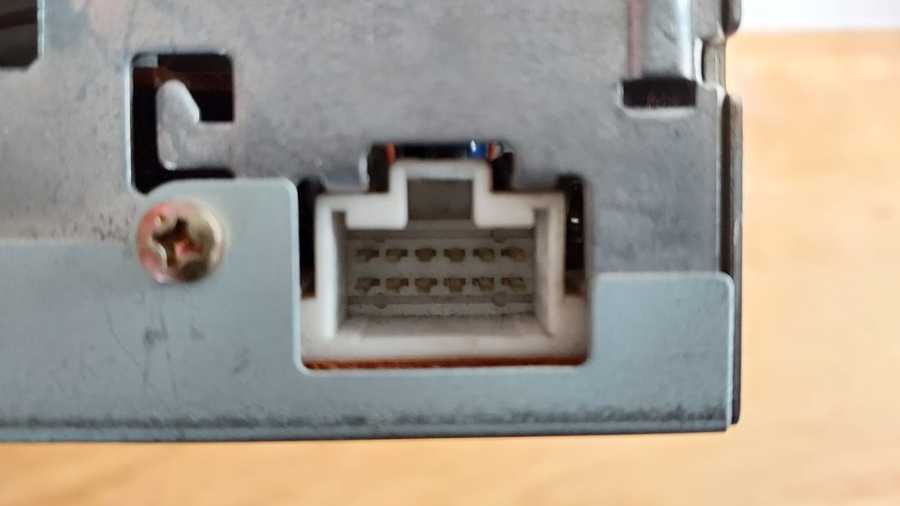

That Female 12 pin connector is not easy to find apparently.

The female connector, harness side, is what I am missing. It looks like it is hard to find.

This is a Panasonic K112 (made that radio) pigtail. The white 12-pin male connector end looks pretty close the size and configuration as your radio female. Even has the small vertical side tabs. Listed as an "old" connector on internet search. That's an old radio.
If the white male plug fits the rest can be cut off to splice to the truck's wiring
Plugs and Harnesses is the website. The site has a link for questions. I'd contact them. http://www.pisi.com.pl/zlaczkiE.htm

That one could work, I already sent a question to the seller, I will report back.

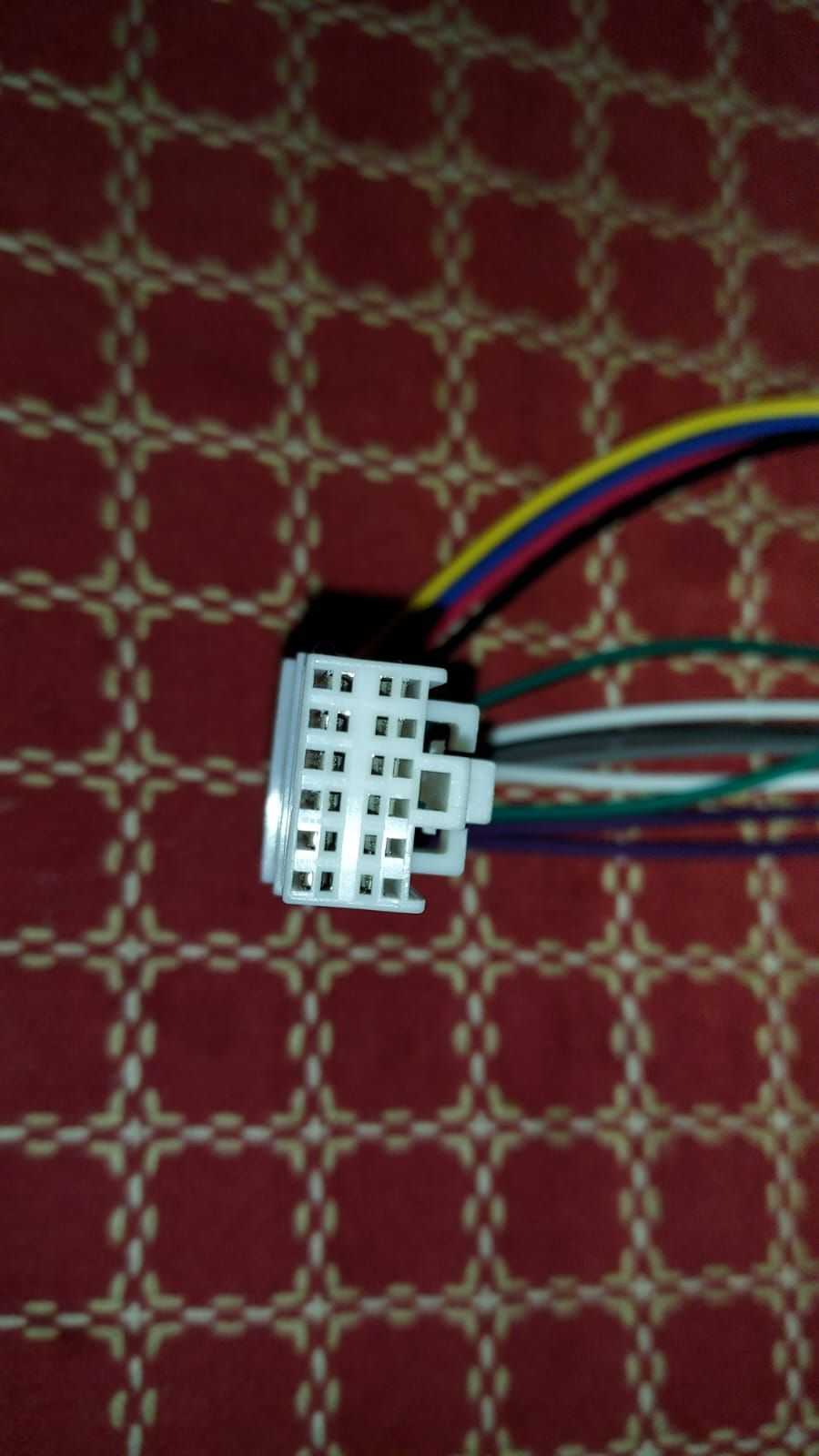

The factory wiring was cut by a previous owner, and I ordered a similar radio off of ebay, which also has this same 12 pin connector. I've looked up those terms, and most often the result is a 16 pin connector, or a 12 pin for sale from Europe. The only place I found that seemed US based was charging $50 or so once shipping was added, which seemed too pricey for me. This morning I made the decision to just desolder the connector from the board and solder in wires for testing. More adventures soon, I'm sure!

This is the one I got for my 1987. Depending on your year it could be different, but at least gives you a jumping off point.
