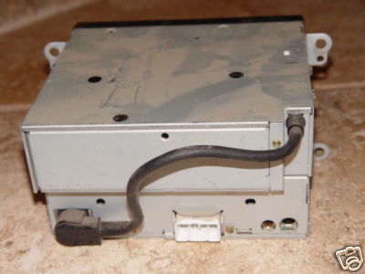

^Ritzy - do you remember how many pins were in the back of your unit.
from my digging (radio model #51706 / cd slave model # L4201) - it appears to be a 15 pin but i haven't had a chance to pull the unit out yet.
I used this link http://www.oemvalue.com/application/toyota.htm and it seems that it is a 15-pin application.
I also found this photo from an ebay auction. Comparint the two leads me to think it is a 15-pin setup.

I will have to check the back of my old radio but the pic you show of this radio is one that will need the external toyota amp. All Toyota OEM radios I have ever used or seen for our Gen 3 runners needs two connectors. Either they are attached directly to the radio or attached to the external amp. Usually with the earlier 3rd gens, you will find the double din style radios are actually two seperate units. The radio head unit will then plug into a disc player, cassette player or some other component. Thus the single wire plugging into the the radio head unit. They usually require the external amp, so there will only be a single connector on the second part of the "radio". The amp then plugs into it and the OEM harness plugs into the amp. As I learned, the 2000 and up OEM radios use a different pin configuration for the external amp so be aware of this difference in the radio/amp connection. The amp will still have the standard Toyota harness plugs though.
The link you show is a good source of information and it does seem to cover pretty much everything I encountered.

yeah. i have a "two separate unit" setup.
so i think most of those i posted above are out because they are 20-pin.
the only 15-pin is this one or this
