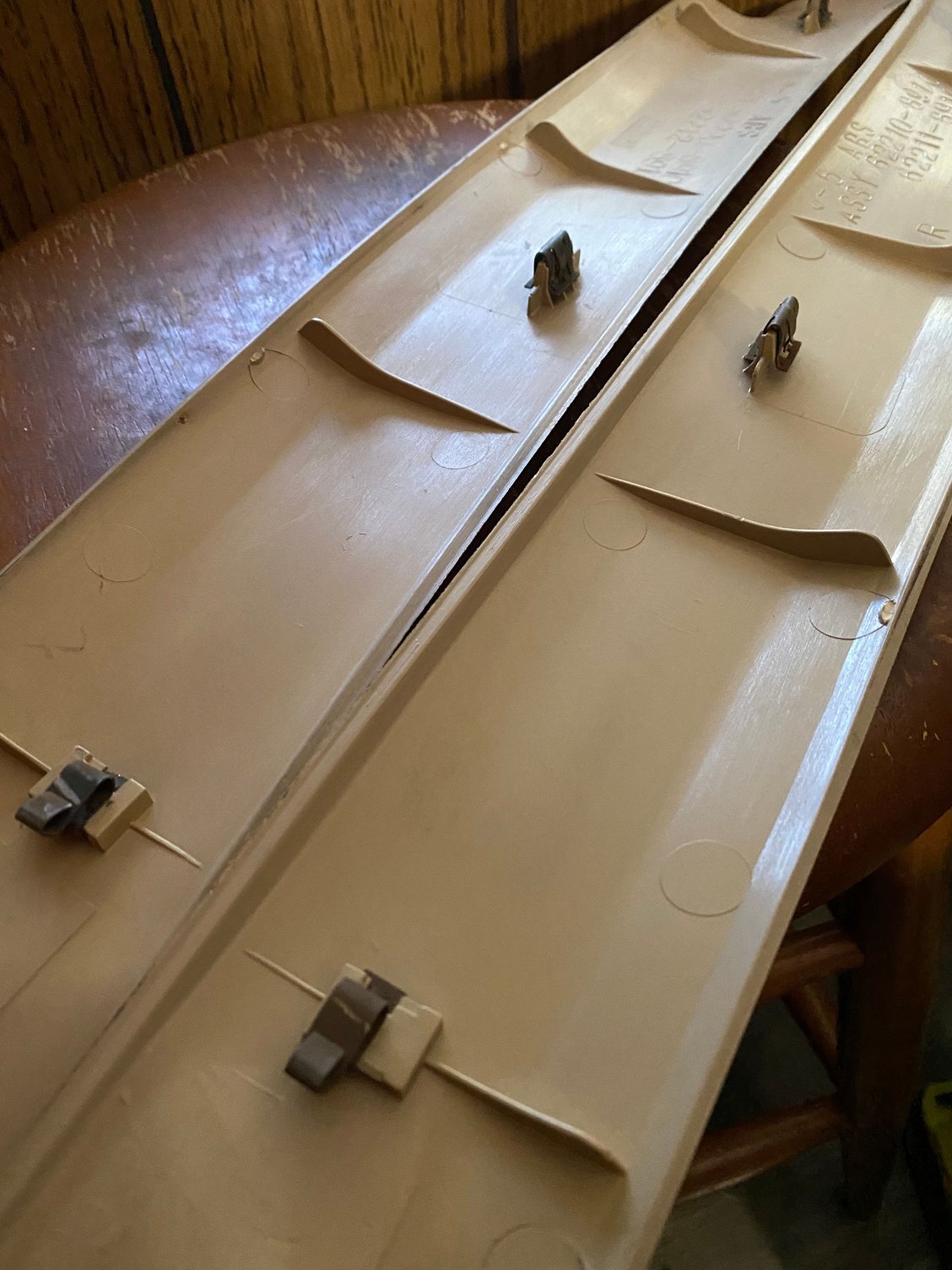

I broke mine into 20 pieces.
I have a new set ready to go in so I looked at the back for you.
There are 3 clips, the top two pull straight out and the lower one lifts out.

Thanks. So gently pry up on the top two clips then lift the trim panel upwards to release the bottom clip? I'm hesitant to try as all the plastic is old and brittle. I removed my dash panel when installing new AC/Vet control assembly and one of the two center vents fell out the back. It hit the concrete and shattered into 20 pieces as well. Luckily, I had an extra complete set I bought to replace the broken right vent.
I appreciate the reply. It helps a lot.

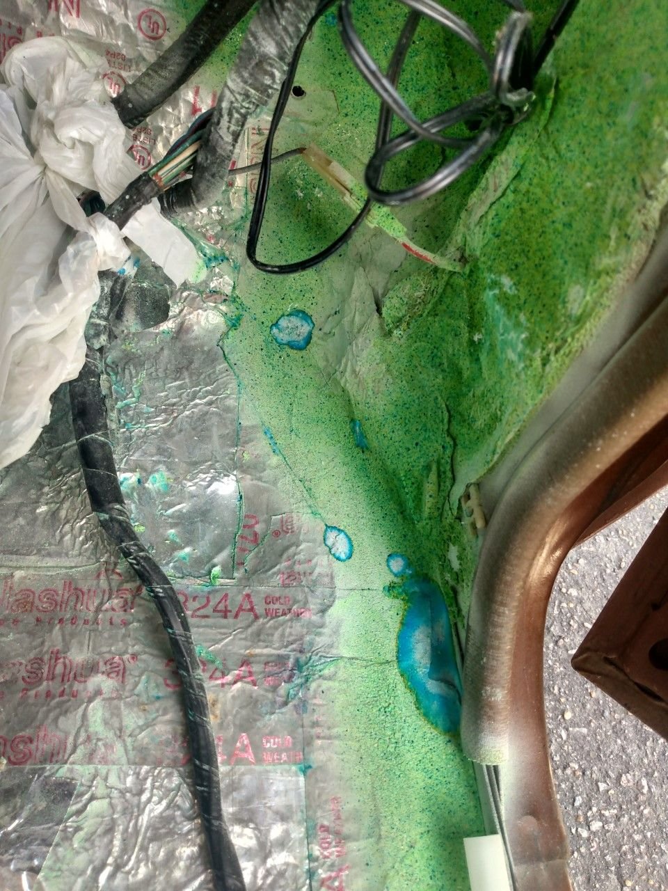

Good idea. Removing it will be my last attempt to find the leak source. Looks like drips down from the A-pillar area. Cowl removal is my 1st look to see if there are holes in the sheet metal up in that area. These spots are from a light rain. A heavy rain will cause a pooling of water in the center of the foot well. The green coating is a powdered spray that turns blue when water contacts it. It's expensive, but helped me narrow down the leaks locations. It wipes off with a damp clothe.

Thanks. Has AC and have been running it with no leaks. Have pulled the carpet back and fully sprayed the dye on areas were water could run down or drip. Only a small leak with light rain and pooling with heavy rain. Leaky windshield joint or a hidden rust hole. Truck is rust free on the cab, so far. I will find it eventually.
