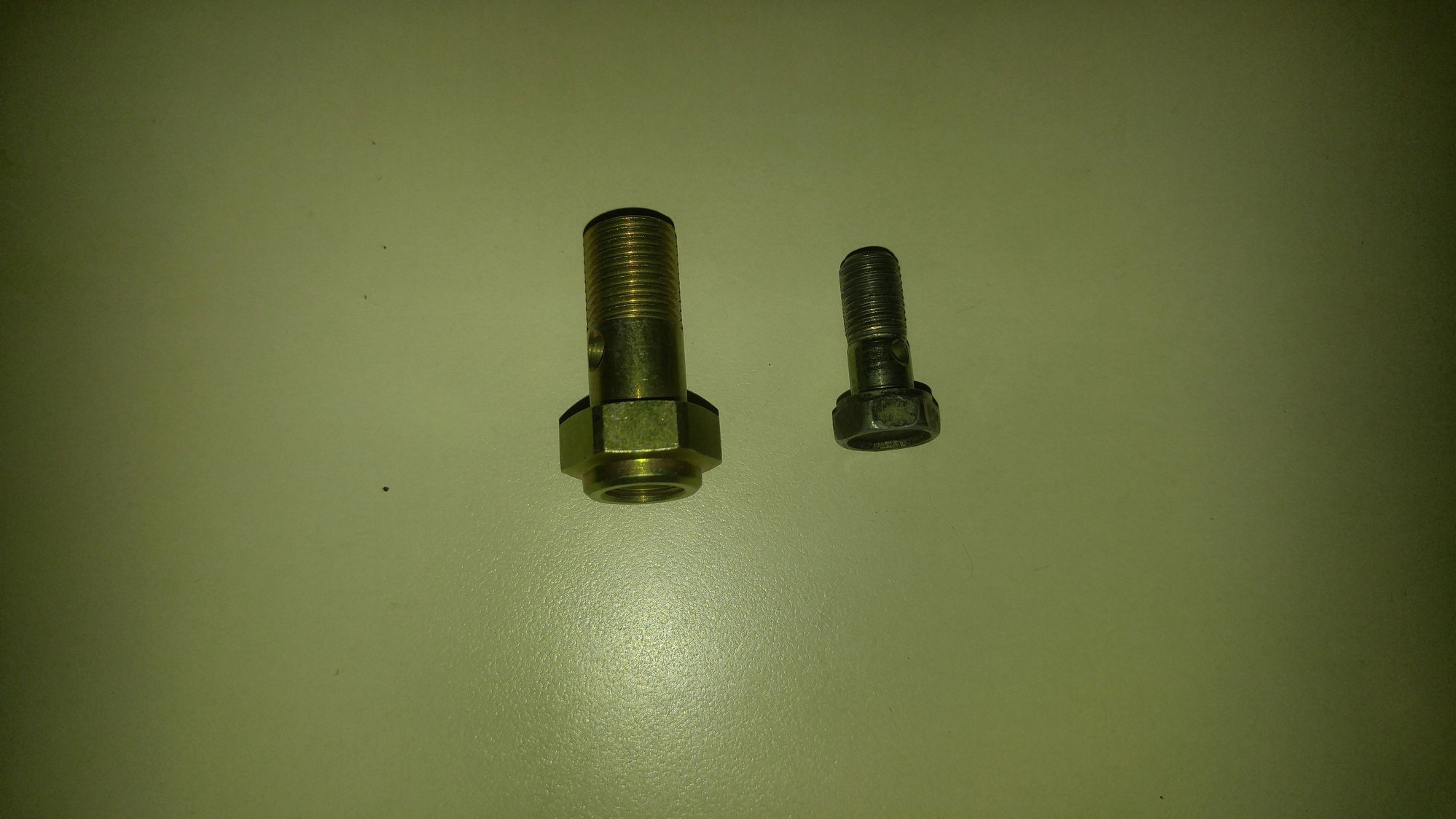

That banjo bolt is the wrong size, seems you have to bite the bullet and get the $20 LCE one: https://www.lceperformance.com/ProductDetails.asp?ProductCode=1093076&CartID=1

Originally Posted by Paul22RE
That banjo bolt is the wrong size, seems you have to bite the bullet and get the $20 LCE one: https://www.lceperformance.com/Produ...93076&CartID=1
that's the one i bought, it fit my 94 4runner 3vze perfectly, maybe the thread is different on the 4 banger

The 12mm banjo bolt is used at the fuel pressure regulator.
The LCE banjo bolt is smaller (10mm?) to be used on the CSI.

On the left is the eBay one, on the right is the one that fits in the line for the cold start injector:
Oh, didn't know some folks put the gauge on the fuel pressure regulator banjo bolt.
after looking back over thread i didn't realize they were using the csi port, my bad, any way this is how i checked fuel pressure
not on a 22re they don't. the csi fitting is the most practical location on this engine.
