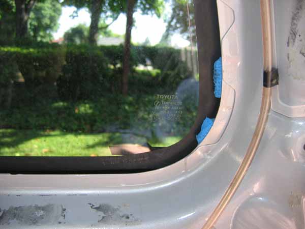

hey guys,
ever since the last DV trip, i had this annoying sound coming from the rear passenger's side. for months, we could not pinpoint it until today. i took off all the rear cargo paneling and then took down the rear cargo part of the headliner to see if i could duplicate the sound. at first, i thought it was coming from the rear headliner. only after becoming very frustrated and creative, did i figure out the source of the noise.
turns out that its the rear cargo glass. its a little loose. so when i go over lots of bumps, there is this annoying tapping sound. so what i did to duplicate it is i grabbed the passenger side rear hatch piston and compressed the rear of the vehicle by it. the sound came from the bottom rear of the rear cargo window. i would compress my 4runner and make it squeak and then id put my finger on the glass and the noise would stop.
i took some anti-fatigue foam (the kind you stand on in a shop) and compressed/shimmed it into the space between the inner sheet metal and the glass. it works but i know eventually, the foam will lose its ability to stay expanded. either i will have to use a more stiffer foam or fix the window.
i believe that there might be a tear in the window's gasket. so my question (finally) is "is it difficult to replace the rear cargo window and the gasket?" i beleive this will be a more permanent solution
thanks,
bob
Attached Thumbnails temporary window fix for tapping noise---permanent solution?-a_shim.jpg   temporary window fix for tapping noise---permanent solution?-a_compress.jpg

ok, problem solved. i went to my friend's auto body shop and he had one of his window vendors come to his shop for some work. while i was there, they fixed my window. they took this right angle cutting tool and cut the window out. they cut straight through the 4 plugs and glue holding the window like butter. they did not reinstall the plugs. all they used was some thick black gasket glue and that was that. no rattles!
so i am going to leave off the interior panel for a few days to make 110% sure that the window doesnt make any noise.
cost? $35. the normal shop cost is $45, so even if i paid the normal rate, i wasn't breaking the bank on this one
bob

well as i suspected, it was the rear window. i have been driving w/o the plastic interior paneling since i had the rear window redone and not a single tappping noise. therefore, i put all the stuff back on and not a single tap back there. and i drove 120 miles today too!
so there you have it. a $40 fix...and to think, i thought this was going to be an expensive fix :dizzy: oh, definitely let the pros do it. the guy was a mobile auto glass window repair guy. it could easily be done at your work or at your home.
bob
