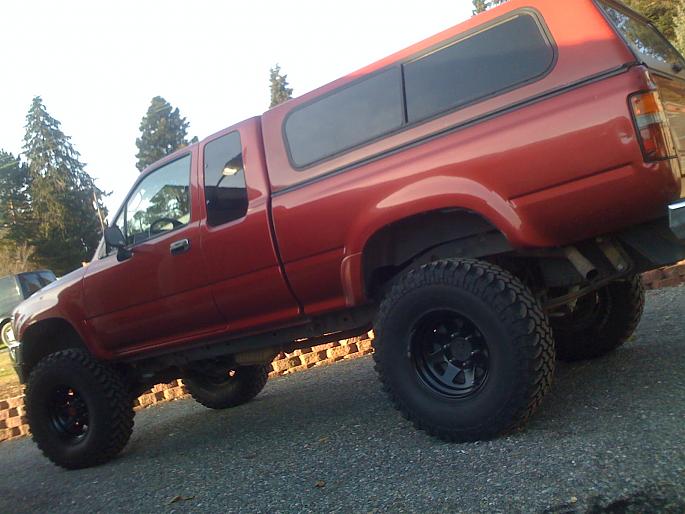

I scotched brite my canopy and picked up some Gloss Rustoleum red and black in the 1 quart can, then added black to the red a little at a time till I was satisfied with the color, thinned it out a bit and sprayed it with an HVLP gun. It came out pretty good.
https://www.yotatech.com/attachment....2&d=1236912602
