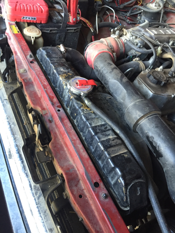

Ovrrheating getting worse overtime-image-4262603939.jpg It doesn't look original. When I flushed it it did have gunk come out. The t stat I put in has a 3/16 hole in the bottom as well.

That radiator looks like a 3 row?
My rad has space in front of the frame cross member.
Granted - thats like the 3rd radiator (370K on the odo)
gap between the rad and the cross member
I usually stuff a 2" block of foam in here (i.e. AC weather strip) - It had that weather strip when new
