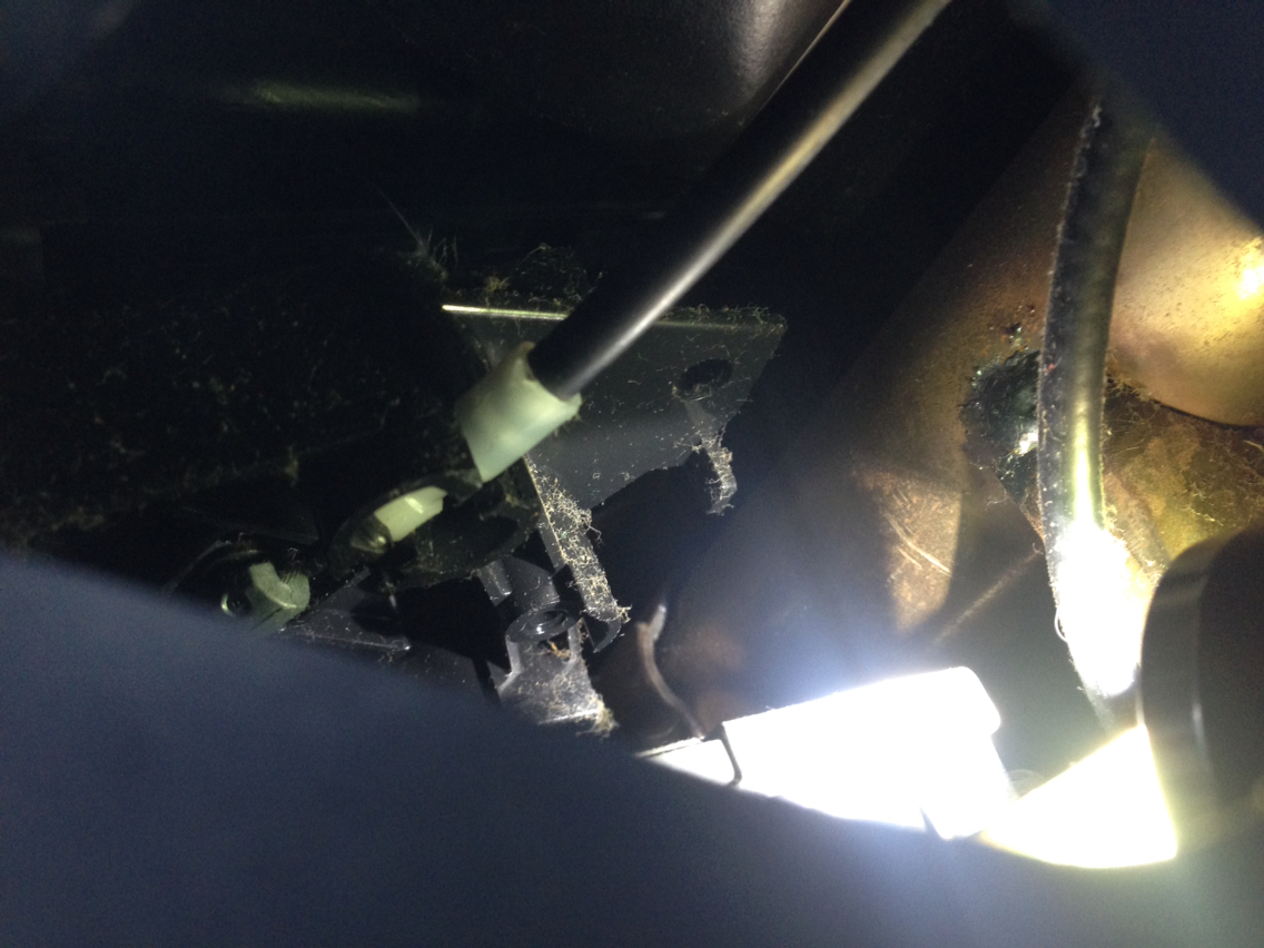

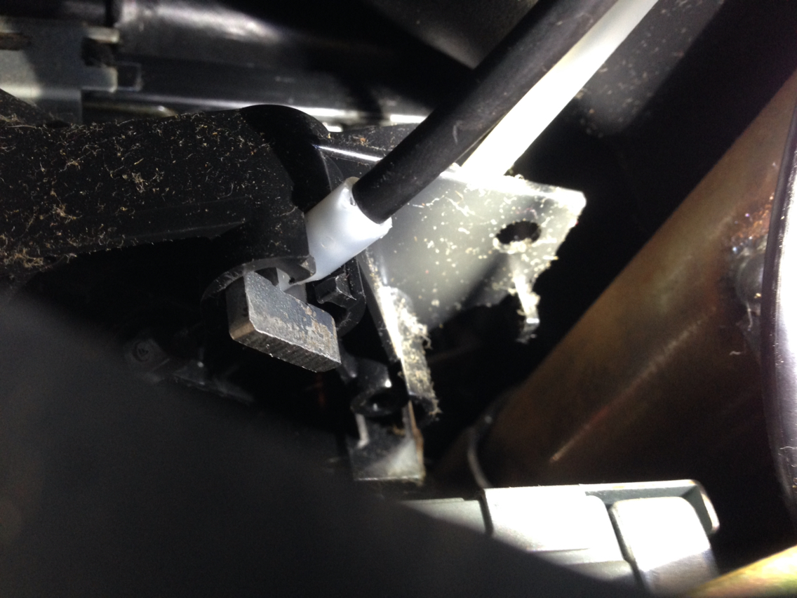

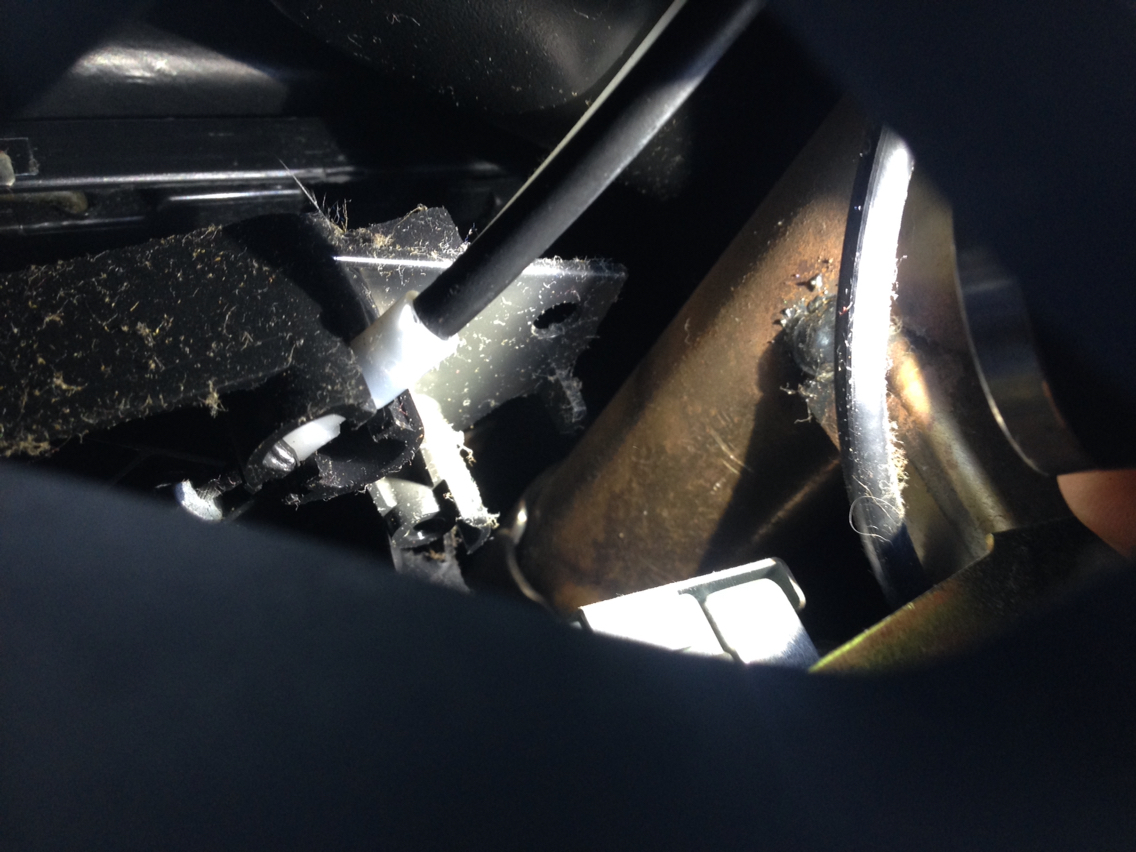

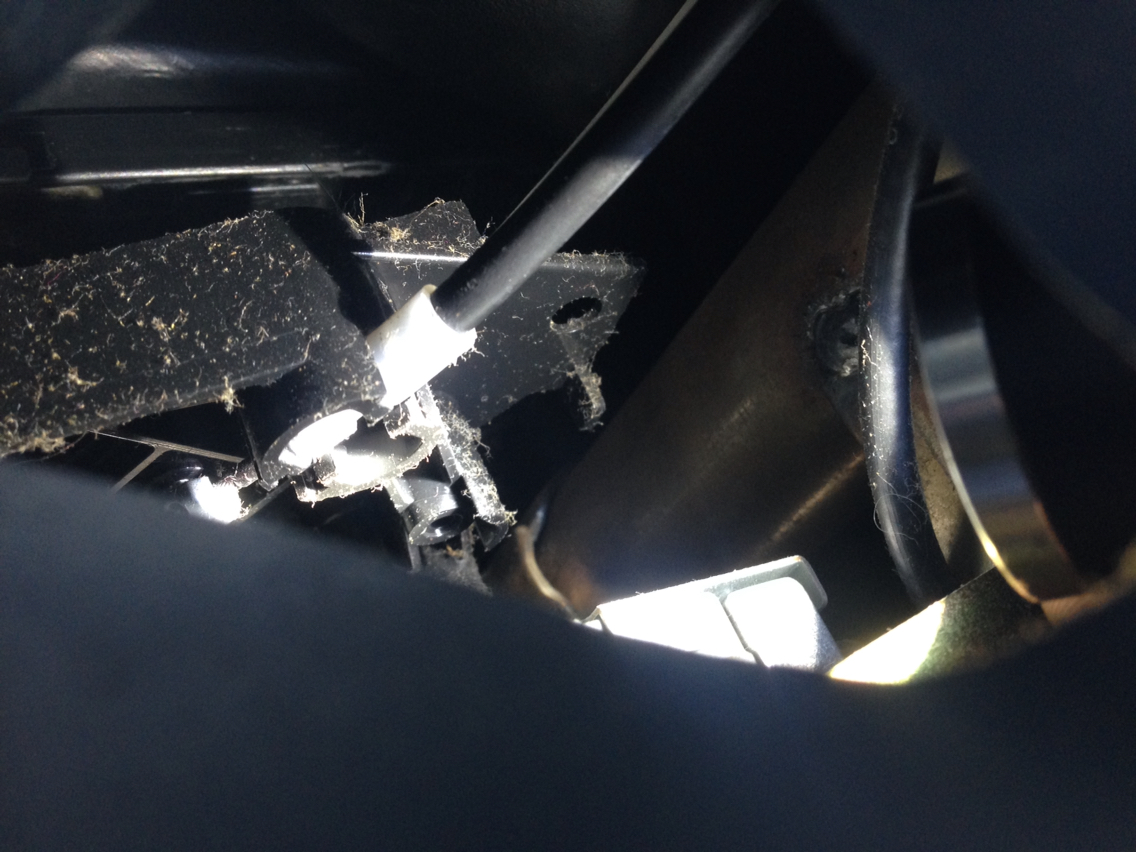

Ok, back at this. I put this on hold because I was able to slide it to the heat section by hand down at the footwell. But now that it's getting warmer I need to be able to adjust it at will.

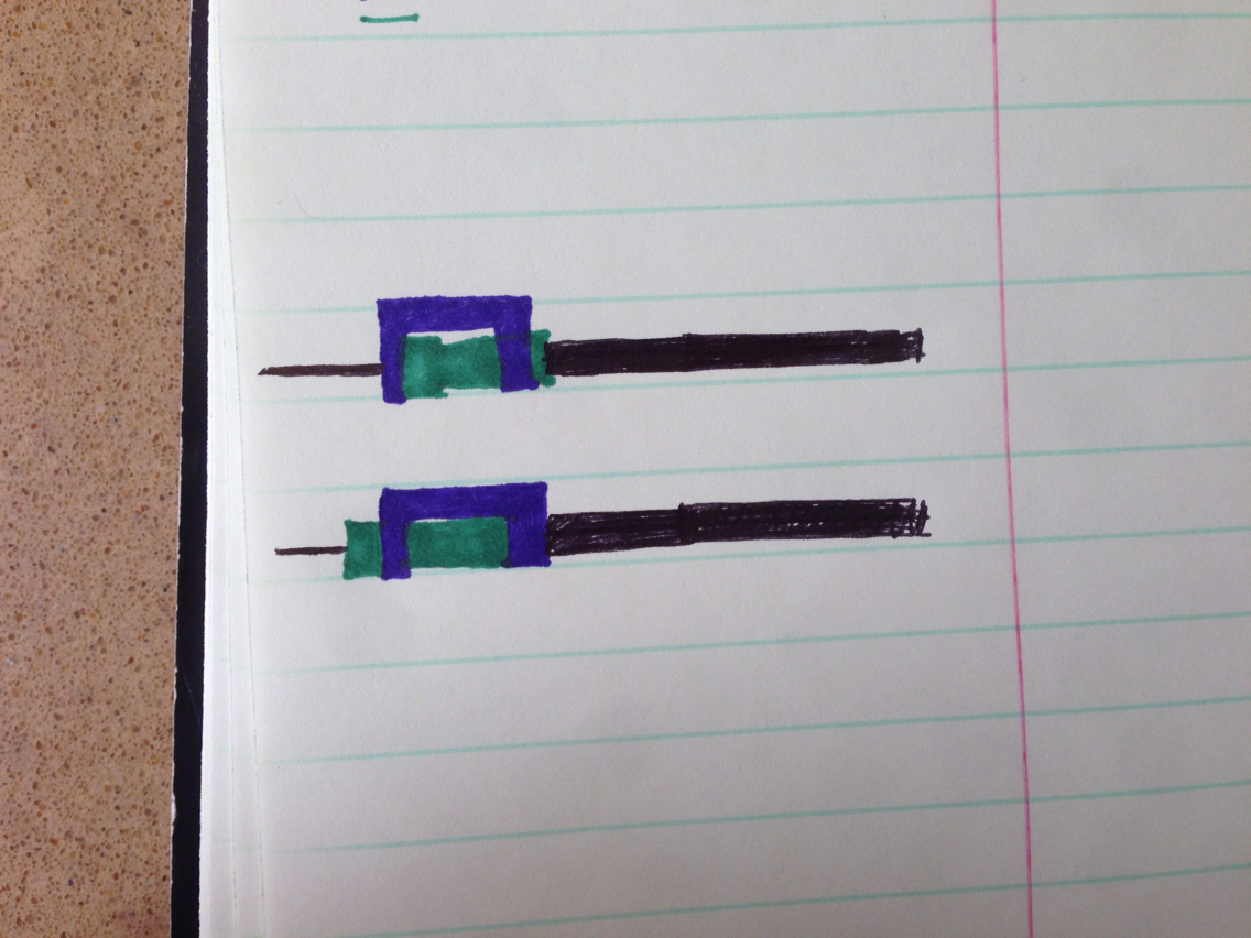

I have the dash apart a little and I see the connection. I just have a question how the white ferrule/connection thing is supposed to be held on by the little black plastic bracket. I took some pictures and also drew a little simplified diagram. To me it seems like the white ferrule got dislodged and is just free to move around when I slide the heat selector. I tried to push it back in but it's really tight so it's not easy to do. Anyone have a picture of this on a working truck?
In my drawn diagram it's currently like the top one but I think it should be like the bottom one. Is that true?
Thanks in advance!

Originally Posted by dropzone
Hmm, thanks Dropzone but I think I came up with a remedy. I made a metal clip to slide up into the black plastic bracket to hold the white ferrule in place. Seems to work well.
I'm checking out that link and it's hard to see the diagrams in detail but I'll refer to this if my makeshift clip fails.
Thanks!

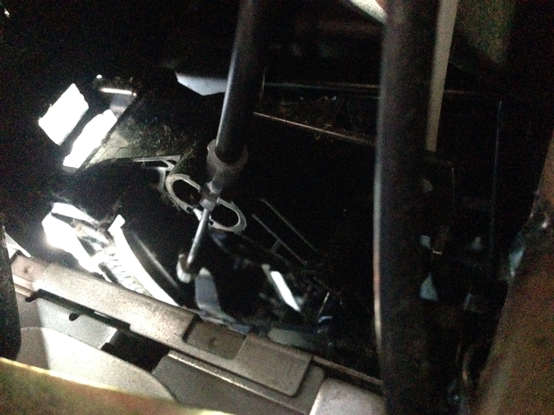

Oh, here's a picture of my clip installed.

looks like your solution will do the trick.
