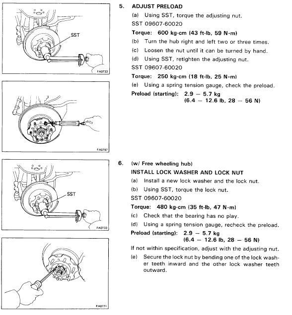

What? According to Toyota, the bearing preload is 0.6– 1.8kgf, 1.3–4.0lbf http://web.archive.org/web/201204242.../5frontaxl.pdf
According to the video (if you wasted all 45 minutes (!!) watching it), the presenter thinks "from memory" the manual says 10 lbs!! (Plus he uses 20 ft-lbs instead of the spec 25 ft-lbs for torquing the nut, but given how far off the rest of it is I'm not going to worry about that detail.)
Frequent visitors to this forum know that the Toyota FSM is available, and easy to get to. It is interesting to me why some people will bypass what Toyota says and rely on some guy in a greasy sweat-shirt on YouTube. (Okay, there are plenty of YouTube videos where the presenter will actually show you the page of the FSM on which she relies. Like South Main Auto channel, for instance.)
Don't believe everything you read/hear.

I think I just wasted two sets of Koyos.
I was thinking... This can't be right, but ok... It's a fat 4x4 tire...
I need to research the FSM, which I have, printed the fk out...
So it's 1.8 KG of starting preload, right?
I'll try to save the bearings....
I did feel the hub all the time in the first days... Never got hot?
Wasn't there something in the fsm about new vs used bearings?
Old 10-07-2019, 10:12 AM
ev13wt's Avatar
Join Date: Oct 2018
Posts: 602
Received 117 Likes on 88 Posts
Sorry for providing incorrect information. Mine is a 87 4-Runner.
So I see in the 88 FSM it states up to 5.7 KG. So maybe I didn't kill them after all.
So I am guessing they must have changed the setup in the 93+ models?
Jeez you guys my heart!!! I was ready to go lift the front end on the street with two bottle jacks. Its dark outside already. !! CONE WASHER NIGHTMARES !!
15 minutes of panic!
