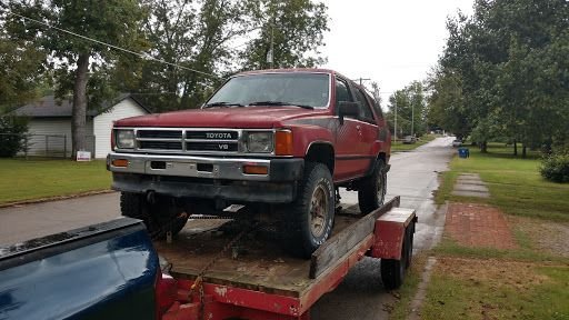

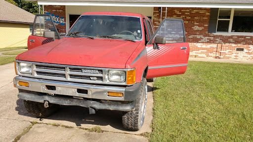

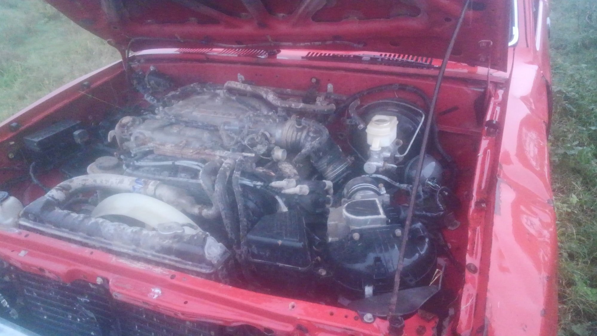

Hey all,
Just got this '88 4runner last week. 3vze auto trans, but it was free so cant really complain! Long story short I was told it has a blown HG, and last sticker on the plate is 2009. It comes with a spare motor out of a '89 (I believe) that we will go through and freshen up. The frame still has the rubber plugs in it, and from the drain holes it looks like new inside! Got good 31x10.50's on it.
Couple issues noticed off the bat.
1. Centre console (along with switches) are missing, as well as both driver and passenger kick panels, and radio.
2. Missing 4 bolts for the rear top, and the rest were loose. Tightened them up, doesent look like its been leaking though.
3. Since I am missing said switches and console, I cant get the rear window to roll down. Kind of a pain because now I cant get the tailgate open.
4. Blower motor is not working, and neither are the front power windows or doors locks. Not sure where the fuses/relays would be to check this?
5. Obviously the engine doesn't run, I am going to replace the fuel pump and clean tank, then test that.
The wiring appears to be intact for the most part. No chewed wires anyway.
I think the game plan for this truck is to first rid the interior of the ants that have taken up residence in there. Then I would like to get the windows operation if possible. Also, while messing with those things I plan on dropping the fuel tank to do a proper tank cleaning, and to replace the fuel pump and filter. Then I will see if the old engine will run. I dont expect much....radiator is bone dry lol. If it will run long enough to test the trans I'd be happy.
A few things I'm gonna need....
1. Centre console
2. Switches that go in the centre console so I can test the windows
If anyone has ideas, suggestions, or any help it is greatly appreciated! If you have some of these parts I need please let me know!
Thanks

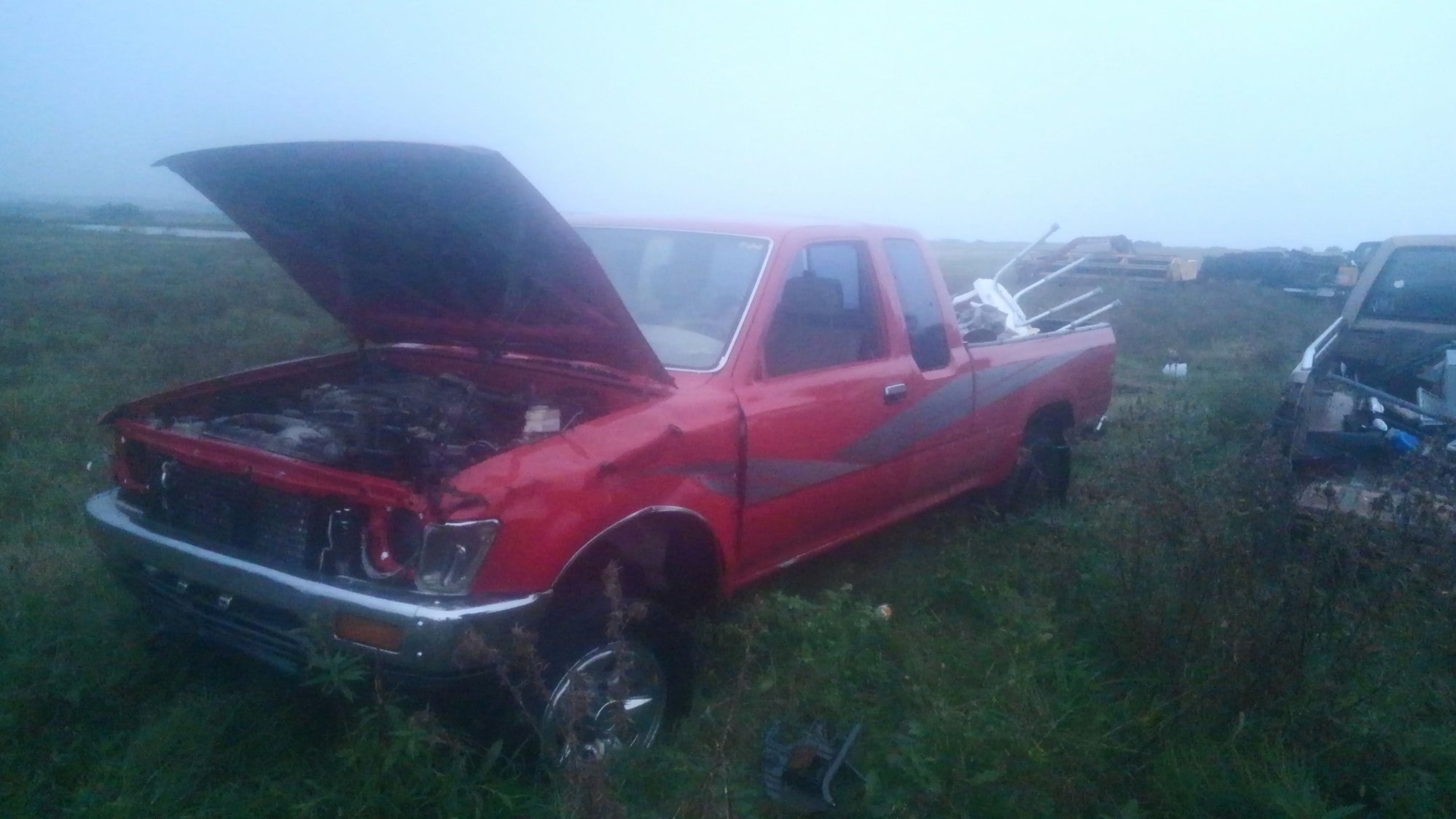

Went up to Kansas to look at the parts truck today. Forgot to check the VIN so idk what year it is. It's a 3.0 auto 4x4, with auto locking hubs. I pulled the kick panels and ash tray hoping they would fit the 4runner but no dice. I guess they mount different than the 4runner. Anyway it's got 145k miles on it. Super rough but should be good for parts. Handy to have a lower mileage trans as a spare.
Old Oct 5, 2019 | 04:18 PM
MapleLeaf's Avatar
Joined: Aug 2019
Posts: 10

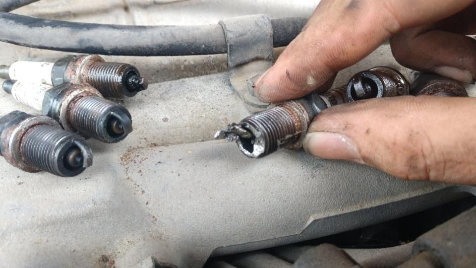

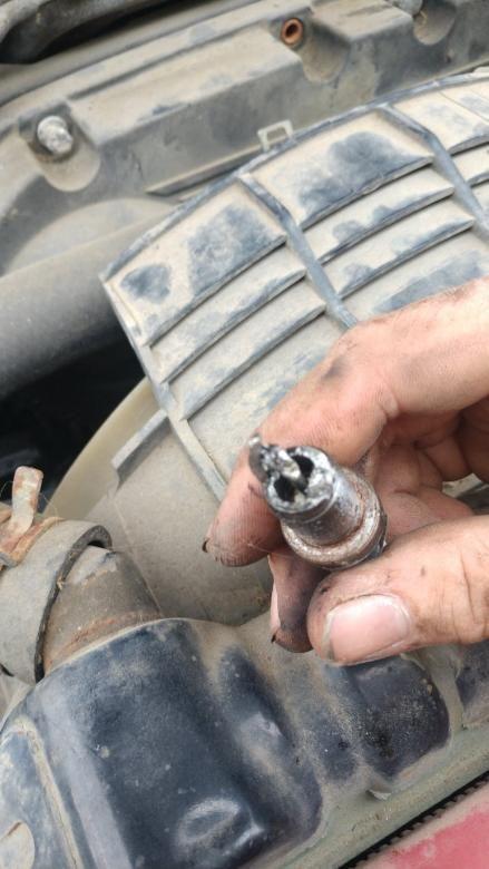

So I did a compression test on the old motor today. Results were scary lol. I could hear when it cranked over that it had no compression on one cylinder, and sure enough #6 was toast. Also #6 was one of the most hammered spark plugs I've seen. IDK if it dropped a valve or what....piston still moves.
Old Oct 5, 2019 | 04:20 PM
MapleLeaf's Avatar
Joined: Aug 2019
Posts: 10
Also took the switch apart and got the power locks working. Likely need to buy new switches as the windows won't work. I think I broke a spring inside the switch itself while disassembling.
And we found that the windshield is leaking slightly on the top passenger side. I really hope it's not full of rust under that metal trim.......
