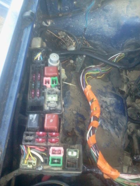

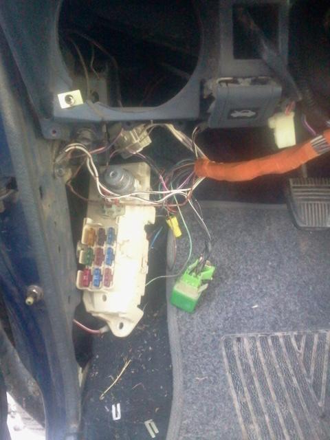

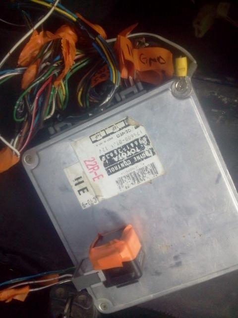

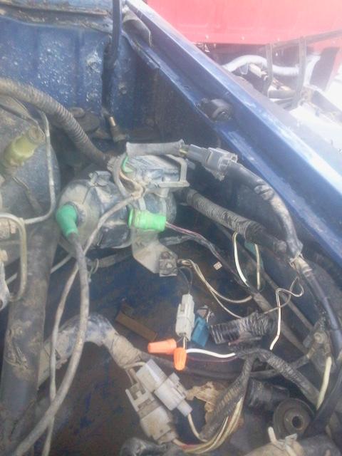

Here are some pics of what im working

That is an electrical mess on your hands. Since the injectors appear to spraying and you are getting spark. I suggest checking the Timing or maybe you have a broken wire somewhere. That will be needing a resistance check. I don't know if the computers are interchangeable with the different harnesses.
The 86 and 91 harnesses each use different injector with different resistances. Depending on which computer, harness, and injectors or how they may have mixed matched them, it could be a tough fix.
I am currently converting a truck from carb to efi. I would suggest getting a complete harness from an 85-88 truck and re doing it. Here is how to remove one https://www.yotatech.com/forums/f199...l#post52150377 as soon as the weather warms up I will start re installing it.
Just the way the PO did that, about the only correct way to fix it is to install the correct gen of harness. Even the 85-88 have several differences but either would work.
