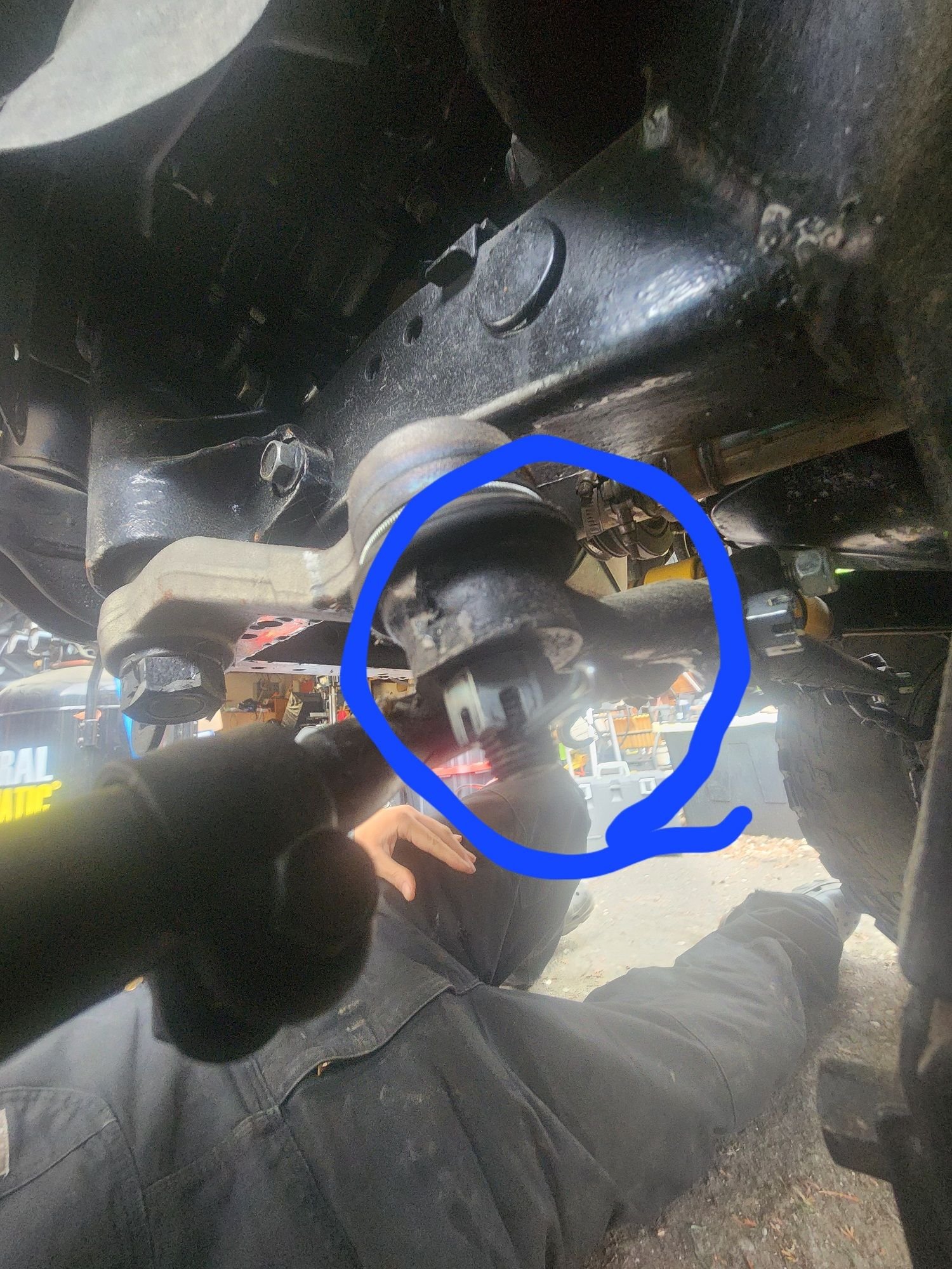

Hey guys. I have a question about my new pitman arm that hopefully someone can help me with.
I have a 1991 Toyota pickup dlx 4x4. I recently bought a new steering box from Redhead Steering gear.
I put on the new pitman arm that I got from LC.
I torqued the big side that connects to the steering box to 130 foot pounds and tried to torqued the smaller side to 67 foot pounds but only made it to 50 foot pounds before it started to spew grease from the overflow nipple on the boot.
My problem with the big side connected to the steering box is that the gap is much more than my old pitman and steering box and I don't know if that is okay or not. The gap is a little more than half an inch.
My problem with the small side is I don't think I can get to 67 pounds of torque and am wondering if 50 pounds is okay and will be fine?
I drive this truck thousands of miles a year way out in the mountains so I am looking for a second opinion on what to do from you guys.
It would suck to have a breakdown all alone somewhere with no cell service and no help etc for a pitman arm.
Would you leave it as is and run it? Or does anyone have a suggestion on what I should do? I can try a different pitman arm if I have to.
Thank you.

The big side I generally give a few light taps with a dead blow to get it seated up there before I torque the nut. The small side as long as you can get your cotter pin through the nut and it’s fully engaged you are fine.

Problem with that is that the nut goes to far and then the cotter pin isn’t engaged at all.

I'll try to torque it down properly with the new center link and pitman that I ordered. As you can see in the pic the codder pin isn't going to do anything. I thought maybe the hole that the pitman goes into on the center link may have been damaged so I am trying a brand new oem center link. If I torqued to 67 pounds I feel like the boot would be completely crushed currently.

Correct. look at the pic that I just posted.

I’m pretty sure i had this problem as well and i stacked 3 or 4 washers on it. Also some castle nuts are taller than others making it less of a problem for the cotter pin to engage where it’s supposed to.
