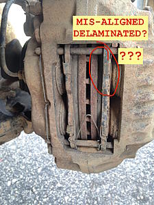

Take it apart inspect thoroughly, and clean. It's not that hard, and doesn't require special tools; just a pair of long nose pliers and screwdriver...
Your pads are worn out. I used OEM from Toyota Parts Deal on front but happy with NAPA non-premium on my rears. I've started getting my parts from NAPA if prices and availability are better than Toyota Parts Deal.

Hmmm.
Replacing those pads certainly won't hurt, but I DON'T think those pads are worn out. The pads with the groove in them (like Rad4Runner's picture) have the groove to within 1mm of the backing plate. So, yes, when that groove is gone there is only 1mm left, and it's time to change the pads. I have seen pads (most commonly for 2wd, but hey?) with no groove at all.
What this means is that cdemery may not be running on the wear indicator, and the cause of his squeak may lie elsewhere. it wouldn't hurt to replace those pads (Rad4Runner's instructions are as good as anyone's, but here's the manual if you're like me: http://web.archive.org/web/201203161...8-4wds1212.pdf ), but I wouldn't be disappointed if the squeak remained.

The pads are aligned correctly, the dark spot you're seeing is a shadow. I looked at the picture and then looked again at the pads because it spooked me as well.
So I'm going to replace the pads and see where that brings me. I didn't have time to get it done today, apparently getting out of the military is a much more time consuming process than joining haha
