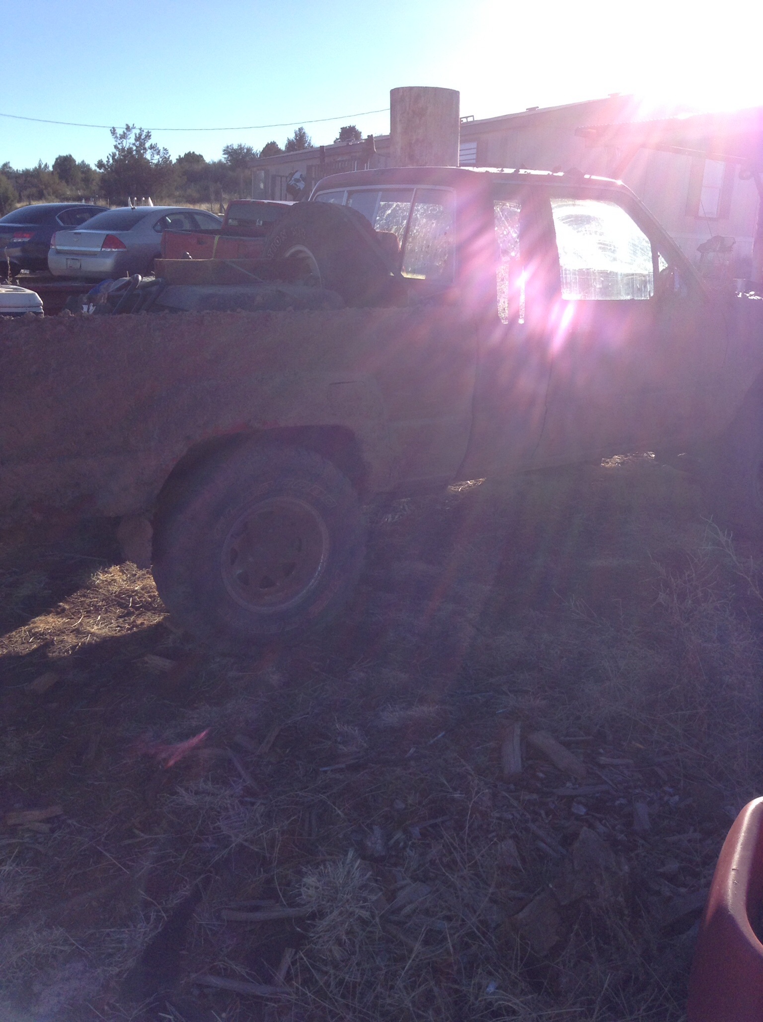

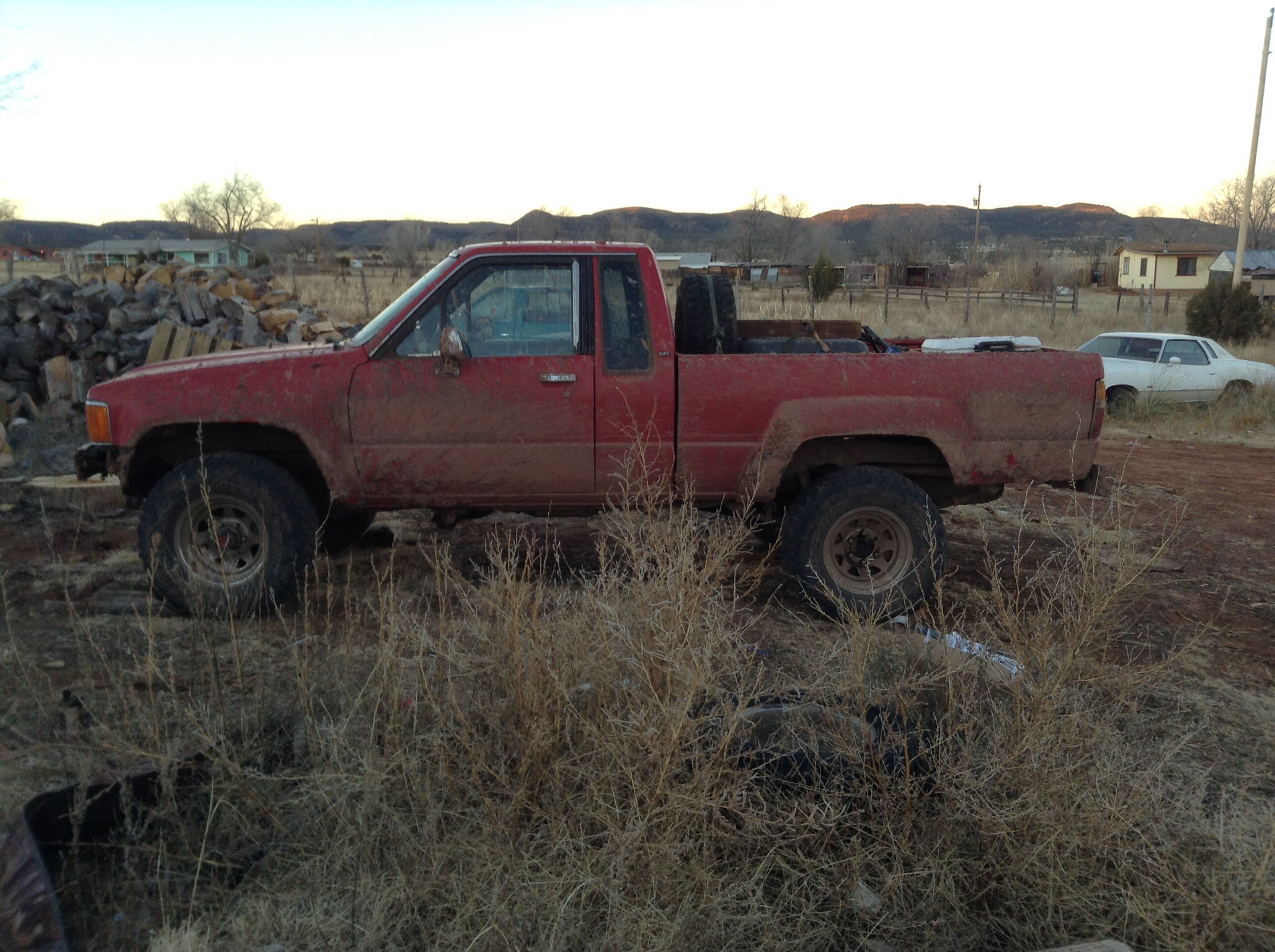

Zuk'd my 86 with some cj springs so glad I don't have that saggy butt syndrome that I see a lotta 1st gens here suffer from. Used bottle jack and spring compressor (o'reilly's is awesome, free tools!). Anyway here is some pics
Passenger http://imgur.com/o0GmlqR
Driver
http://imgur.com/sIlz0dL
How she sits after!
http://imgur.com/7E03fre
Offroad: I'm not too hard into offloading although I have kicked up a few pebbles and splattered some mud puddles with these springs on. I'm guessing my leafs are pretty kay'd because the ride isn't the greatest over bumps and crappy roads, but its a truck so I'm fairly happy with this mod.

Oh and found the springs on a 5(I think it was a cj5) at a pick and pull 25 each
