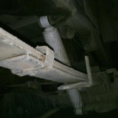

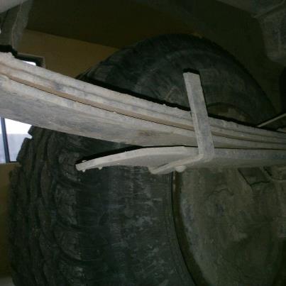

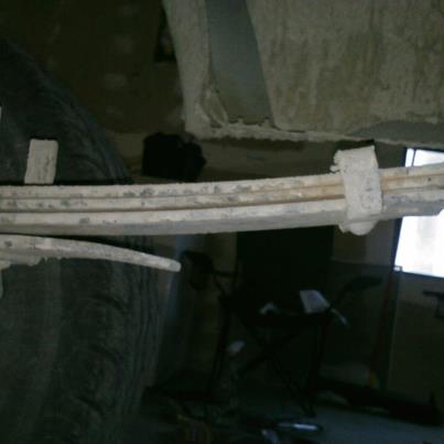

Originally Posted by ZUK
I was able to click on your links and the pics opened up....Looks like your truck has enough lift in the rear to match the front already. I don't see you factory stock leafs fully sagged on the overload.
The best way to make sure the coils will never fall out is to jack the rear bumper up til the tires are just barely touching the ground...then measure the space where the coils will go in. Should be 14 inches or less.
Thanks. I will be checking that in the morning when I get home.

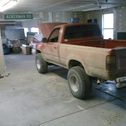

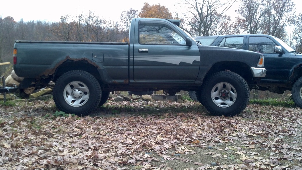

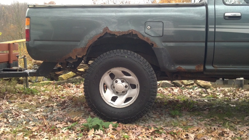

Ok guys, I'm finally getting around to doing this myself! I'm tired of the sag on the truck and I can't haul as much as I'd like. Read this thread, read Zuk's and Junkers88. I called Southwest Speed and messaged the Zuk for some more info. I have decided to go with the 5" x 13" x 150lbs I'm going no cut mod...Just don't want to cut it up if I don't have to.
I'll be starting a thread soon...Pic's to come! Here is how she sits now as of now with the new rims and tires...
Don't look at the rot, will get to that this year as well.
Ok, enough of the hijack...

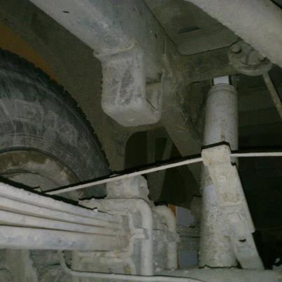

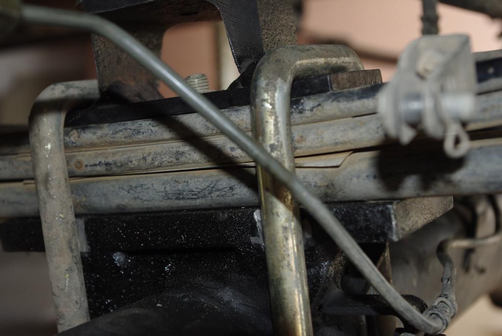

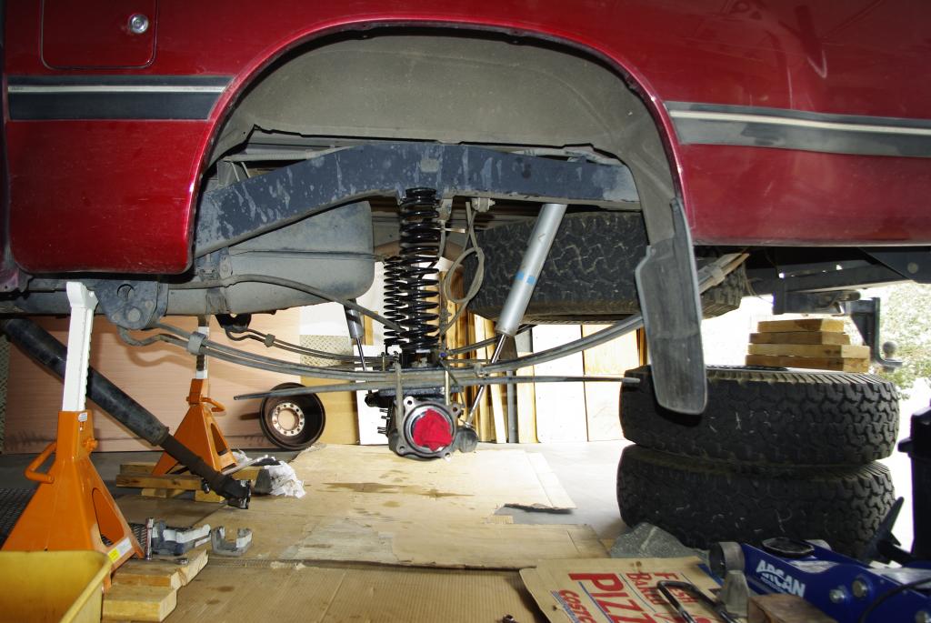

A friend down the road is doing the conventional zuk mod....the "cut the steel stopper to 3/4" length" method.
He's also adding in 456 gears and a TJM air locker in this 1998 T100. It should be on wheels tomorrow.
