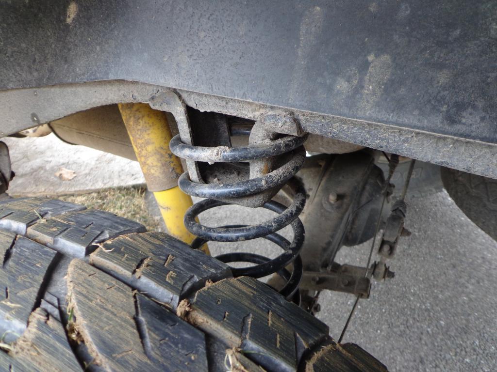

Pastor.... Here's some info the wheel well with a zuk..... mine. ..

Looks like they stuff up in there just fine... Your thread Chef was what inspired me to research this option. I have yet to really flex mine but it seems that it works excellent. Thanks for the pics! Nice 4Runner. Love the work you've done.

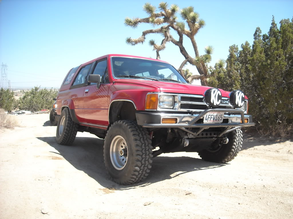

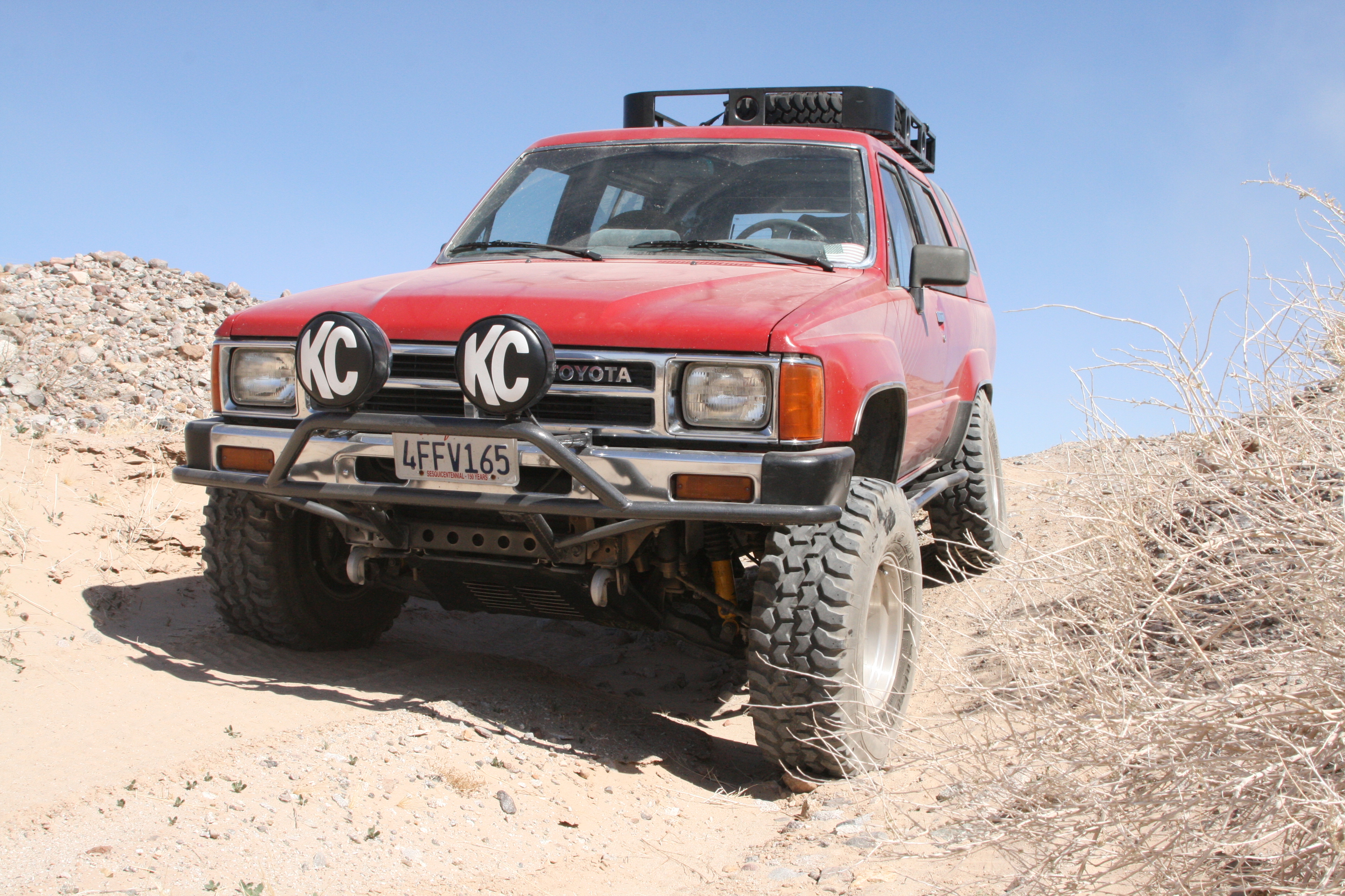

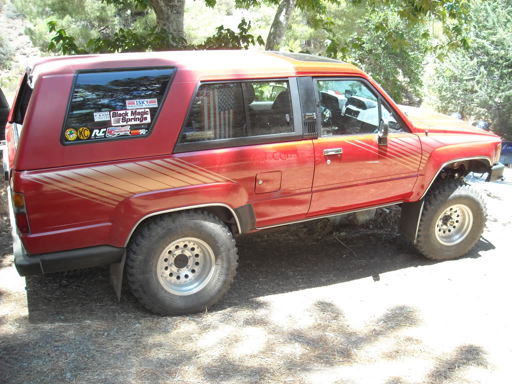

PICS:
couldn't get the tire off the ground because it was slipping too much. but that's a pretty far reach in itself. But, as you can see, there is quite a bit yet to go before that spring could come off. No worries here.

Hey Terry, wut tires r those? Size? I have a nearly new one, stock size, if the son needs it? I'll roll it down the 10 tonight, ......... should be there by April! Hehe. No, but maybe Jason could grab it?
Old Mar 7, 2013 | 12:12 PM
  #80
92 TOY's Avatar
YotaTech Milestone-Two Millionth Post
Joined: Jan 2009
Posts: 12,009
Likes: 122
From: Northeast Pennsylvania
what size are what? the tires? 31-10.5-15's
