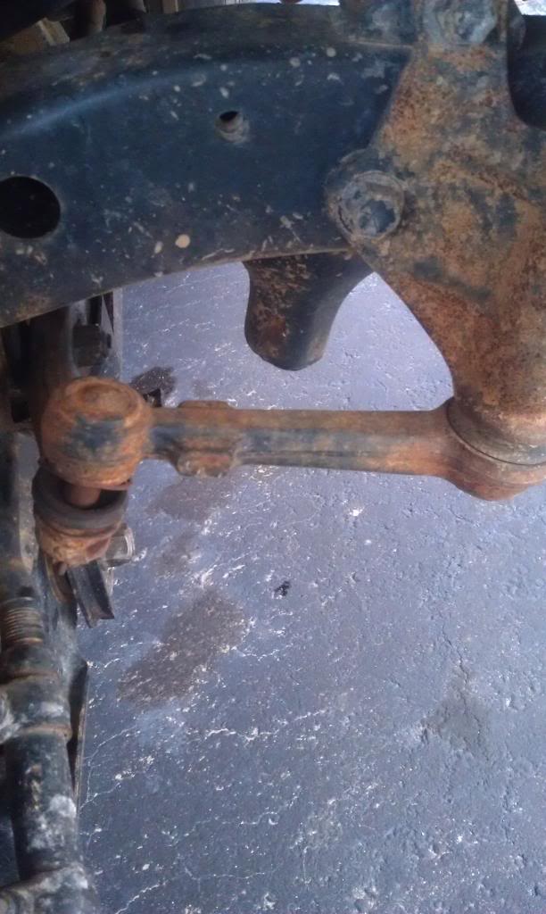

How do I go about fixing this? I can move it up and down..

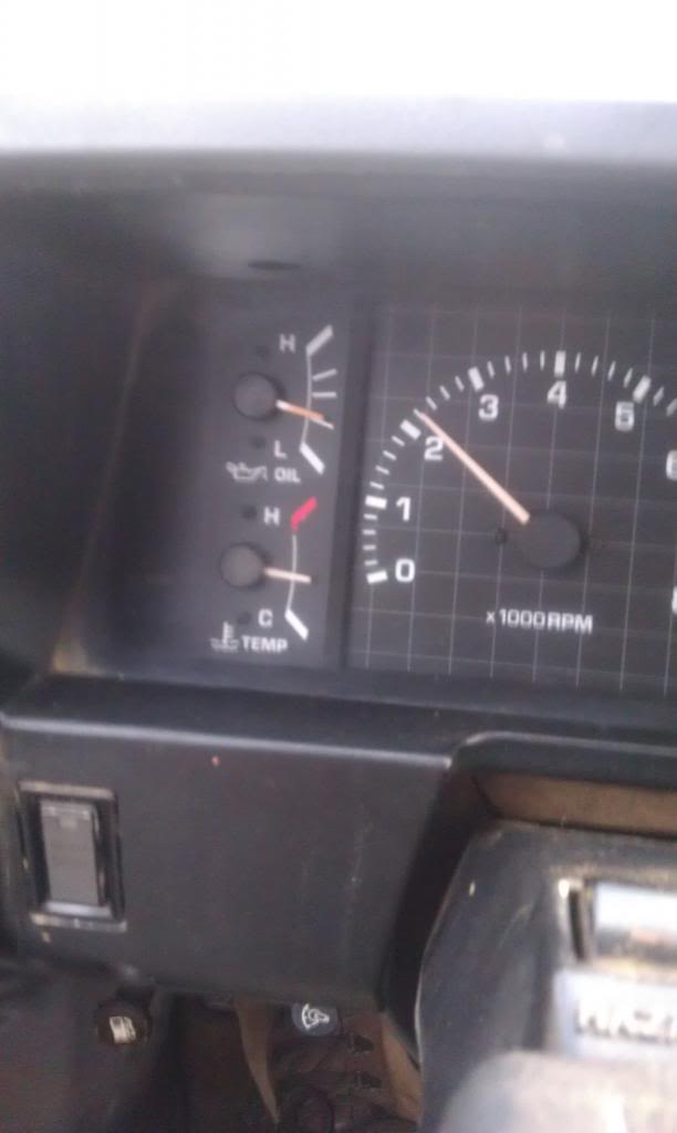

This is my oil pressure reading while at speed and under load....looks low? Fresh oil change and is full

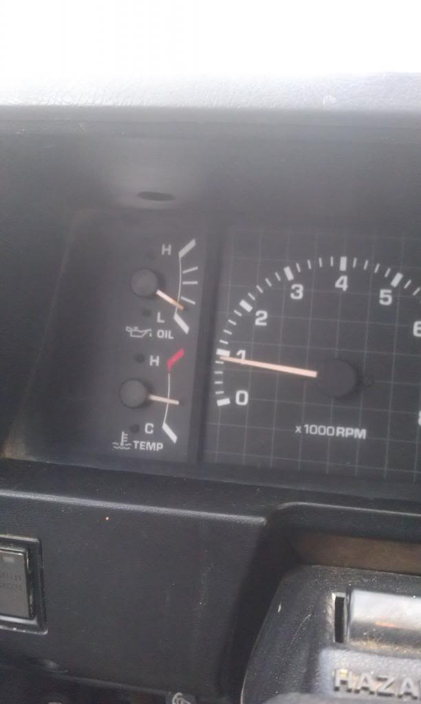

Oil pressure at idle....

Your first concern is a loose or used up tie-rod end. $20 at rockauto.
Im not sure how much stock I put in that oil pressure gauge. It looks low and may be. However, I would install a wet gauge.

thanks....now that I look at it closer, it is just a simple tie rod end
maybe someone can confirm that their oil pressure gauge reading is similar. There are no odd noises, and it is full of fresh oil.

My 86 4Runners oil pressure at speed but not under any load is just a smidgen under half mark, at idle is is just a smidgen over the 1/4 mark.
What I would do is get a mechanical gauge (cheap or used) and tap it into the block. Believe their is a place at the motor mount in the passenger side to get a reading.

That's not a tie rod end, that's your idler arm. If it's worn out and sloppy you'll have to replace the entire thing, about $50 for a stronger than stock one from autozone. Part number FA5040. In the picture it looks like the nut holding it to the steering linkage has backed off and the stud is almost completely out, like someone left the cotter pin off the nut. As far as the gauges, all of them are HOPELESSLY inaccurate in these trucks. Notice they didn't even bother to put numbers on them. For what it's worth though, my freshly machined, personally built 22re has 10K miles on it and my oil gauge reads just the same as yours, if not a bit lower.

I looked at it some this afternoon....it looks like the tie rod end is loose (either worm out or the nut has backed off) I'll get to that. The idler arm seems to be tight, I've looked into the rebuild of it with the new bushings.
Thanks for the info on the oil pressure...i'll keep an eye on it.

I would suggest just doing a complete steering rebuild. The Idler Arms tend to get worn out as well, but it may have been replaced fairly recently, that is connected to the tie rod that you are showing. As far as bolts, I dont know the size right off. I get mine out of the bone yard and grab as many nuts and bolts as I can. From 79-94, I think all of the skid plate bolts were the same.
Oil pressure guages on these trucks are not the best. For the way I drive, part store shocks were great for me. Your driving plans will determine what you should get. Looking forward to seeing your build.

Checked the idler arm, everything is tight and the nut is on tight and the cotter pin is there, but the rod end boot is torn (gone) and is allowing the arm attached to it to move around. The part # at Autozone is FA1739, so I'll go that route. I don't plan on beating on it.

got the idler arm and fuel damper done.....hope all the rest of the fixes are that easy
