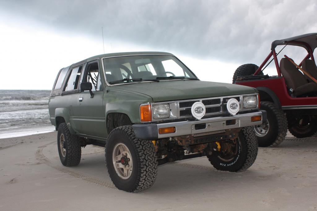

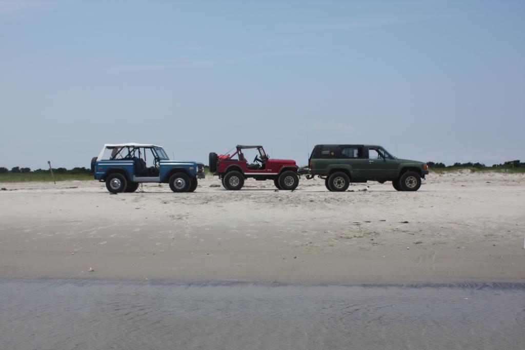

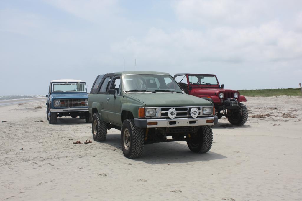

recent trip to Portsmouth Island...
my 4runner, 74 bronco, and 78 CJ7
