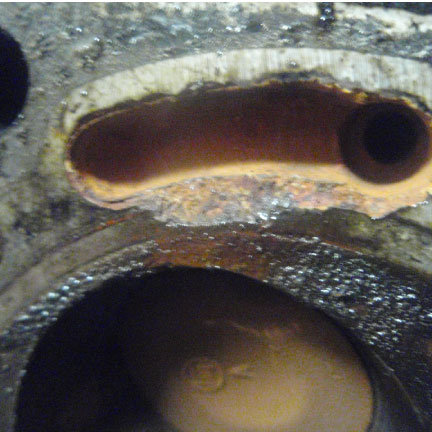

I have an 88 runner, water in oil, I yanked the head and found the gasket seperated exactly where I circled on the picture. Also the head looks to be pretty damaged, pitted, corroded right where the gasket sits.
my question is- Is this repairable? the #3 and #2 cylinders are showing the same thing, just not yet as bad.
Or should I search for a new or prefferably used head, as money is tight.
Attached Thumbnails Needs a new head? ( see pic )-22rehead.jpg   Needs a new head? ( see pic )-22rehead2.jpg

hard to tell, but I would say that is repairable by having the head face milled at a machine shop.

From the picture it's hard to tell. I would clean it up real good and post another pic to know for sure.
A good machinest could true it up for you if the head turned out to be ok.
I wouldn't cast it off as a gonner quite yet.

I will clean it up and take a better picture. My concern was that the corrosion is pretty deep. And if the cost of repairs outweighs the cost of a used head, than whats the point.

Personally I wouldn't get a used head and just slap it on, I would have it milled anyway.

Picture update on top post.

Well, I think it's time you start looking for a new head.
x2, unless you can find a machine shop that can fill that in, which is probably possible.
$348.00 from engnbldr, complete head drop it on and go. http://www.engnbldr.com/head_shop.htm
