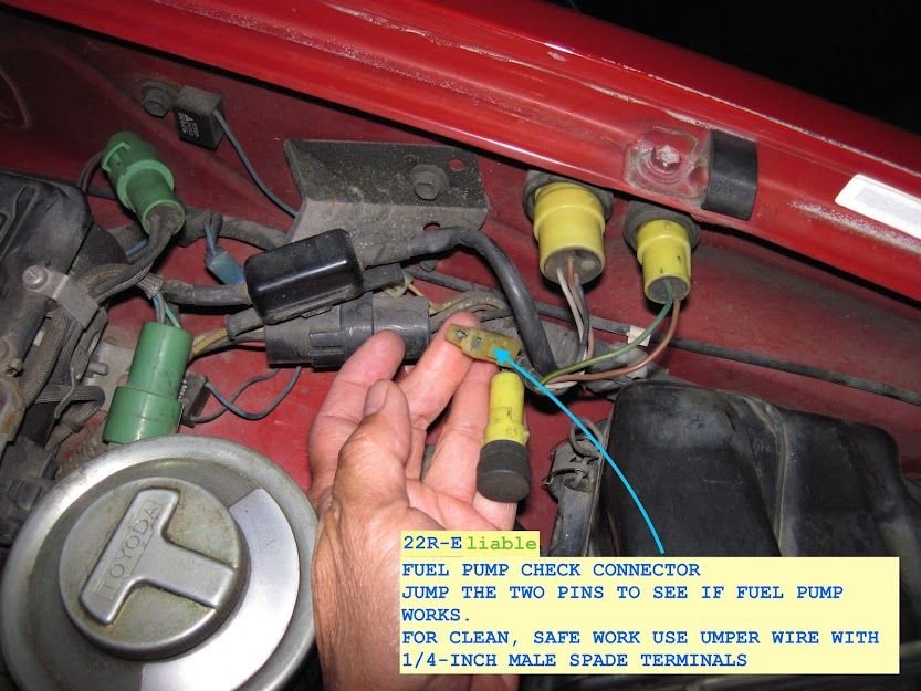

You tried running with the FP test connector jumped? Heard/Felt fuel pump work?
"SEE" if fuel pump works?

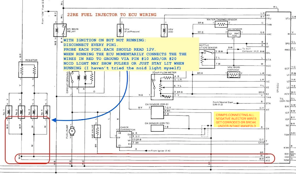

The following is hard to test and is better "seen/felt" (inspected): Crimps connecting ALL between injector negatives, AND ECU pin 10 AND ECU pin 20. Corroded? Broken? This was the problem when I saw same symptoms as yours after HG replacement.

I tried two methods that I had seen on the interwebs:
1. I used a jumper (paper clip) in the rectangular test fuel pump test connector by the driver's side fender under the hood. No joy.
2. I removed the COR and jumpered between the B and Fp locations (with the plug's clip facing downward, the bottom middle and bottom right positions).
I tried these methods in tandem and separately, neither made the fuel pump run. I now have a clear fuel filter spliced in place where I had to cut the frozen flared fitting out for the fuel pump output off the top of the tank. So when the pump is running there is also visual evidence now, when the access hatch is open, which it is.
