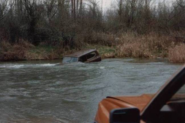

This followed me through a water crossing and it was entirely too deep for him - pic attached. Amazingly difficult to winch him back against that current. He did a quick plug pull & crank and oil change and fired it up and he drove it home. Not everyone is so lucky.
