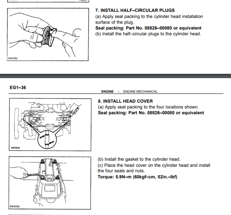

I used the Felpro VS50358R kit. Comes with the gasket, 2 half-moons & 4 grommets. Don't over-tighten the cover when reinstalling & make sure you use a little RTV on the half-moons in the 3 places as shown below, note the torque for the cover as well:

The last valve cover gasket kit I bought was from Advanced Auto Parts. I THINK (although rarely ) it was FelPro, but I'm probably wrong. Anywho, it was a whopping $17.00. Had the gasket, both half-moons, and the 4 hold down nut grommets. Just remember to use the squeeze tube gasketing materiel where the FSM says to. I am pretty sure it just takes a bit at the corners of the half-moons, and a thin film around the mating surface of each half-moon. The circular portion, not the flat part.
A little trick I learned when putting the valve cover back on with a new gasket: First and foremost, put the gasket on the right way. There is a thin part and a fat part of the valve cover gasket. The THIN part goes into slot in the vale cover, the FAT part is what sits on the flat mating surface of head. This is IMPORTANT, or it won't seal, and there will be oil leaks all around the valve cover. The hold down grommets won't fit, either. At all. The grommets are a LITTLE bit too thick when they're first installed, with the gasket right way up, but you just have to push down on the valve cover a bit to got the nuts started. If you put the gasket in upside down, IE: the fat part in the cover's slot, it won't matter how much you push, the grommets won't permit you to get the acorn nuts started at all. It's a good indication you put the gasket on upside down.
Second, to get the gasket to stay on when trying to get the cover back in place, try putting a SMALL dab of a very thick grease of some sort at the corners, and a few other places around the gasket, in the slot in the valve cover. It holds the gasket in place while upside down, lowering the valve cover into place over the head. I take a toothpick, and whatever I can scoop up with the fat end of it is how much I use. Small little dabs of grease. Just enough to keep it in place, mostly, when I flip the valve cover over to lower it into place on the head. It's saved me a LOT of frustration, trying to hold the gasket in AND maneuver the valve cover to where I can get it into place correctly.
