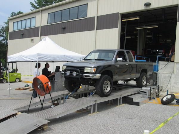

had a decent turnout for dyno day. Hot and humid, and had some computer overheating problems, but we were able to complete pulls for about a dozen vehicles.
first vehicle on the dyno.
might be running the event again in October!

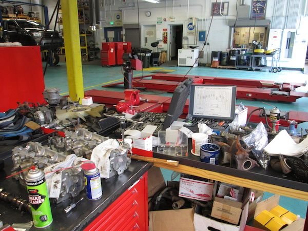

Going to order the remaining shims for the lifters today- might be in for pickup in a few days. (hopefully). I checked the valve clearances before taking the heads apart. the intake valves were still within spec, but the exhaust clearances were a bit tight. After reading on Yotatech regarding valve lash, I'm adjusting the intake valves to about the middle of the cold spec (~ 0.009") and the exhaust valves to be on the slight loose side (0.012"). Will check again when the engine is hot, as repair manual recommends.
*intake cold spec: 0.18-0.28mm (0.007-0.011")
*exhaust cold spec: 0.22-0.32mm (0.009-0.013")
I'll have open shop time on Friday, so as long as I'm done with all my school labs, I'll hopefully be able to make some progress. I'll of course share pictures as I go.

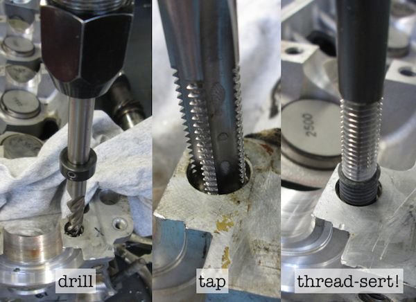

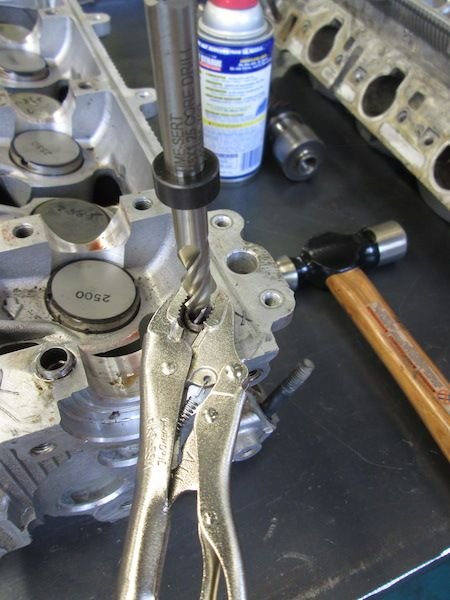

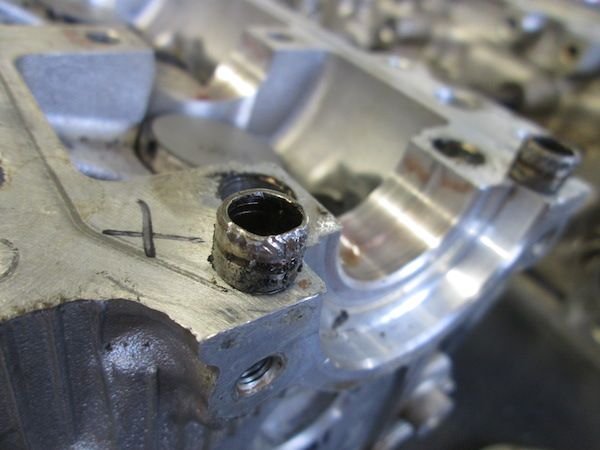

I know, FINALLY, some work!
big happy mess!
there were 3 stripped out holes I needed to repair. Of course they were the ones with the dowel pins...trying to remove them
all chewed up
thread-sert (instead of heli-coil)
also had to clean up one of the spark plug holes

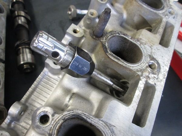

almost forgot to knock the freeze plugs back in. This tool ensured equal/correct depth.
head gaskets going on...

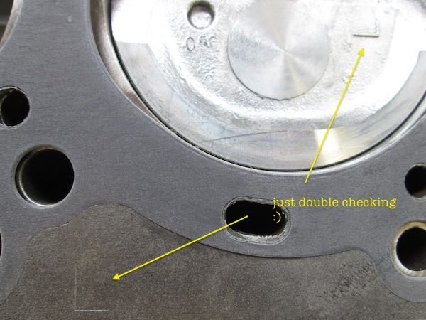

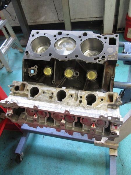

on to the R side

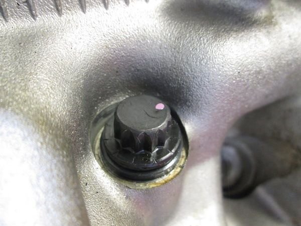

I only use my pink nail polish for marking my tools... and now marking the bolts for the 90-degree + 90-degree torque Should have eaten lunch before doing the second 90-degree torque. yay for breaker bar
yay! heads are on!

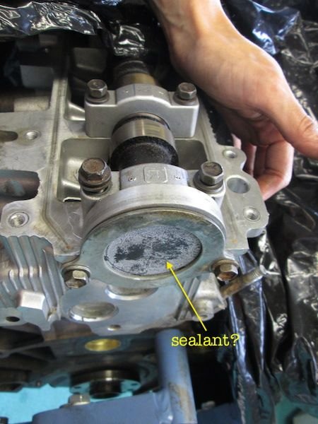

repair manual didn't suggest putting any sealant around this camshaft rear plate/cup thing housing plug.. I vaguely remember our putting FIPG around the small half-moon plugs on the last valve cover job we did at work. Does anyone do it? I guess it wouldn't hurt, right?
**06-29-2016 edit- you SHOULD throw a thin layer of FIPG around those camshaft covers before installing.. and put some at the 90degree junctions before installing the valve covers. About 1000 miles down the road from the rebuild, I started seeping oil out of the caps... I guess the truck couldn't stand not having any corrosion preventative all over its back side. :/

repair manual didn't suggest putting any sealant around this camshaft rear plate/cup thing housing plug.. .... Does anyone do it? I guess it wouldn't hurt, right?
I don't do it, and I wouldn't do it. I don't hold the opinion that I know more than the engineers who wrote the FSM.

You should not need any sealant around the cam plugs.

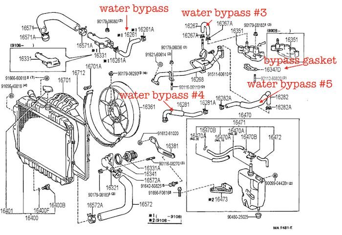

I think I'm going to take my radiator to a nearby shop and have them clean it up/out while it's out of the truck too. why not, right?
In regards to cooling, I would also recommend that you put a good hose on the heater bypass which is behind the engine as once the engine is in the truck its a pain just to see it.
Old Jul 23, 2015 | 04:31 AM
  #138
LolaL's Avatar
Joined: Apr 2014
Posts: 109
From: Baltimore, MD (!)
one of these hoses? or were you referring to something else? I ordered a lot of these a while ago, so I'll find out what I do/don't have once they start being installed.
Old Jul 23, 2015 | 06:44 AM
  #139
Janos01's Avatar
Joined: Jul 2014
Posts: 360
From: Dallas, TX
Water bypass #3 should be the one. Its right behind the engine.
