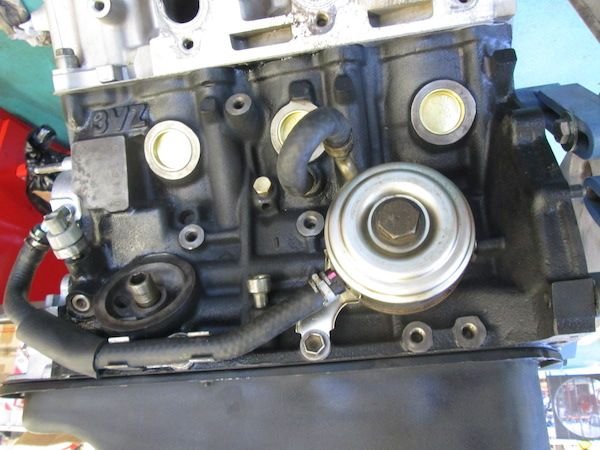

replaced the oil cooler hoses (and gaskets)
back in place! so purdy
the one hose I forgot to pick up because it wasn't in the same diagram.

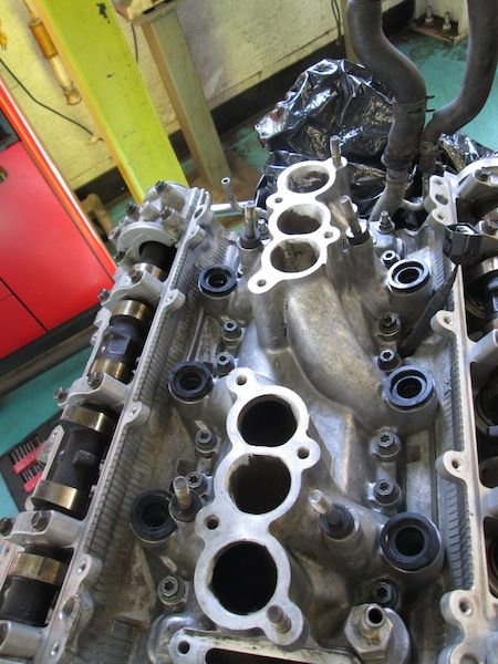

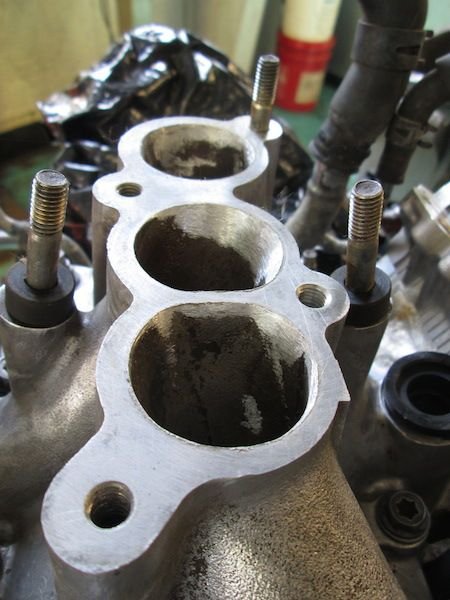

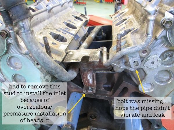

some scale build-up in the inlet pipes. Ran water through and didn't discover any full clogs.
should have installed inlet BEFORE the heads (oops). This worked though.

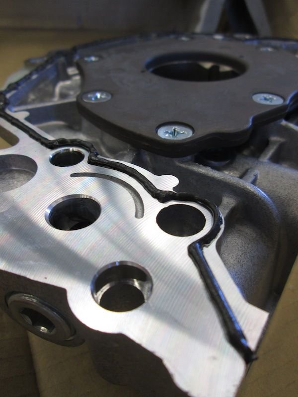

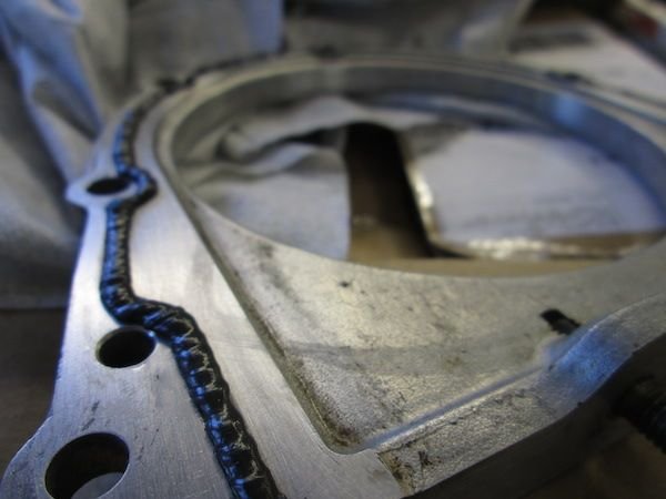

today was gasket day! rear main cover
oil pump with sealant
dowel pins that stayed with the old oil pump that needed to be transferred over

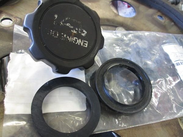

even the oil cap got a new gasket
yeah, oops.

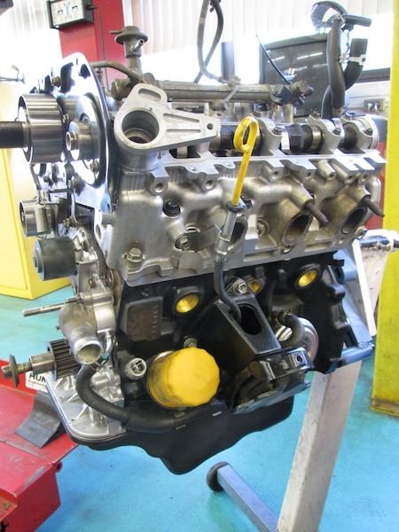

top end so shiny!
as of the end of the day.

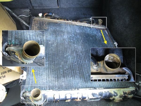

not sure what the POs did to the radiator.

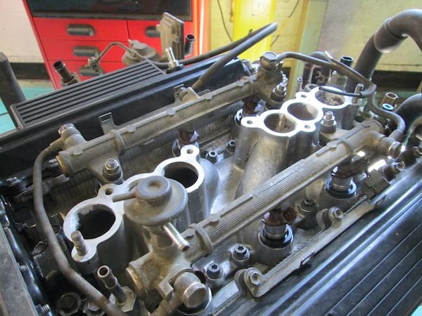

just need to pick up fuel rail crush washers and then finish up with the injectors, rails, timing, brackets, and accessories.

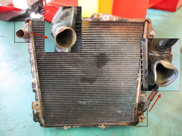

I would not use that radiator man, looks way too far gone. You can get a decent replacement from OReilly's for $150.
really? How can you tell/what's the visual criteria?
I haven't had any overheating issues and there aren't leaks (only coolant leak was head gasket starting to go)... I'm guessing there's just some scale build up inside if anything. I'll know when I pick it up on Tuesday (dropped it off for service Saturday).
there aren't any O'reilly's out here either ... but there are other sources, of course!
If the openings on the radiator look like this:
You might want to replace the radiator!

I was just wondering how to tell a good radiator from a bad one (if not based on performance). I didn't know if there was something horrible I was missing because I haven't seen enough to really know. I appreciate all input- that's why I'm on the forum in the first place!
Originally Posted by mct75
If the openings on the radiator look like thisE. Munch painting) You might want to replace the radiator!
hahahaa, aw... the radiator guy didn't bat an eye. I was going to try straightening it out but decided he's seen a million radiators and knows how to fix things better than I can.

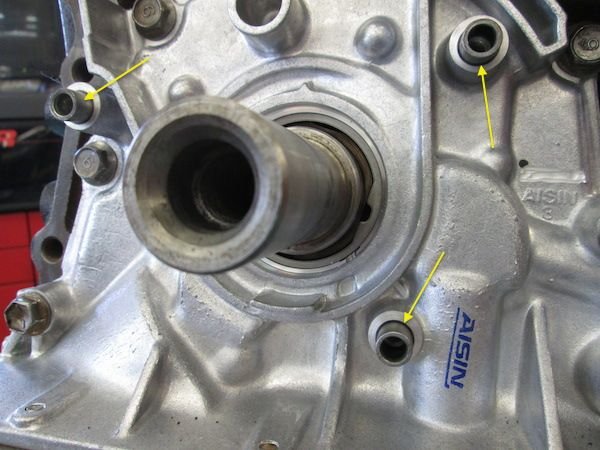

timing belt didn't come with marks (Aisin timing belt component kit), but one of my instructors came out and gave me tips and a hand. Turned the crank 2 revolutions after everything was in, and the timing marks were still spot on! See you in another 60-70k miles, right?

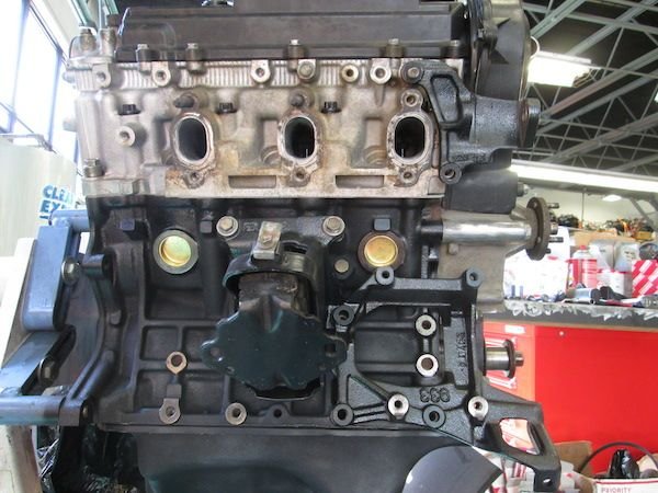

then I stared at this side of the block...

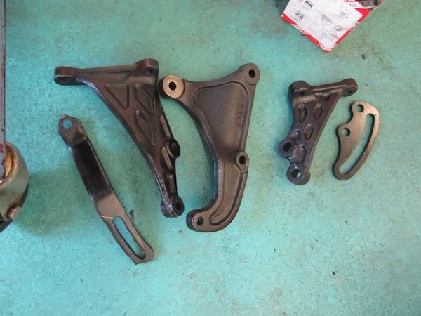

and stared at these brackets and wondered why I didn't take as many pictures as I thought I had during dismantling. The game is more one of where the right length bolts went...
still waiting on 3 fuel rail gaskets. Then the injectors and rail will go on, then the accessories... and exhaust! I'm sooooo ready to drive the truck again (and work on the sentra next, haha!)
How goes things with the radiator? Was it able to be saved?
I believe so! They cleaned the outside, flushed the inside, straightened out the necks (see picture in previous post), pressure tested. I should be good to go for a while, hopefully!

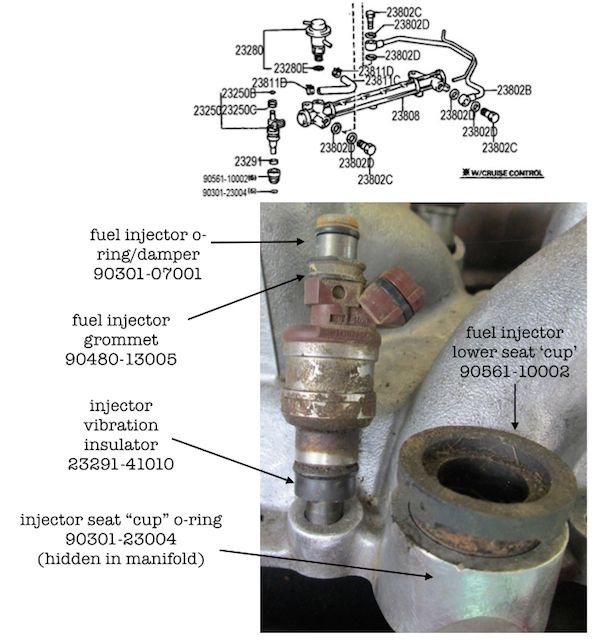

I picked up a "rebuild" kit for my injectors that included all the pintle caps (not on the parts diagram) and seals (except for the seat cup ones), but if you want the toyota numbers, here they are...photo was taken when the engine was filthy and coming apart
used the brass hammer to lightly tap the new filters in; used a rubber mallet and some silicone spray to tap the pintle caps on (rested the injector against a block of wood on the other side while tapping).
here they go!
and hopefully won't be seeing them anytime soon either!

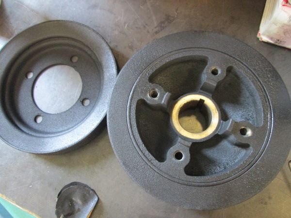

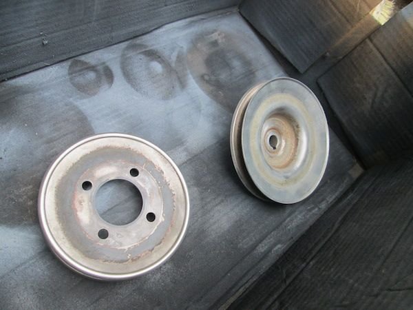

"found" some more filthy pulleys in a box today. Felt guilty for neglecting them, so they got cleaned and painted.
and then played this game (I'm not winning yet)...to be continued tomorrow.
