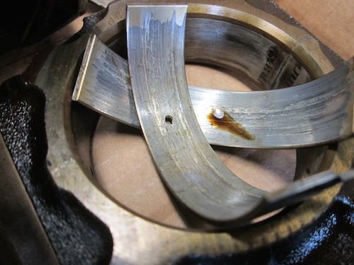

Here's a few pictures from today. Didn't do a whole lot except clean and some wire wheel. Ordered a 'mark 2' connecting rod bearing to test fit all the rods before I put in my order with ENGNBLDR.
rod bearings- hadn't spun yet, but they didn't have any crush.
main bearings

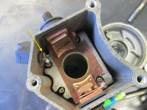

took apart my starter. The wire had come loose and wouldn't even bench test. I wonder how it was able to start up every time eee. Resoldered and cleaned off the pitted contacts. works again yay!
ready to go back in eventually.
