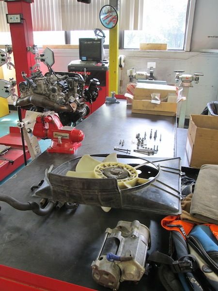

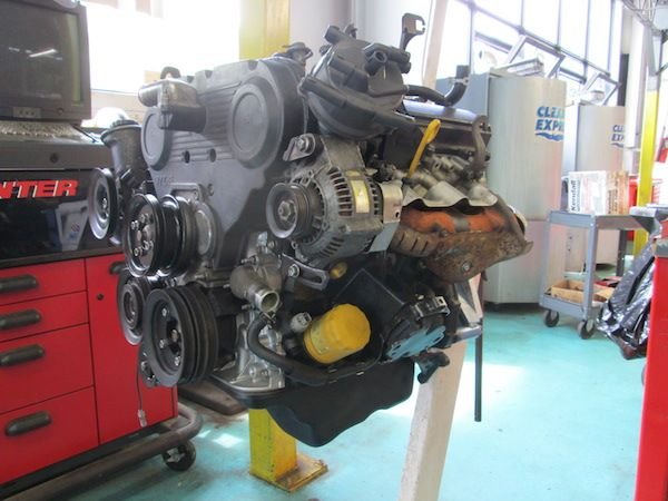

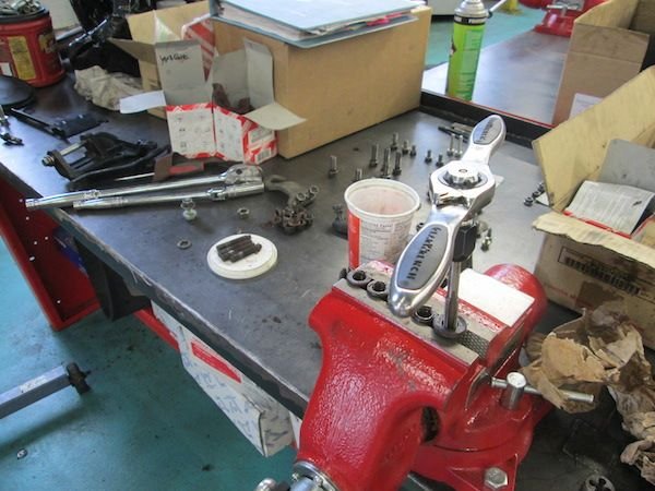

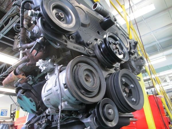

couple of hours in the shop this morning...
spent part of it chasing threads on exhaust studs and nuts
all but the AC pulley are looking new with fresh paint
even the distributor made it on (with new cap and rotor and wires)!
and the workbench is looking almost empty!

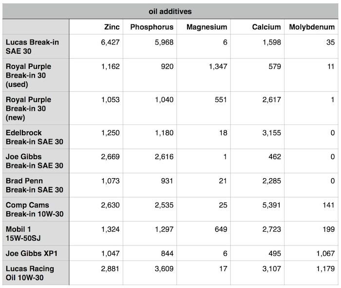

In other news, I was reading about different break-in oil formulations and actually found someone who had taken a number of different brands component/formulation tested.
source:
http://www.hotrod.com/how-to/engine/...reak-in-guide/
and in case they ever take that website down
(numbers are in ppm)

If Joe Gibbs or Lucas Break-in oils aren't readily available or I'm working on a budget, I'll use conventional Valvoline oil with a good zinc break-in additive and have never had a problem in dozens of rebuilds. The key is the zinc (ZDDP) combining with the phosphorus in order to harden and protect metal surfaces. Just running straight oil during break-in can hinder proper break-in and significantly reduce engine life.
I've heard some people continue using zinc/phosphorus additives on older flat lifter engines to help prolong the life of the engines (but shorten the life of the cats, if they're present)... I found the Lucas break-in when I picked up oil the other day, so that's what's going in!

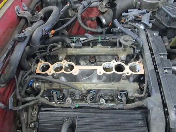

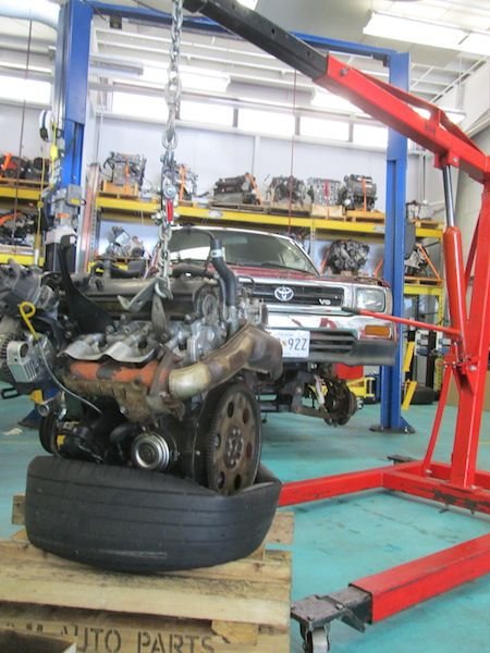

engine's in! Should be able to finish buttoning up the rest tomorrow-
to do
-plenum and intake hoses
-remaining water hoses
-fuel main supply line and cold air inject line
-belts (I noticed I stuck one of the pulleys on the fan backwards so it doesn't line up) >_<
-radiator & coolant
-vacuum hoses
-charge AC
-top off PS fluid
-I'm sure I'm forgetting something...

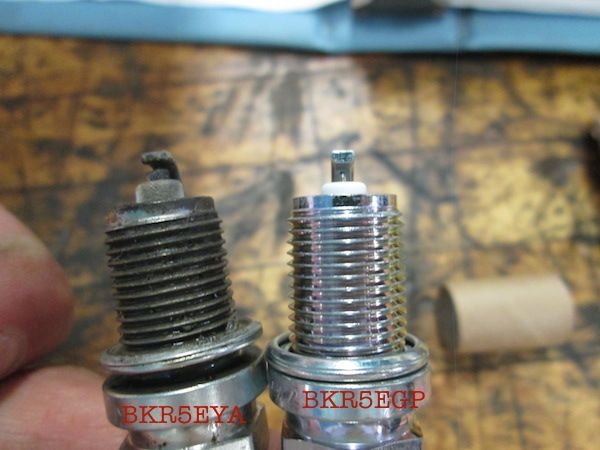

hands were filthy so didn't take too many pictures, but here's two
when I picked up spark plugs, the store said the one on the right (BKR5EGP) had superseded the ones that I had in there (also repair manual recommended BKR5EYA). 5EGP had greater gap clearance (~0.038" vs. recommended 0.031"), so adjusted and threw them in. Guess I'll see how they perform.
Last edited by LolaL; Aug 14, 2015 at 05:13 PM. Reason: because pictures and bad grammar

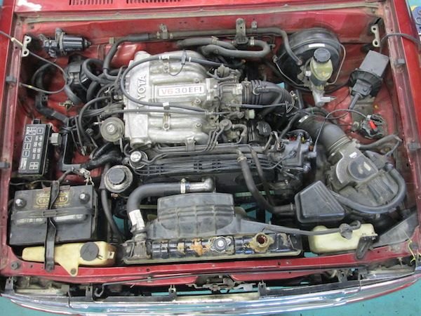

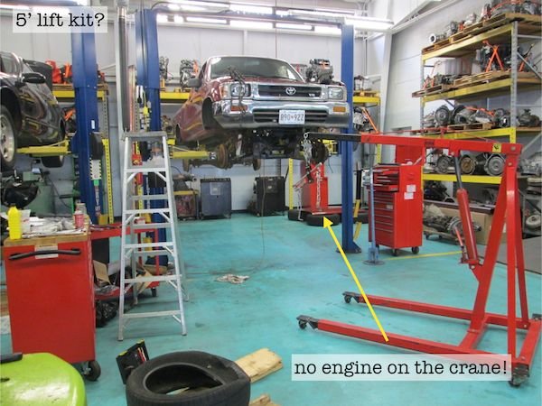

One of the instructors was teaching a course today from 8-4 today, so of course I had to go in!
plenum, I hope I don't see you any time soon.
everything seems to be in place (except for cruise vacuum hose hanging out the driver side and the windshield fluid hose hanging out the passenger side.
yes, I needed the ladder for a lot of the work. I'm too short!

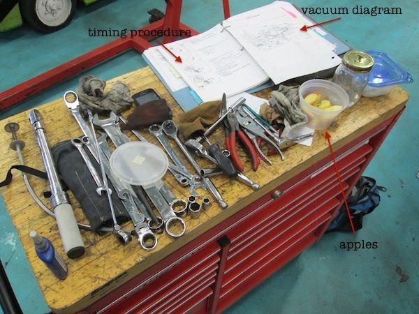

"my" tool cart
My to-do list I scribbled down last night. I was really hoping I hadn't forgotten anything. Everything but the AC got charged before I gave it a crank. Started up on the 3rd try! Adjusted timing ~10degrees (might advance it a hair more). Drove it around campus without the hood on. wheeee!
DROVE IT HOME!!! Have some coolant seeping out the water inlet, so I'm going to re-seal it tomorrow morning. Not sure if the bead was too thin or what. Everything else seems to be pretty good. Going to keep a close eye on all the fluids of course.
So excited and so tired at the same time. Thanks everyone for your input and help!
next: transmission overhaul, haha. No, seriously, but it won't be until our last semester, so stay tuned!
