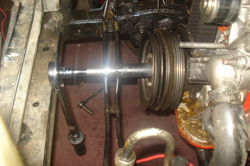

OK, done the same procedure today and finally got it loose, if you have the tool this is all you need, picture below, save you $100+ on tool.
Just as the picture shown, and make sure that you have it on the opening position then just by turning the key to start then immediately shut it back down, DO NOT START IT, so goodluck man.

Nice Trick with the starter for a Impact Gun hehe
Had a buddy helping me do my truck. When I took my clutch out I saw the damage it did to my ring gear.
But hey, ifn' yas want to ruin your flywheel, go for it.

If you use the starter method for breaking loose the crank pulley bolt,
Stand clear and don't watch!
I used to work with a fellow that had a 4" scar on the side of his head from when something broke when someone else cranked it while he was watching
He's lucky he did not lose an eye,
Or his life!

yeah I'll be working alone, won't be anyone around the engine when I'm breaking it loose. That's only if I can't do it with a breaker bar first which I hope I can. I'm also not too worried about chipping a tooth or two on my flywheel. My clutch is going to need to be replaced soon and I'm going with a marlin clutch and flywheel so it's coming out anyway. Thanks for the heads up
