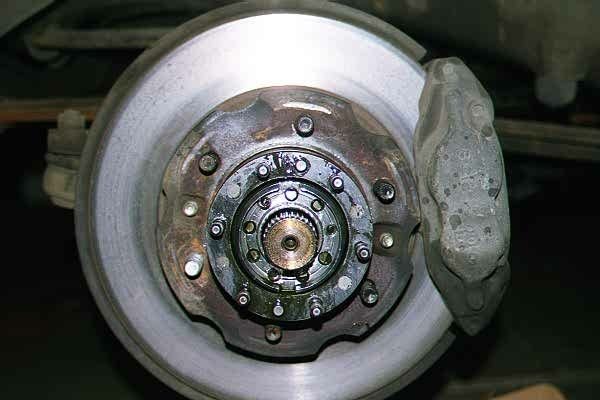

tember2, you need to post a picture of what you have. Your descriptions haven't quite painted a clear picture of what you're looking for.
For others viewing this thread, auto hubs are different than ADD. Auto hubs are an automatically engaging and disengaging hub. They do what turning the dial on a manual hubs does, but they do it automatically. This was found on first gen 4Runners and corresponding year Pickups. ADD is a system attached to the front differential which uncouples one front axle from the differential. ADD equipped vehicles have no hubs (auto or manual). They use a drive flange which permanently connects the wheel hub to the CV axle shaft. This was found on second gen 4Runners and corresponding year Pickups.
Now, auto hubs use different nuts on the spindle than the two standard 54mm hex nuts and star/lockwasher. Here's a picture from the FSM showing what's going on. You can see what I referred to as the fancy nuts.
And here's a picture from 4X4Wire which shows it after the auto hub body is removed.
