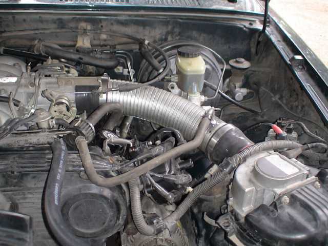

Mine ISR is 3" flex exhaust tubing ($13) w/ RPS 2.75" to 3" silicone connectors ($50 w/ shipping ) Not cheap but well worth the quality.
http://www.racepartsolutions.com/index.htm
I only welded a fitting for small hose near MAF (3/8" steel tube flared on one end pushed up thru hole drilled in pipe then welded). K&N filter off v.c., no smog check to worry about and then 5/8" hose + connector to airbox.
Then some black paint.
You sure can hear the MAF flutter at idle.
