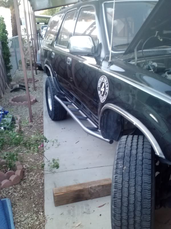

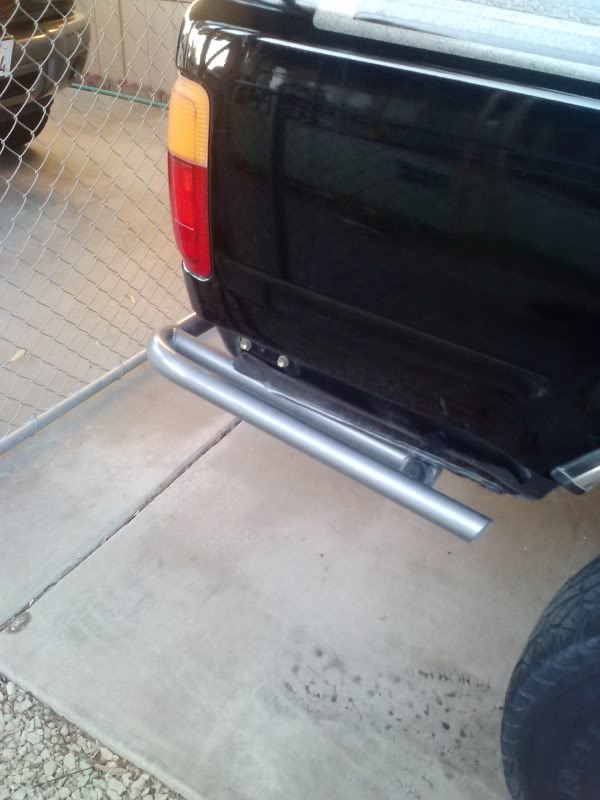

Sliders are on. Still need to nonslip the top.

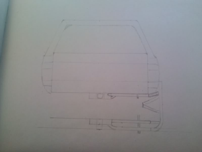

Im starting on the rear bumper. Still debating just using a reciever shackle or points off the frame. Im already pretty far out for future swingout and the benefits starting to not outway the departure angle for the tube bumper.
Any thoughts?

I like what you have going there with the sliders and the rear. You fabbed those? Specs? Can I steal the design?

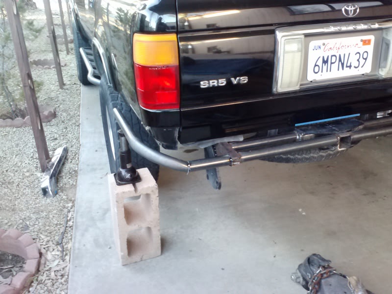

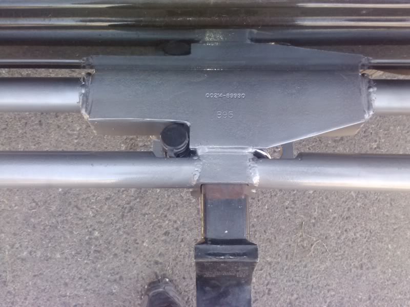

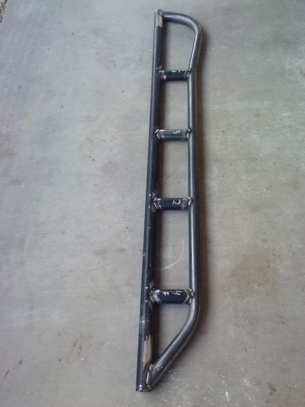

Its all from 1 1/4 pipe bent with hf pipe bender. I used some scrap ex tube to keep the rollers from dinging the pipe. I can get full 90s with it. Sliders have 4 legs each with 3x4 1/4 in scab plates. Rear bumpets has the center of the stock hitch and uses the 3/8s drop plates for it as well. If you want a diffrent shot or measurments let me know. Alot of this was scraps i picked up. Steal away. I did

Thanks. Ive been wanting to do these for a while. Finally got my 220 for the welder and the rust is thick on my fab skills but there functional. Btw mobile home parks suck. I hate the 7 pm quitin time.....

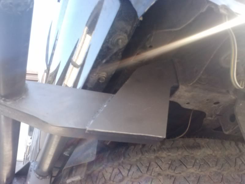

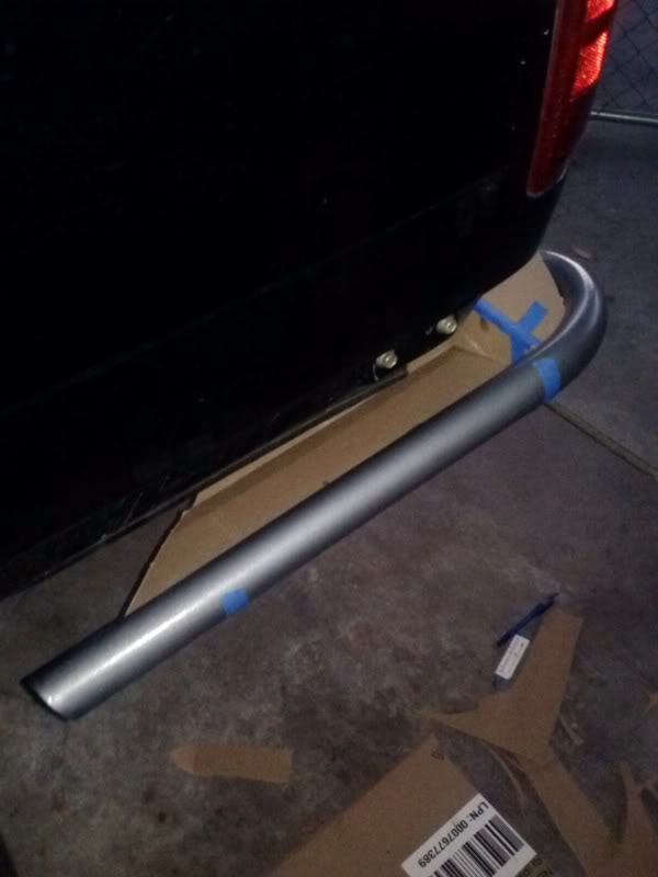

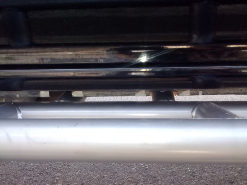

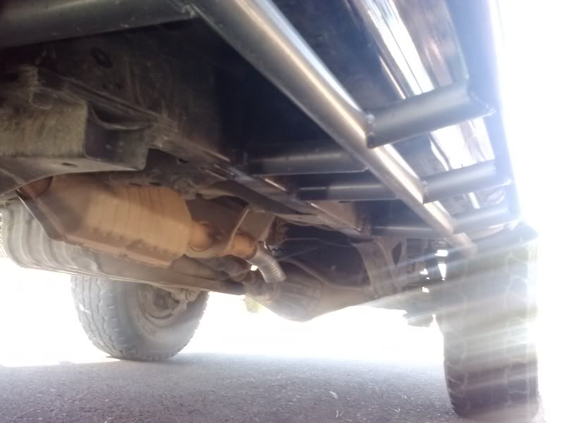

Sliders are 63" probly could be 61" for more trim room. I put 4 1/4 between the tubes. Angled them up 1 1/5 in. I tucked mine really tight so had to knotch the pinch seem. On the bumper its pretty much built of the truck. Its a tight fit sliding it on. Still trying to figure out a brace for the wings. Wing are 1 1/2" at the corner. If you use a new receiver you can get things to work without the notches. Used a chop saw for all knotches grinder for cleanup. Still need to face off the main supports.

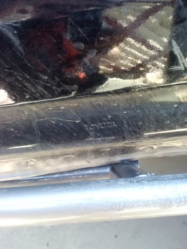

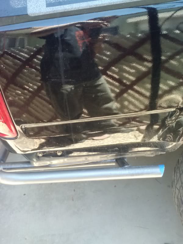

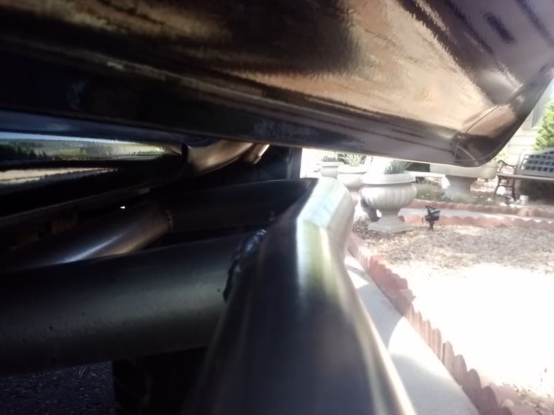

As you can see i ditched the plate idea.now for my fubar. I copied the angle on the wings for the support tube. On the right side i must have messed up becouse its gonna rub, were the left side has enough room to flex.

I started to roll the flange back but its not gonna work to well. Any suggestions? If i had a ground anchor i would try to winch the wing down.. ..innexperience bites me again.

After welding up the driverside i came up with solution without cutting. I set my floorjack under the frame and ran some rachet straps through the crossbar of said jack. Then i just jacked away. Took all my jack had but imanaged to tweak the tube down enough i wont hear any body noise.
