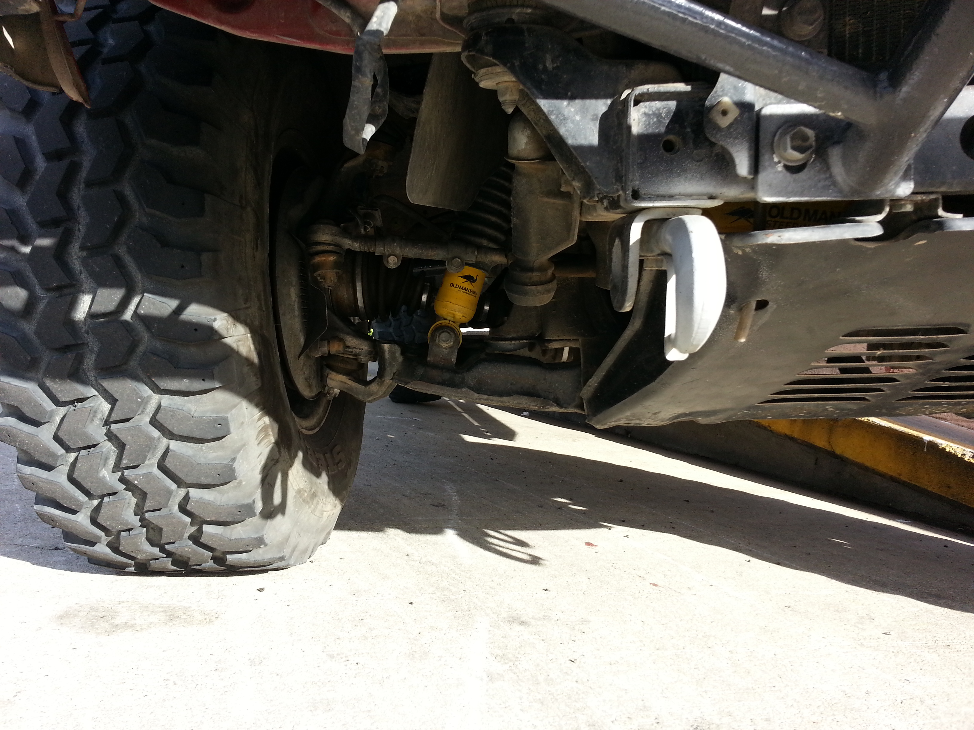

Gonna test more, but so far, the OMEmu CS009R springs feel really nice. ...

Wow Chef, I don't think I've seen one flex that far

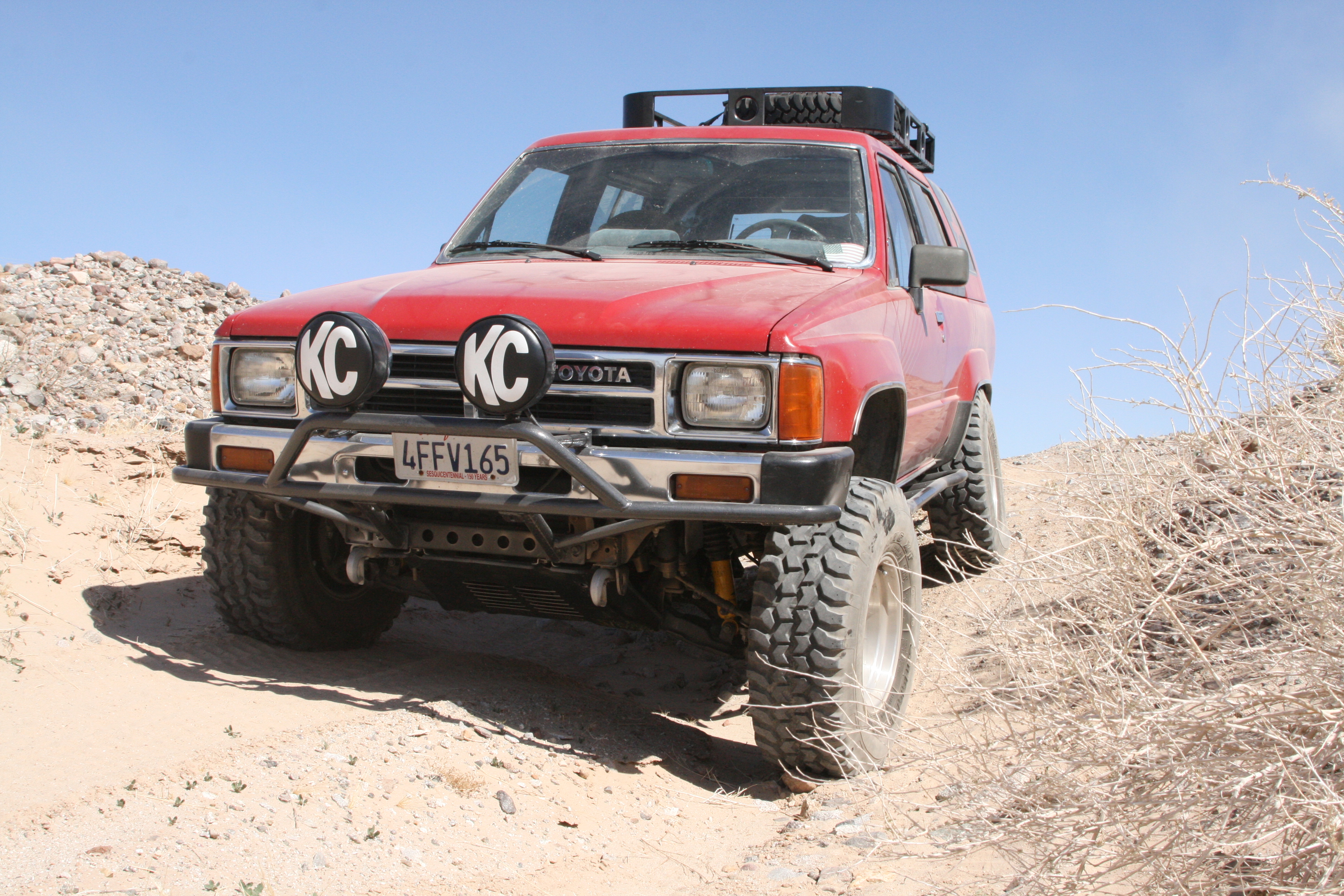

I need to do more testing with pushing it to its limits in the rear alone, front alone, then alternating articulation, like below...
I also need to check the links of those Ranchos at whatever max droop and stuff I can manage back there, and then I will know with a little more detail what I should do. It seems to me that with the extra ability 2 stuff and droop in the rear it will allow the front to stuff further without getting the rear tires off the ground. a stock leaf can only droop so much before it hits its limit due to the shackle . Adding that little extra arch can make quite a bit of difference if it setup right, but I'm not sure just yet what I'm looking at, because again, without longer shackles I am limited, plain and simple . Unfortunately, if I go too much higher I'm going to lose the ability to leave my roof rack on what I want as I will ripbthe garage door off, otherwise, hahaha .
The low pro Energy Suspension bump stops have definitely allowed me to go quite a bit beyond horizontal. But, a- arm suspension can only go so far as well. I'm pretty sure the Mega travel upper ball joints are helping as well.

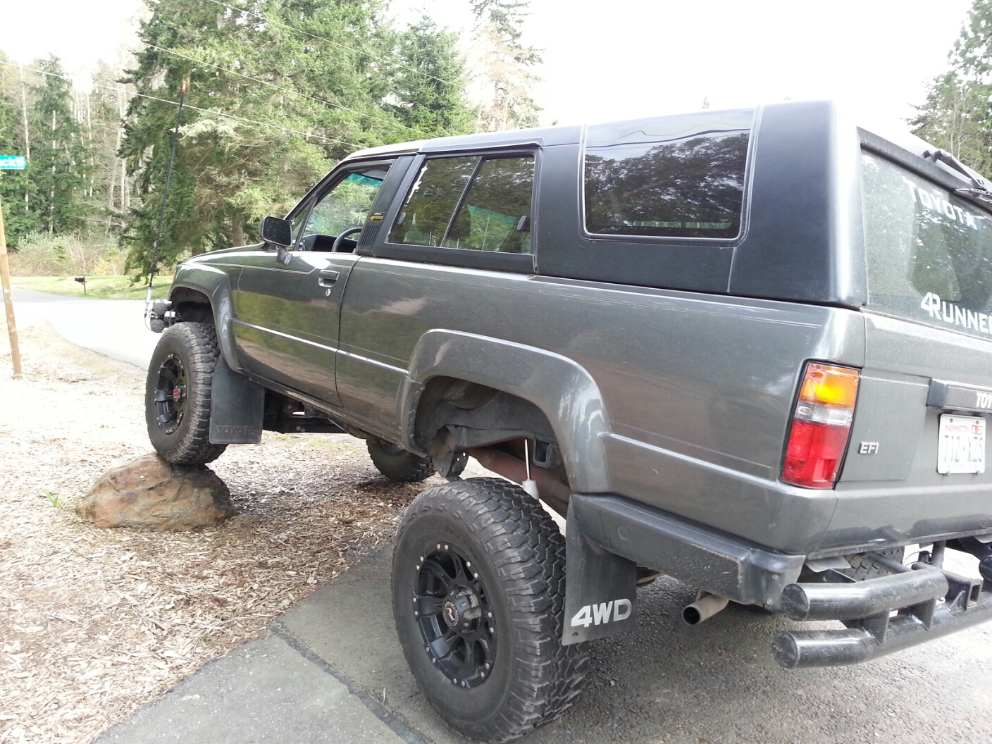

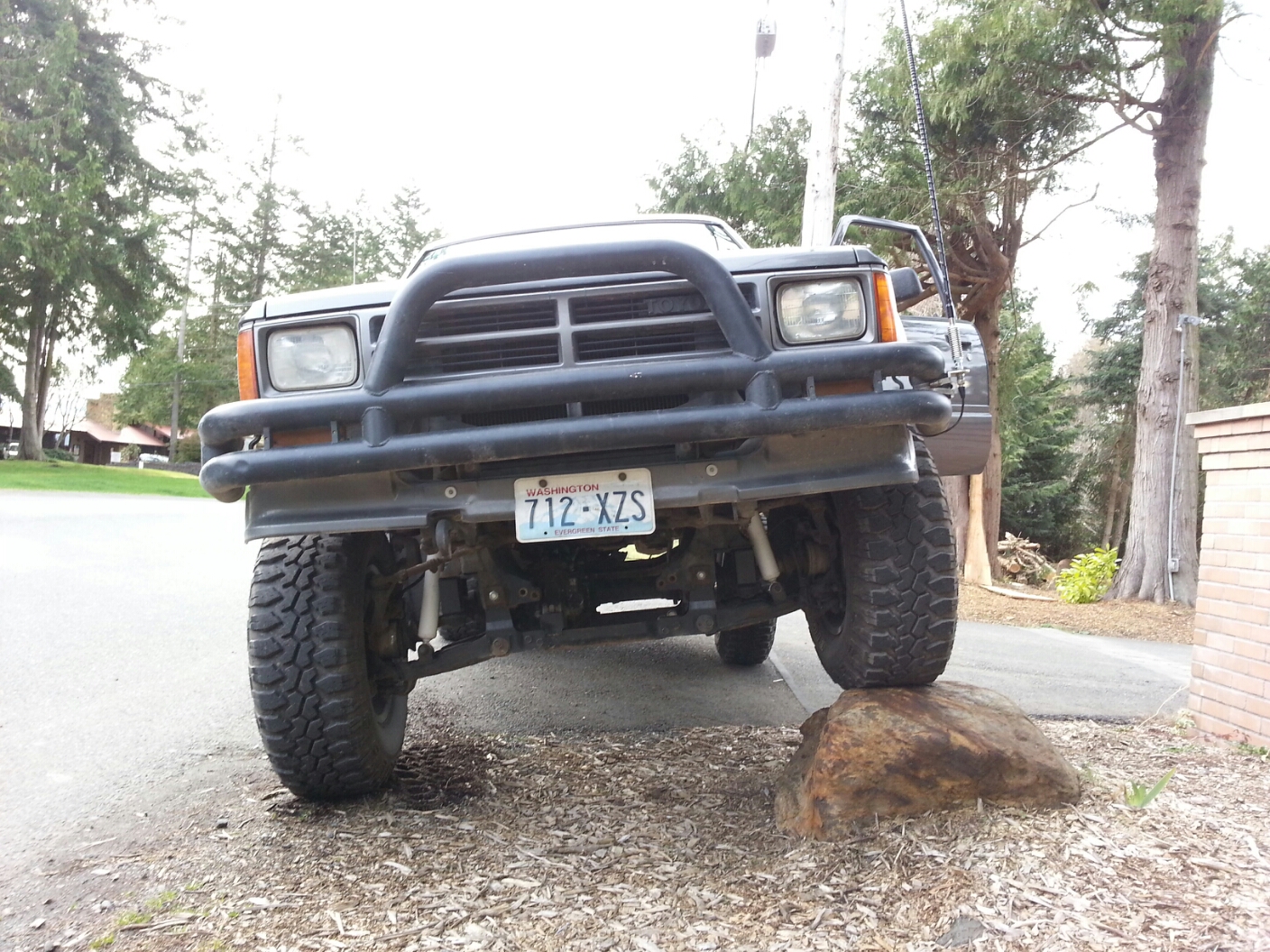

well heres my Crazy ifs articulation!

Nice truck! Looks a lot like 2 others I know on here.
