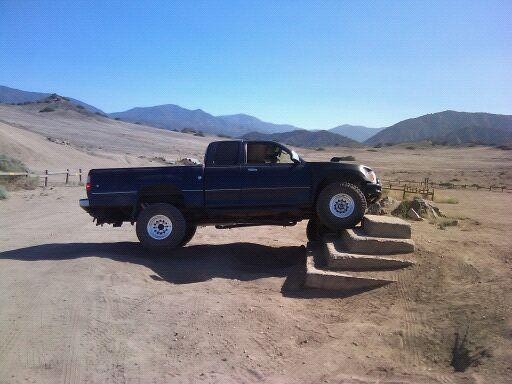

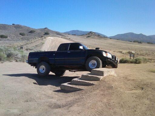

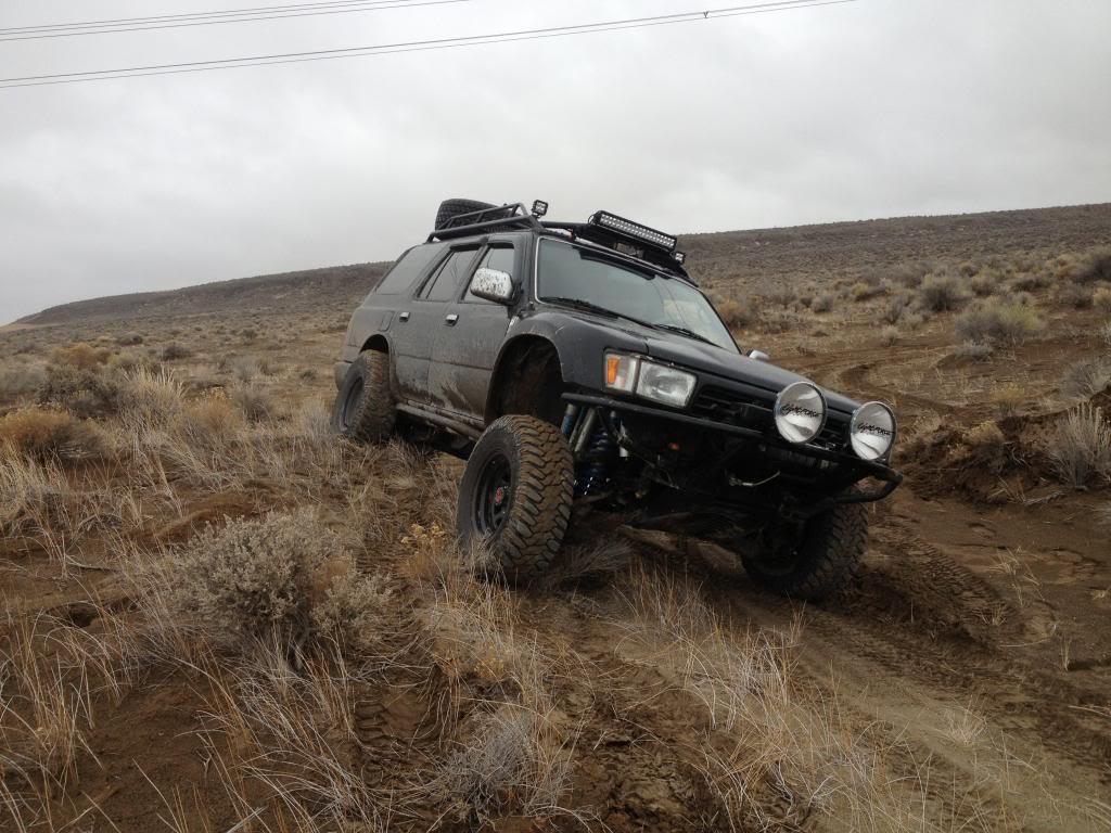

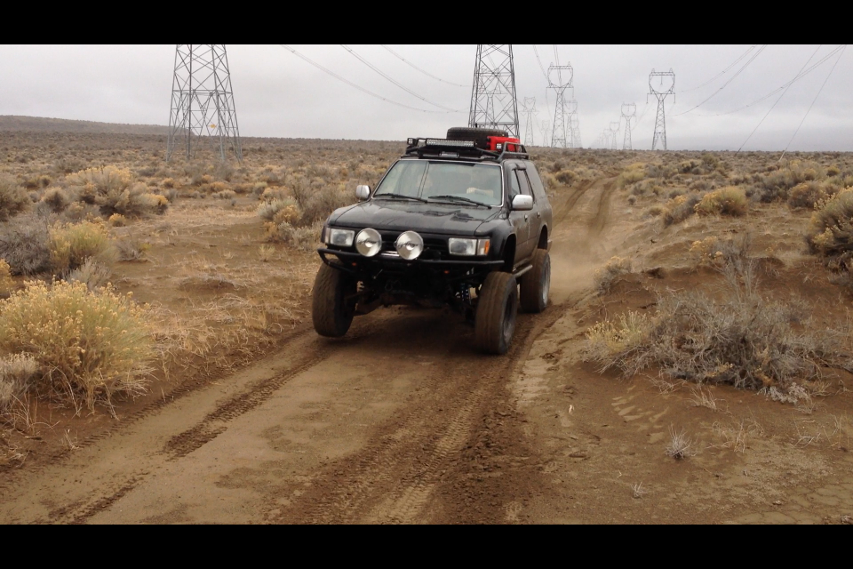

I dunno if i posted these... sorry if its a repost
the driver side tire is on the ground. passenger rear tire just off the ground.
