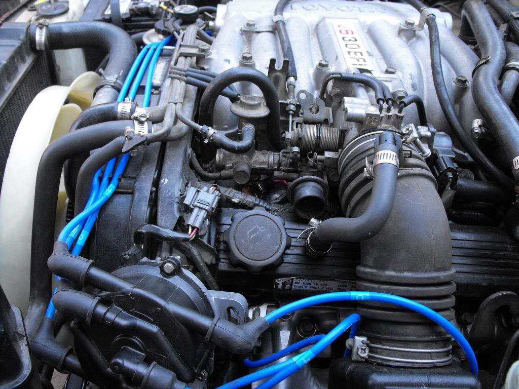

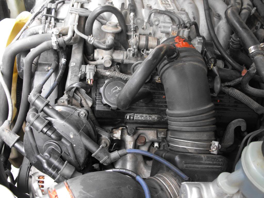

Installed the plug wires, checked air gap (0.011),set timing.
Distributor is turned the the limit counter clock-wise, doesn't seem right that it is turned the the limit, but the timing light says that where it should be.
Valves on the left side seem loud to me, making more noise than the right side.
Think I'll pull the valve cover and check the clearances. None of the lifters contain shims.
Seems to me if you grind the seats and valves you would need to grind the stem to make it shorter since the valves would be sitting deeper in the seats.
Pic of distributor before dis-assembly. Turned all the way clock-wise.
Pic after re-assembly.
