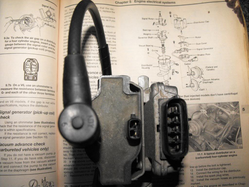

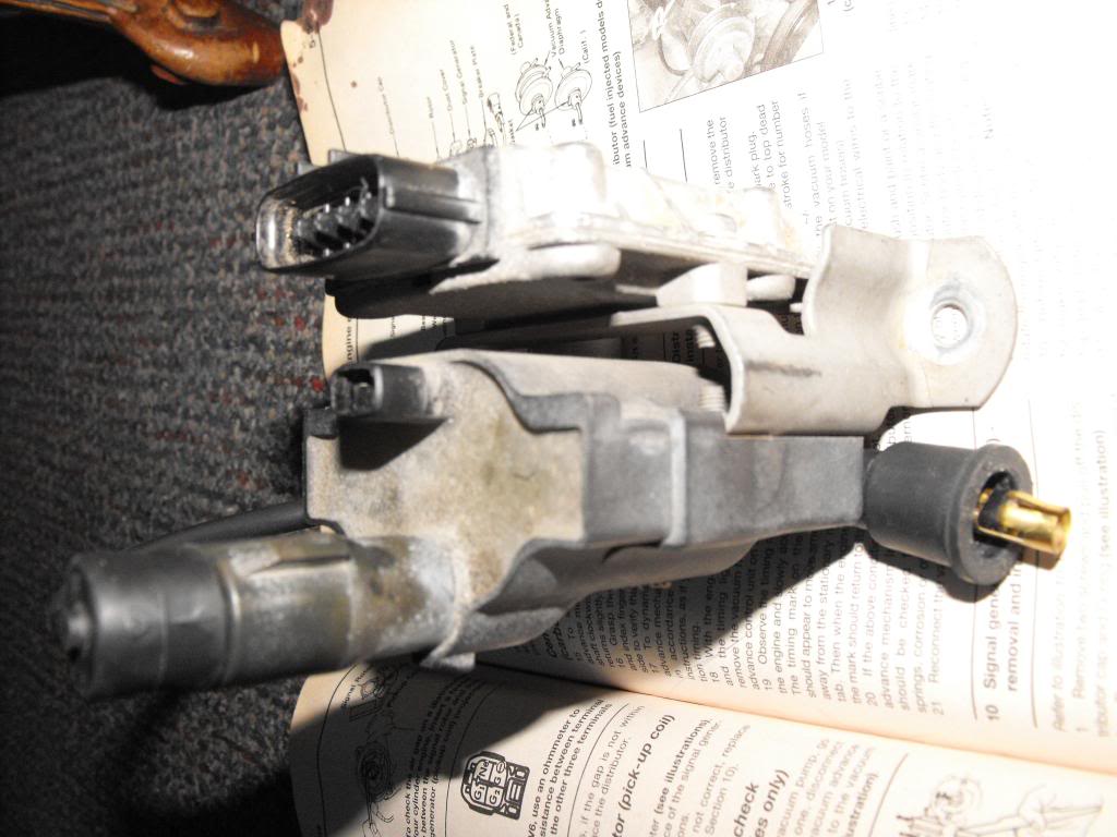

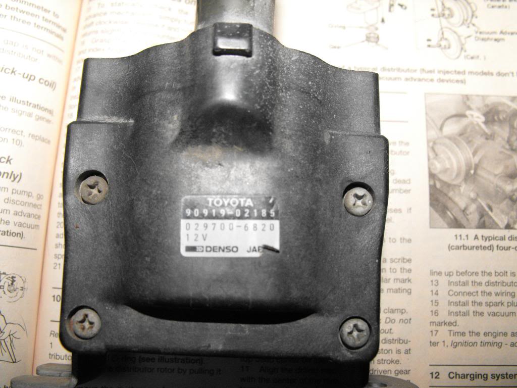

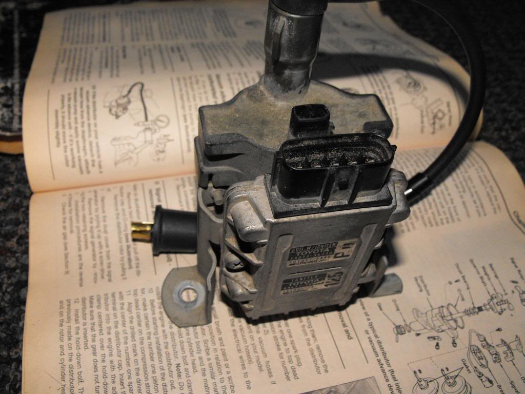

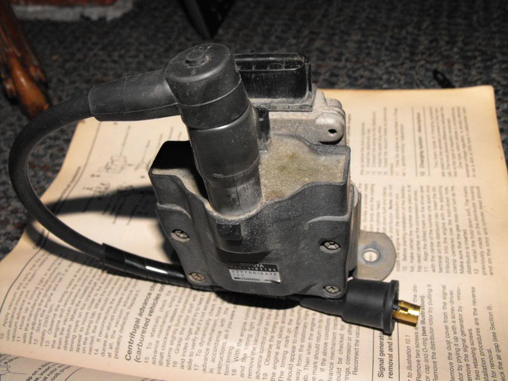

Pics of the unit in my rig.

Coil and plug wires are brand new out of the box.

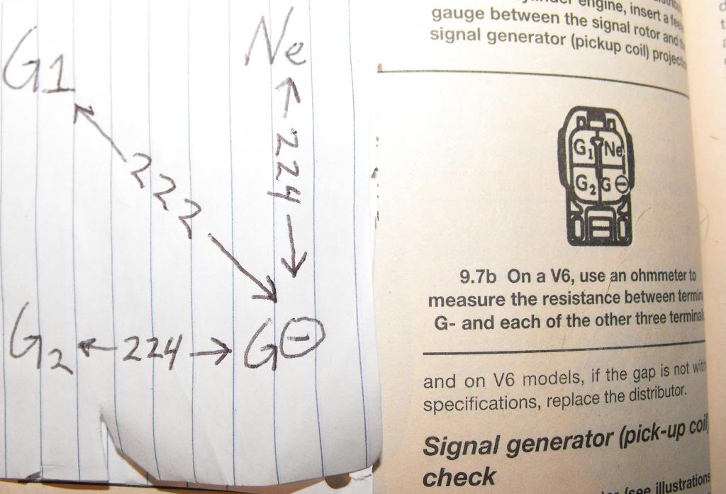

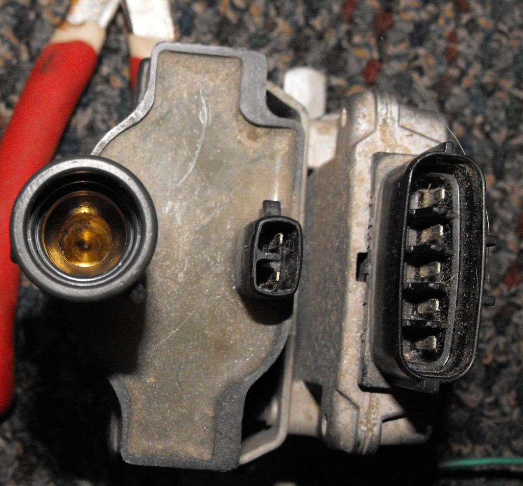

Pick-up readings.

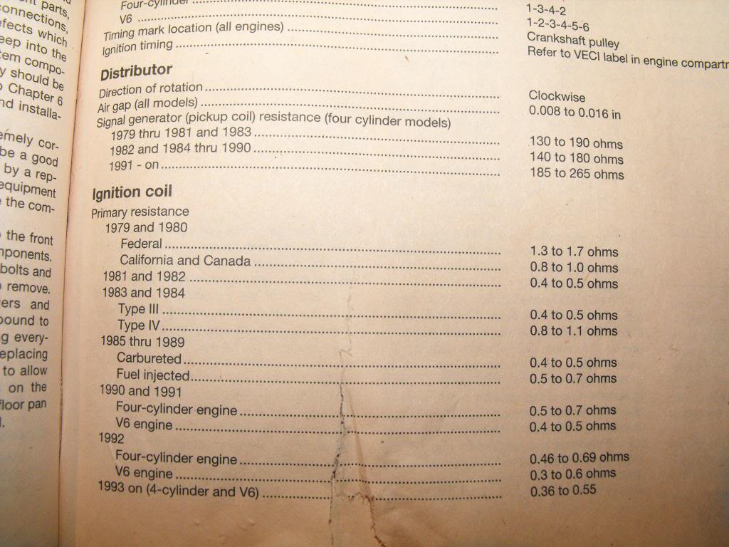

Good old Haynes, only gives 4cyl specs.

looking at your coil
That coil wire don,t look like its fully in !
wrap wire around your probe and put the the other end in the the firing hole !

im replacing my coil and igniter at same time tomorrow or today I would say @ 9am... I had a code 14.... hope it fixes my issue... and your wire is fully inserted mines the same way and worked forever
according to my book you should get 0.4-0.5 ohms on primary side of coil, note this is for cold coils the secondary circuit resistance should be 10.2-13.8k ohms. mine starts failing after it heats up a while

You should be getting a reading on the secondary resistance. The fact you got nothing means one of two things:
1. Your coil wire is bad out of the box, somewhere along the line the wire is severed.
2. Your coil wire isn't inserted all the way! The lip of the rubber should be over the tower and should be straight up and down, which it isn't. If you're set on keeping it, cut off the excess rubber so that it fits right. If you don't believe me, take a pencil and measure how deep the tower is. Then compare from the edge of the rubber to the metal tip. Does it reach the bottom to make a firm connection?

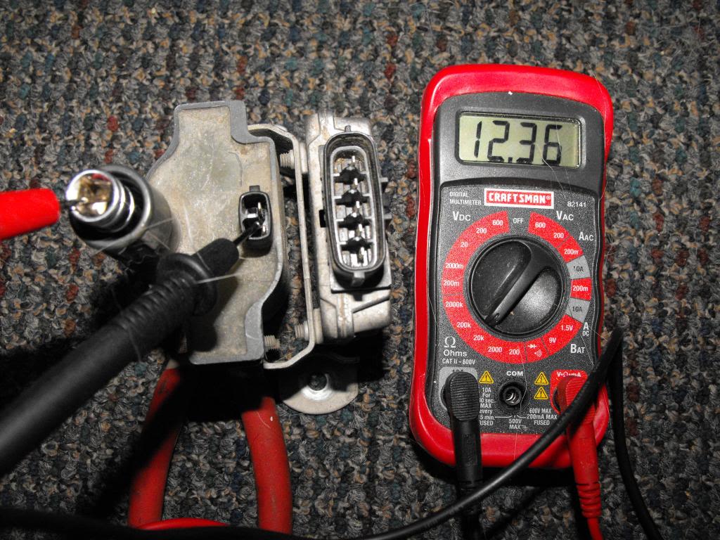

First off, thank you gentlemen for your help.
I'm a good assembler, mechanically, but my electrical skills aren't that great.

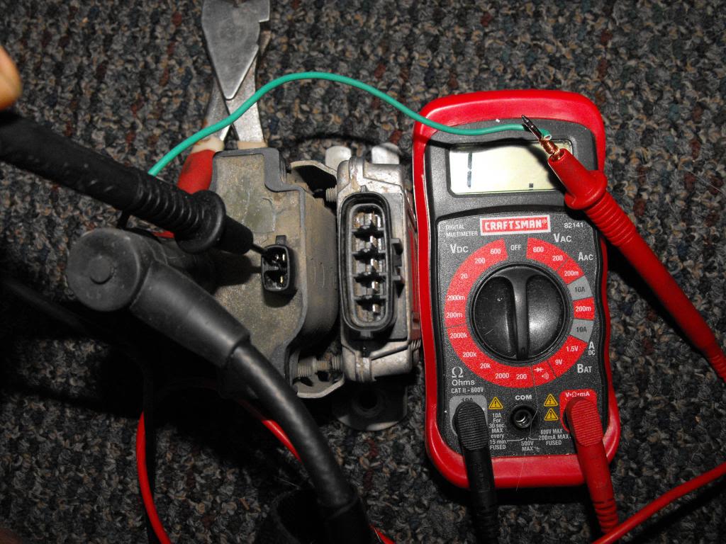

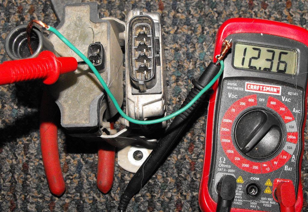

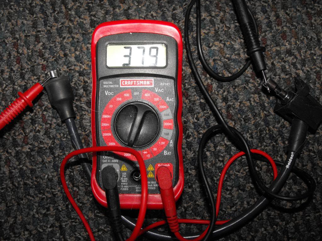

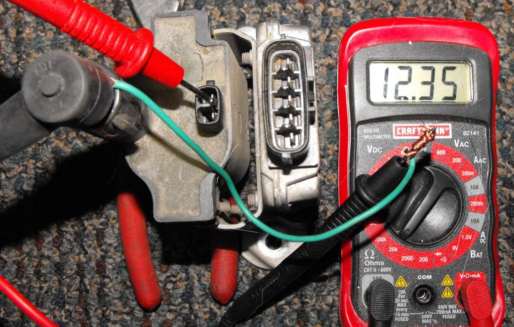

Some more pics, more experiments.
Pretty clean in there.
Probe extension wire.

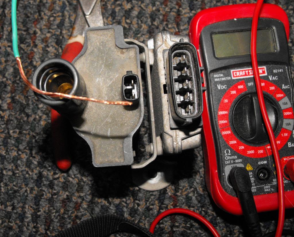

Wire jammed in tight with coil plug. Meter at lowest setting.
Meter set at 20k
Without plug jammed in.
Using 1/4 inch extension bar for probe extension, 2 inches in length

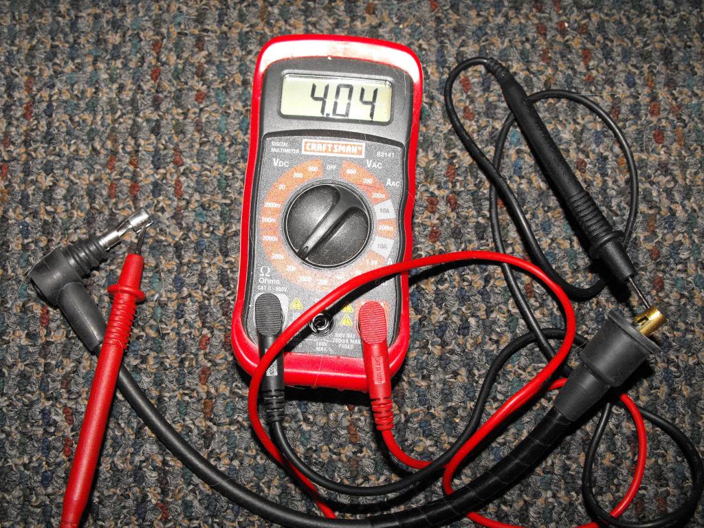

Coil wires.
Old wire, meter set at 2000.
New wire, meter set a 20k

Seems to me the resistance is WAY too high, no where near specs, but I did get readings this time.
Old Aug 7, 2013 | 08:29 AM
big bear's Avatar
Joined: Jul 2013
Posts: 294
From: Big Bear Lake, Cali
Looks like the old wires are better than the new ones.

coil readings look ok to me...wire reading seems too high on the new one, although whether it would cause a problem or not is debatable.
Usually the only problems toyota coils ever have is after they get warm...sometimes though they are DEAD and you'd have no continuity

That's way too high of resistance for the new coil wire, that was most likely your problem. Keep the old one!
Might be worth checking your spark plug cables as well.
