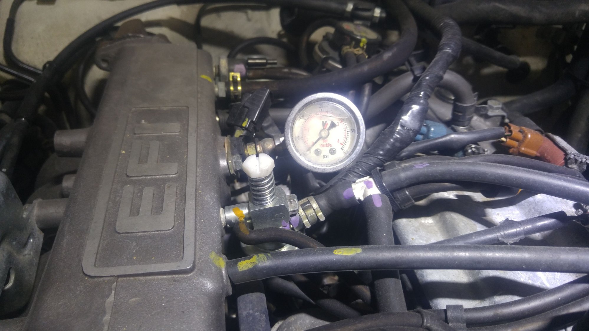

Check out post #641: https://www.yotatech.com/forums/f199...l#post52312190

Originally Posted by slabbandit
Are you guys leaving this little fuel gauge on the modified cold start injector banjo bolt permanently or just during testing?
I used a liquid-filled gauge and it is permanent. Same setup in the link I posted (thanks to RAD4Runner), but also used a 90 degree elbow so the gauge faces forward:
https://www.lceperformance.com/Fuel-...-p/1093076.htm
https://www.northerntool.com/shop/to...isSearch=53721
https://smile.amazon.com/gp/product/...?ie=UTF8&psc=1

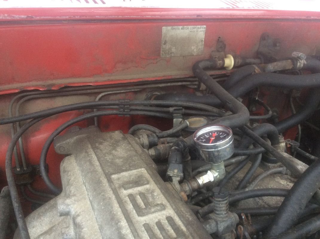

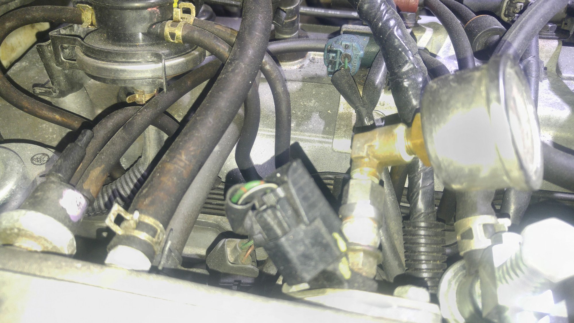

mine are permanent. one with the elbow, the larger one without.
