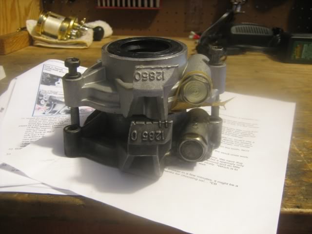

Great, thanks! I have the engnbldr 4 piece kit so the driver side guide has the metal backing. I'm not liking the oil pump though. The "0" and "5" marks are right next to each other, whereas the OEM one has a significant gap between them....so don't know how that play out- was going to shoot them an email. I'll post a photo if you're curious to know what I'm referring to.

I have the same "Rock" I believe Oil Pump. I think it's just that the 5 is bigger than the stock ones... but you still go by the markings. I might have a pic of mine, to compare. Just ask Tod what he thinks, ...for sure. GREAT GUY! And also mention your concern about the shiny link, where it's at now, etc., just to have confirmation from someone FAR more experienced than myself! lol. (First, though.... just try what I said, ok?)

Here is an image of the two Oil pumps...see the gap between the timing numbers? I sent an email to engnbldr just now.

Yeah, like i was saying,...just go by the MARK under the 5, not the 5 itself... The mark is close, as is the 8, 12, etc. Just line up the bolt/spring portion perfectly, then put a straight edge to the new one and old one and 'paint pen' yourself silly! lol.
