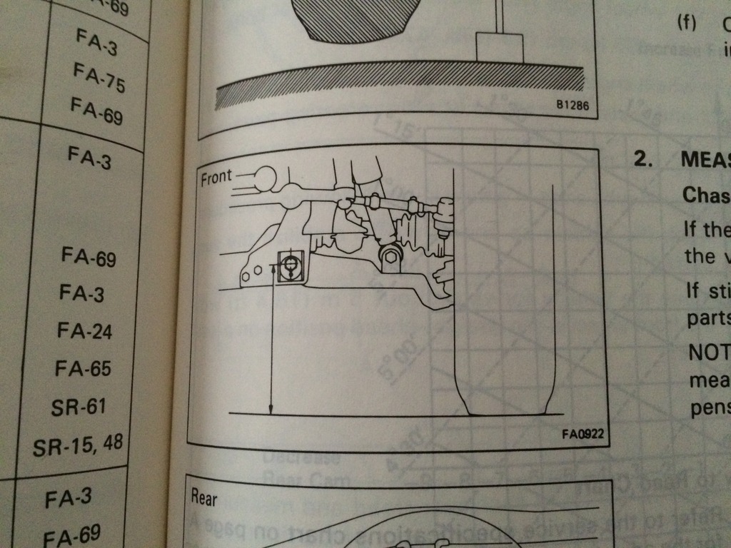

Page "FA-3" instructs the technician that before alignment of the front end, the ride height needs to be confirmed as standard and correct, and it is shown where to measure for this here:

This clarifies the correct spot to measure from, which is the "center of the lower suspension arm front mounting bolt" as pictured above.
These instructions also state to reference page "A-35" for the correct chassis ground clearance.

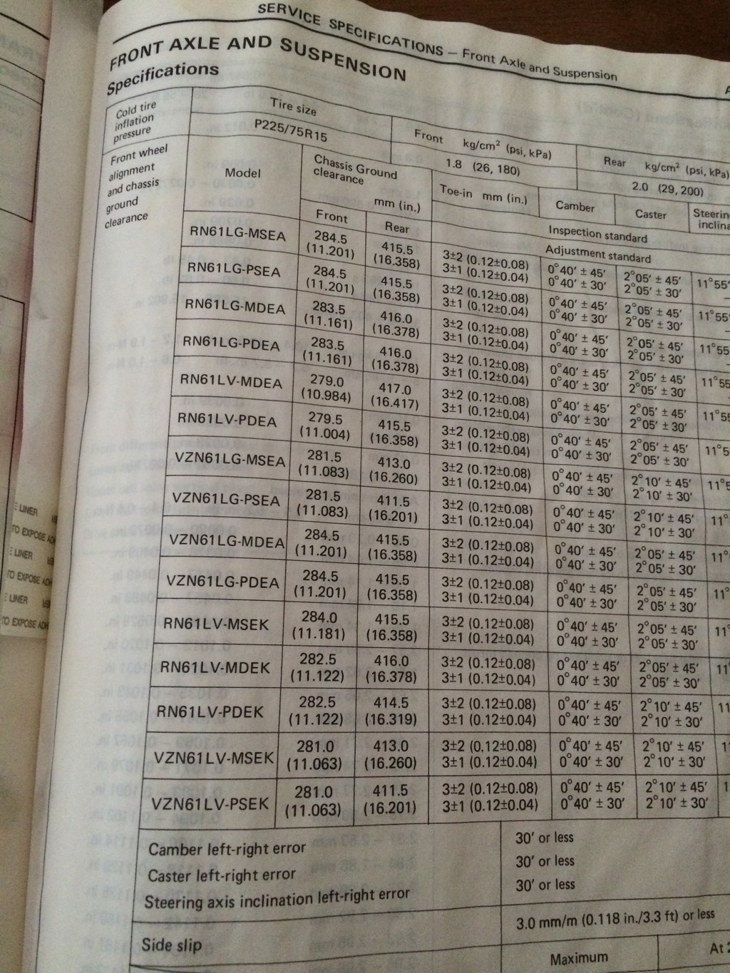

Page A-35 can be seen here:
Confirming your model will give you the measurement down to the one thousanth, but that is impossible to adjust to. Adjusting to the tenth is possible, and extremely accurate.
