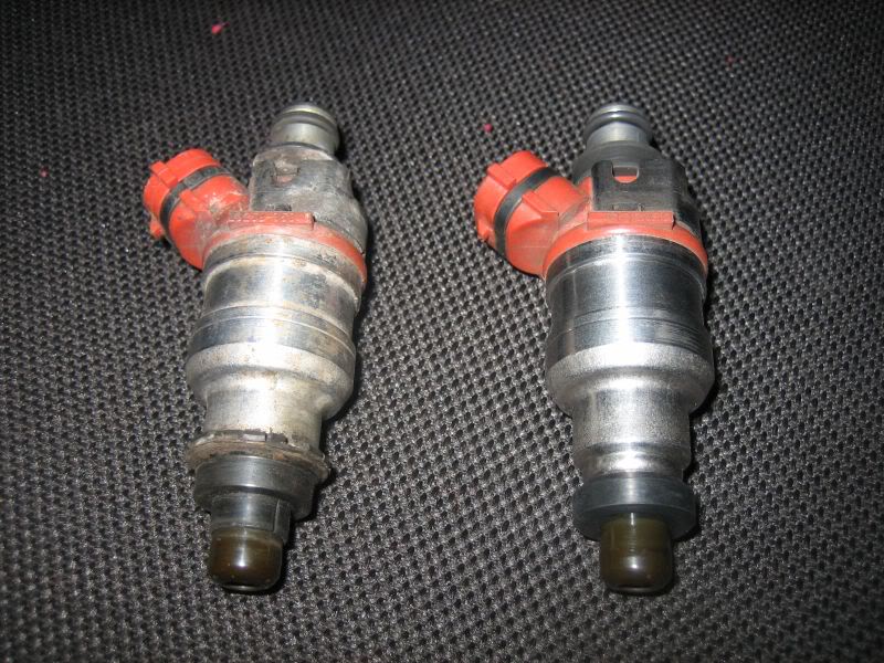

just thought I'd contribute; everyone likes pics
left is an old one, right is a rebuilt one (rebuilt by me)
and those seals pointed out:
it's kinda hard to see the one that insulator one...
I got the seals in complete kits, one for each injector, from the local auto parts store for about $4 each
