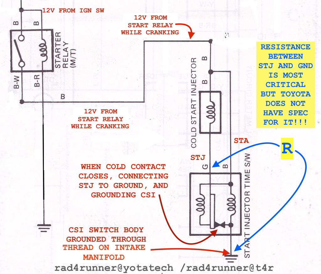

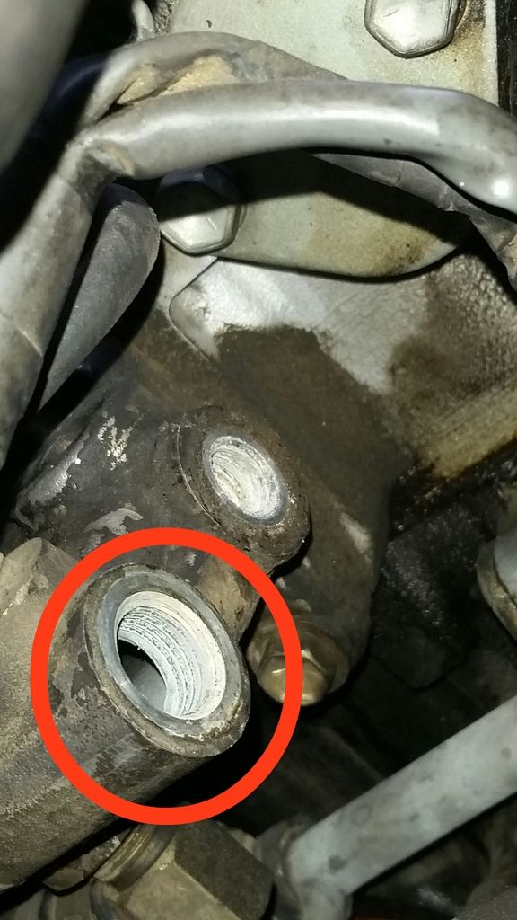

Did you measure STJ to Ground (brass housing)? This is the most critical spec that Toyota failed to include in the FSM.
Did you clean the thread here as suggested above? THIS IS VERY IMPORTANT. EVEN IF THE CSITS TESTS GOOD OFF THE ENGINE, IT WILL NOT WORK IF IT IS NOT PROPERLY GROUNDED. This is how the CSITS gets grounded. Use battery terminal cleaner.
Above is explained here:
