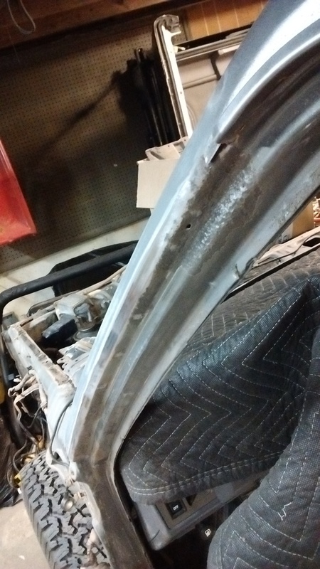

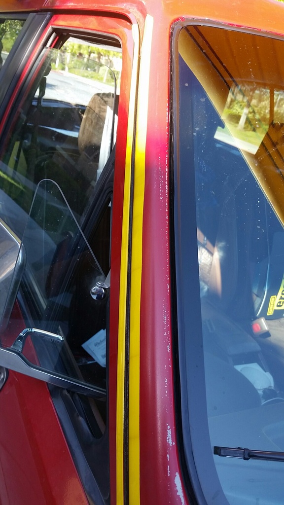

Hi guys,
I need to touch-up paint on my front top, including rain gutters

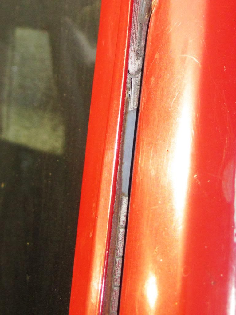

The rain gutter is merely spot welded to the A-pillar, Then body filler WAS used to seal the seam and then it was painted.
Inside the narrow, vertical portion of rain gutter looks like dried/cracking body filler or caulking.
This causes rust in the gap between A-pillar and gutter.
I already started on the right side because that's where I usually load my kayak which drips saltwater.
So far...

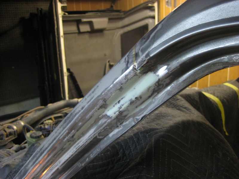

1) Removed the cracked and crumbling body filler, making minimal rust is left,
2) Coated it with Permatex Rust converter-primer (because I haven't bought POR-15 yet - altho the Permatex had proven rust resistant even without paint on it.)
3) Painted over the Permatex primer. (used thin and wide watercolor brush to get in there, both on paint and primer)
Now, What seam sealer to use to take care of that gap?
I do not think body filler would be a good thing to use for reason mentioned above.
Silicone may work.
However, I've seen seam seals on newer truck beds, like the Tacoma. It seems flexible but paintable, so it must not be silicone.
Marine sealant like 3M 5200 came up in searches. Makes sense for my application because I have saltwater drip on the roof and gutter.
Does anybody have success stories they can share? TIA

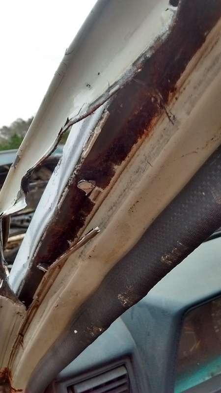

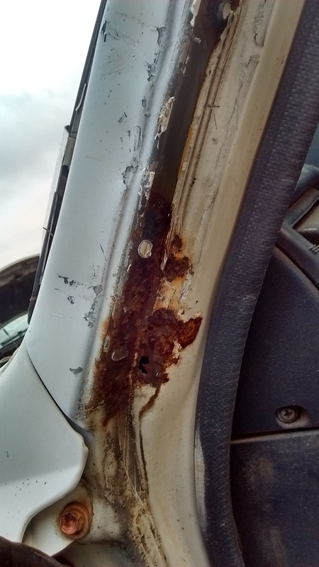

I would recommend using 3M seam sealer. I used P/N 08300 for most of my truck when I was redoing it. It was unavailable when I ran out and I used a generic one from Advance Auto which was branded Dynatron. The 3M stuff is easy to work with and dries in a few hours. The Dynatron is slightly thinner and takes about a day to dry. I'd say after it's all done they'll both be fine. 3M costs about $30 a tube, the Dynatron was $12.

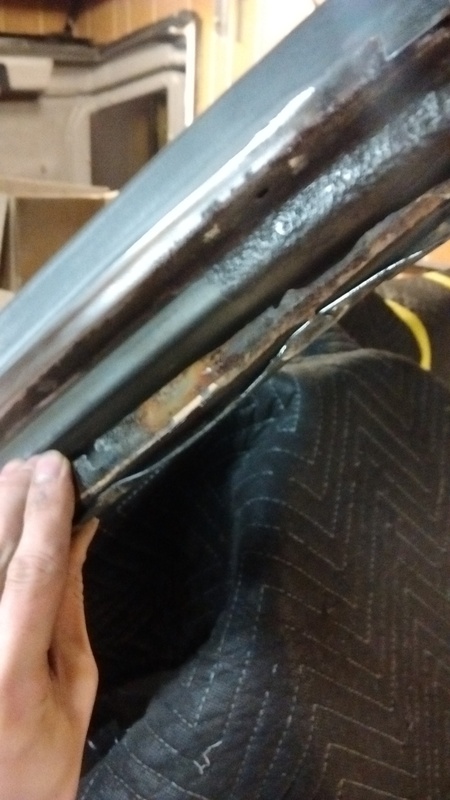

As far as the rain gutter goes, the rust you can see and remove is only the tip of the iceberg. You're right, the rain gutter is spotwelded to the inside of the A-pillar and then seam-sealed. The seam sealer cracks and lets water in between the rain gutter and the a-pillar. Here's a picture dump from me examining a junkyard truck (white) and working on my 4Runner (gray).
Here's the rain gutter peeled back a bit on the junkyard truck. As you can see, there is rust all along the entire length of the inside of the rain gutter. None of this was visible before peeling the rain gutter off.
Down at the bottom was the only rust that was visible before disassembly.

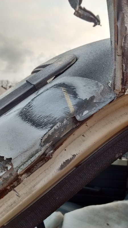

Up at the top you can see where the roof skin is brazed to the A-pillar.
Here's my truck after removing the rain gutter. You can see how bad the metal was pitted. One spot was eaten all the way through.
