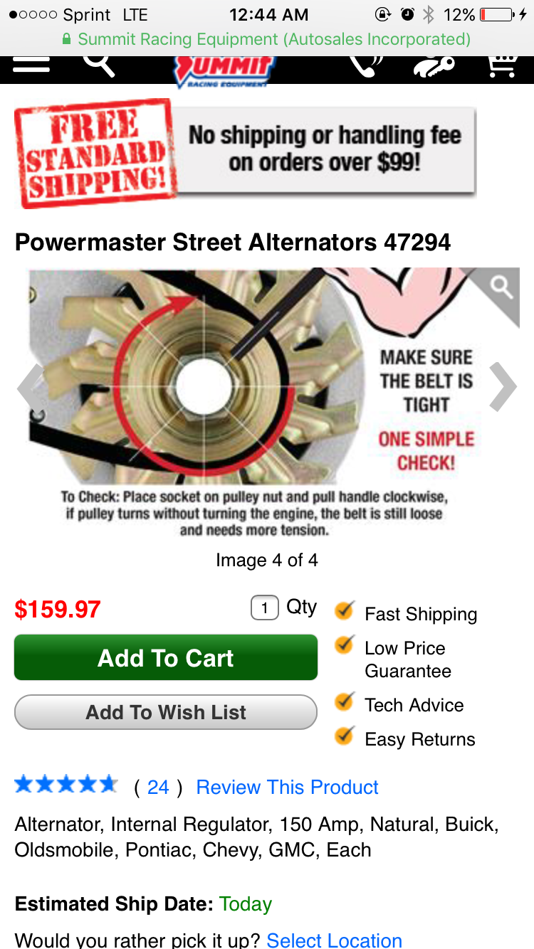

Just to verify how I have my wires connected to the 2 wire gm plug I bought here is that pic. Don't mind my ˟˟˟˟ty looking header. I have a lce one but my exhaust is 3in to long to fit it so I gotta head to the exhaust shop to have that done but I have bigger problems then that right now! Lol
Here is the pic straight from summit racing that was hanging on the pulley when I opened the box...
