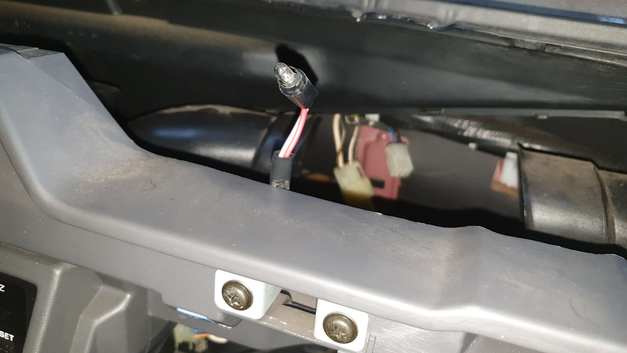

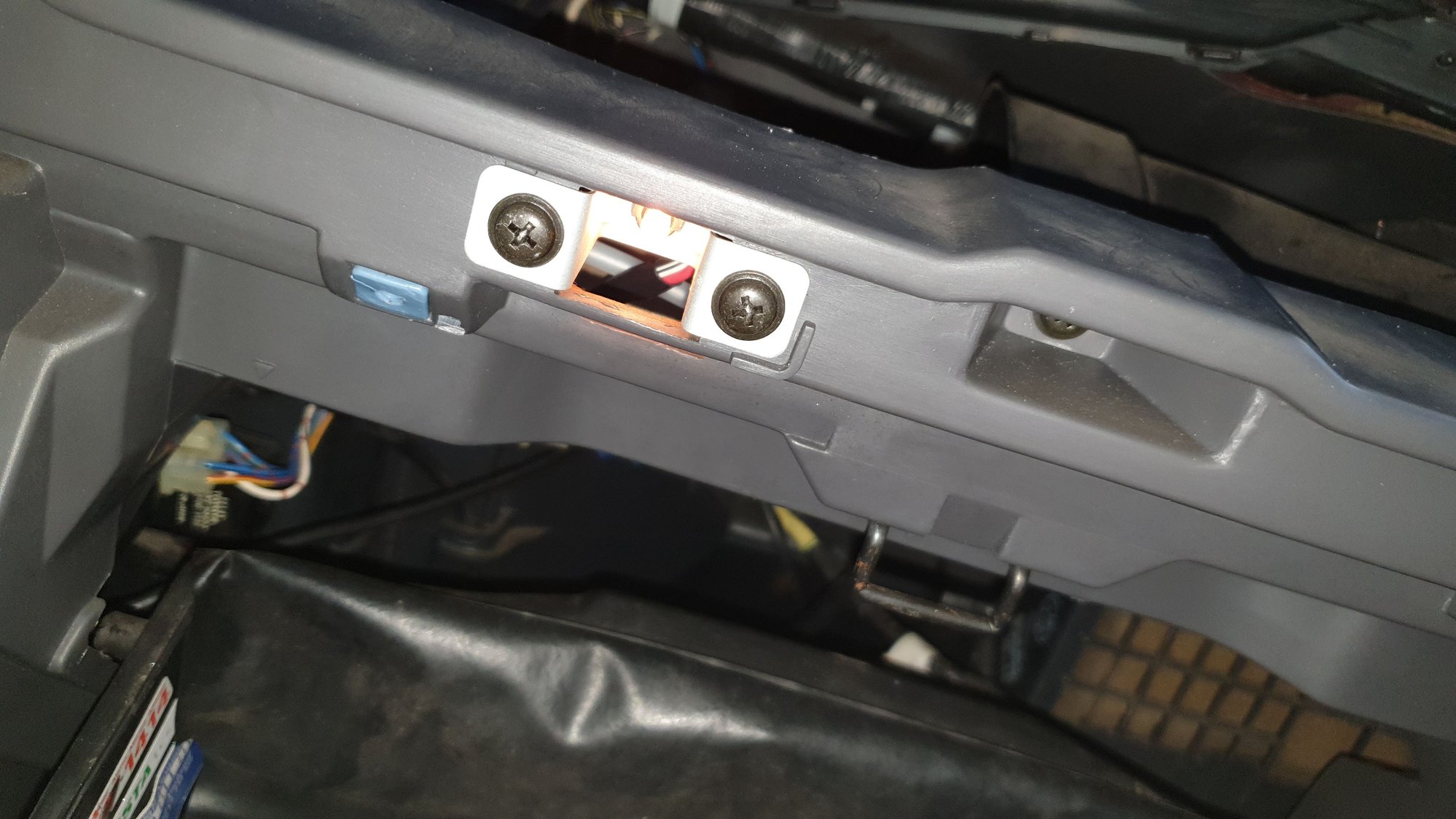

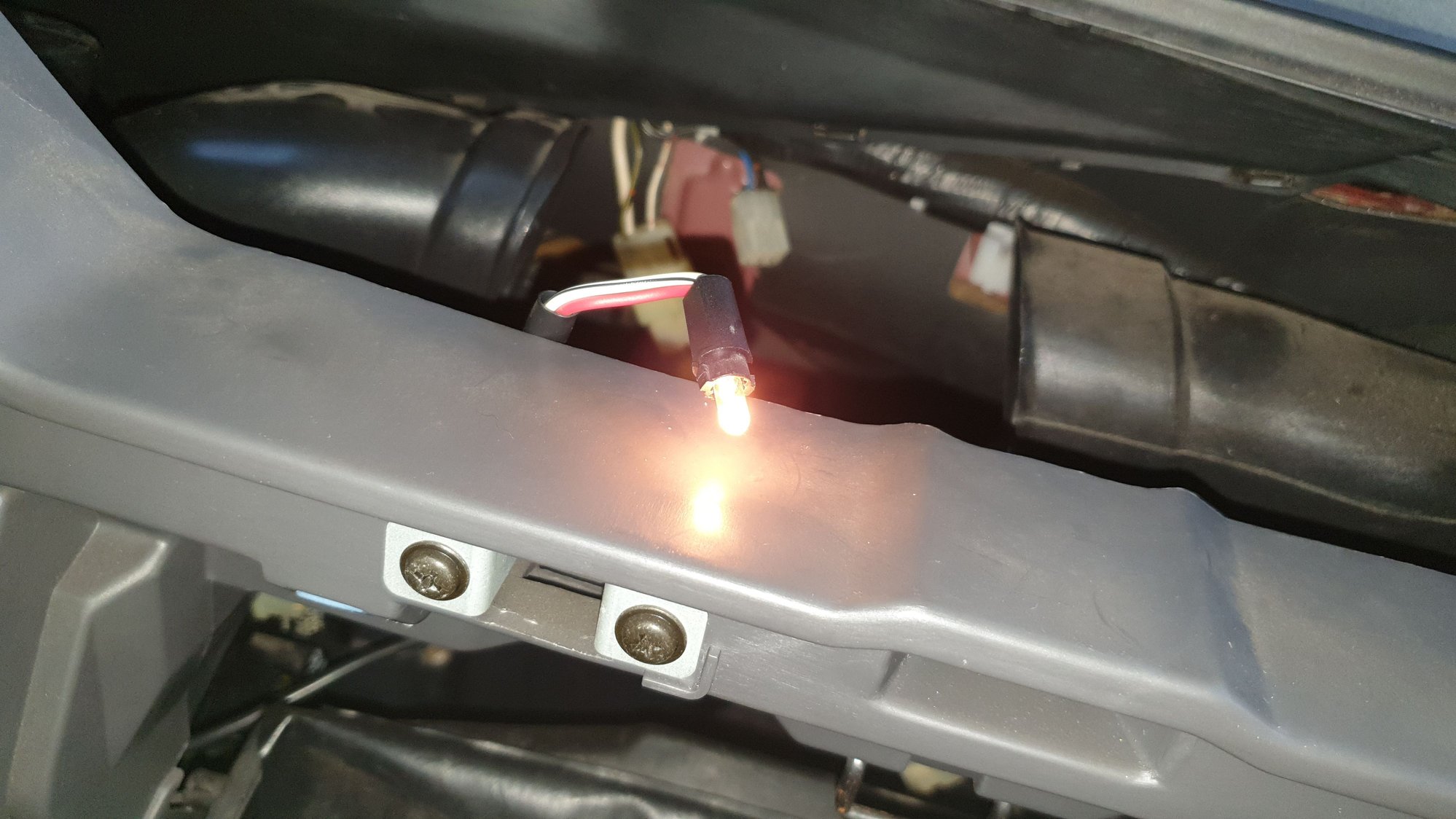

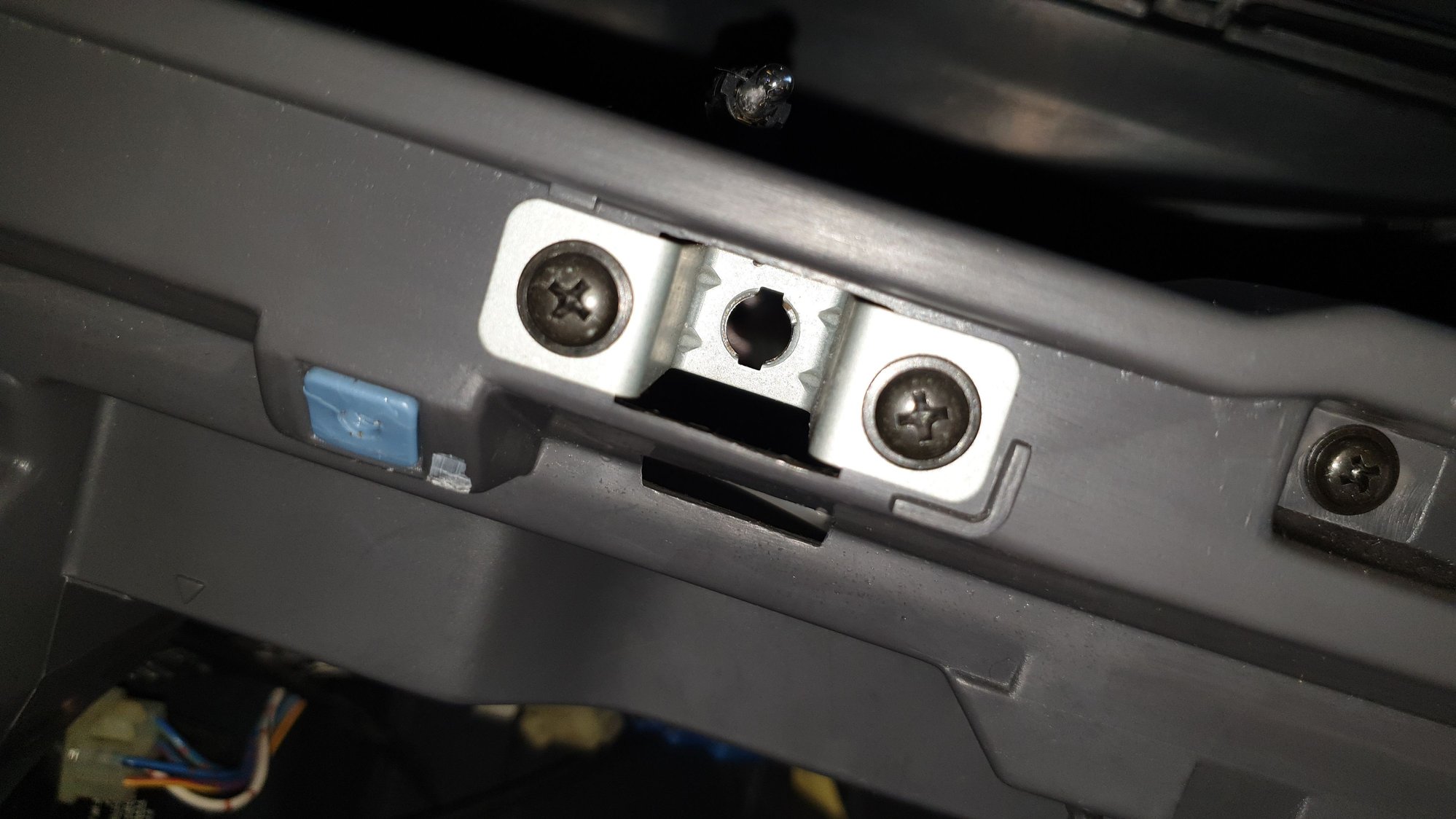

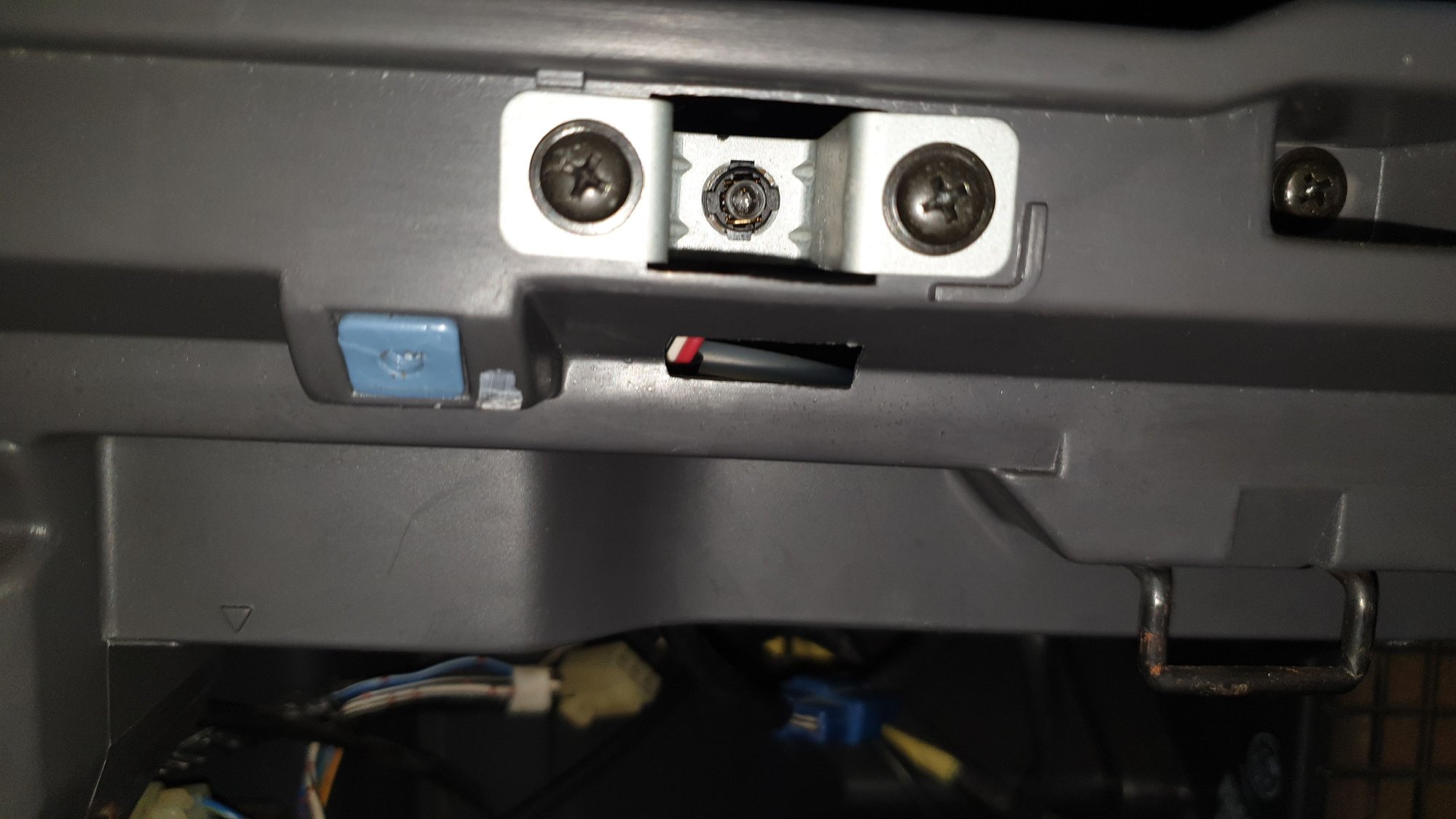

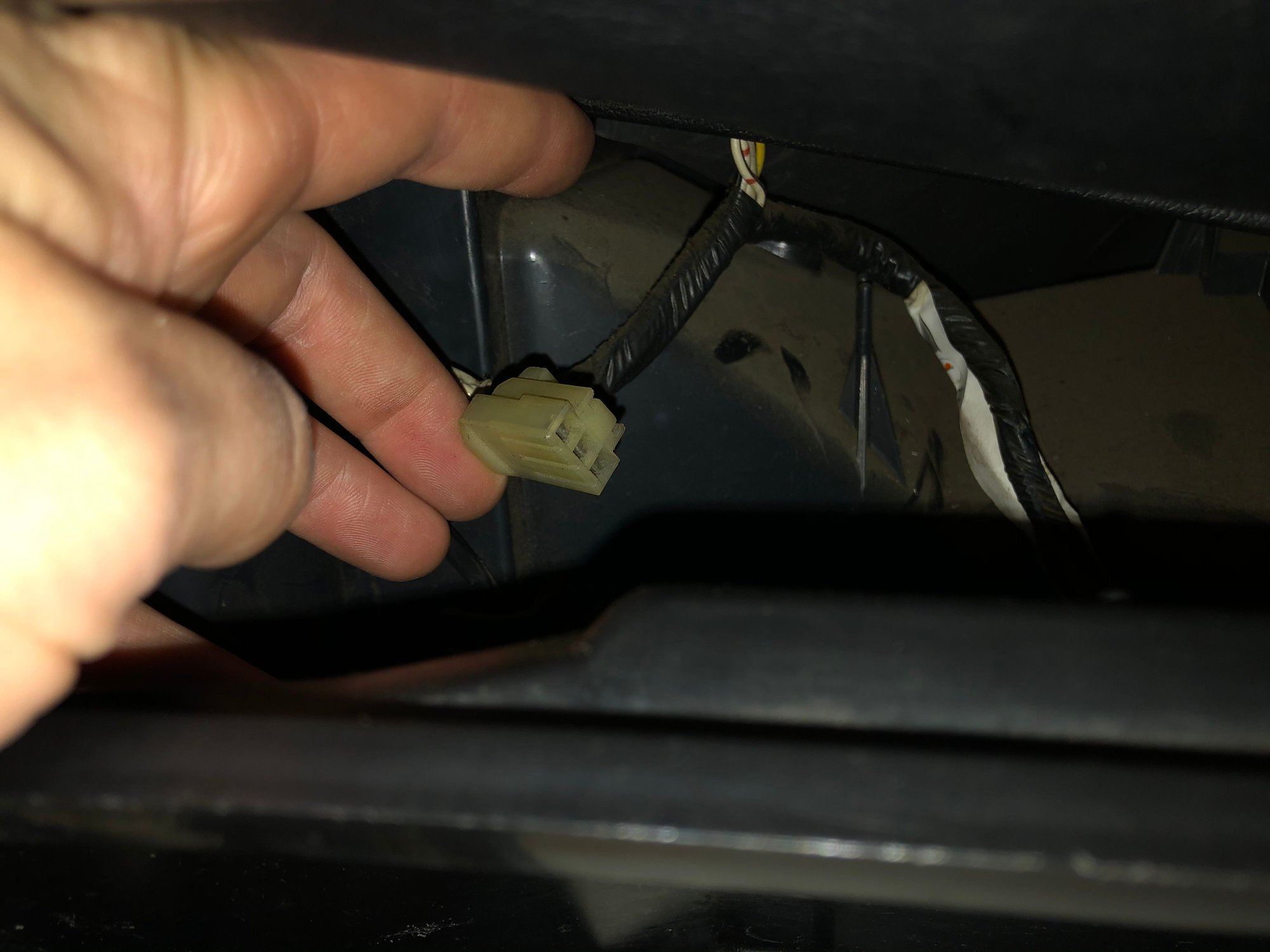

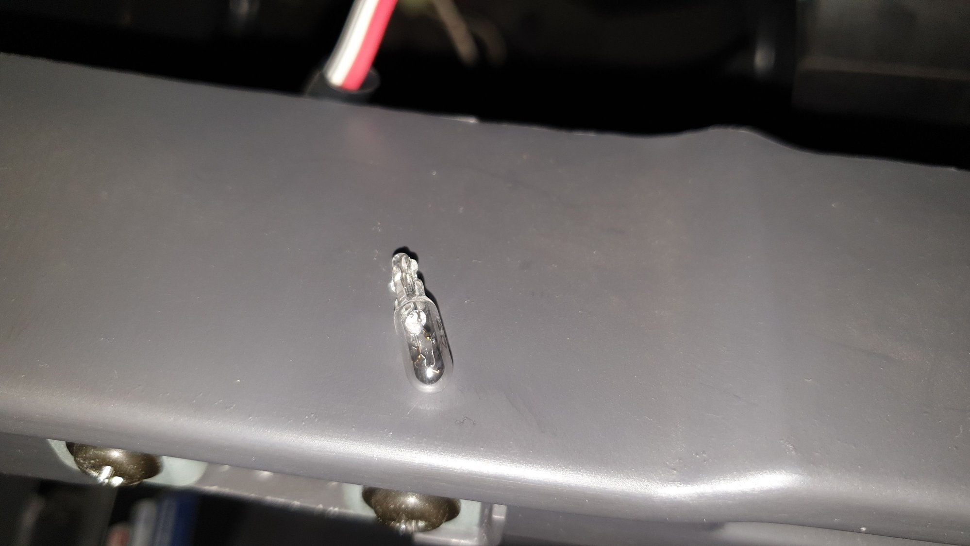

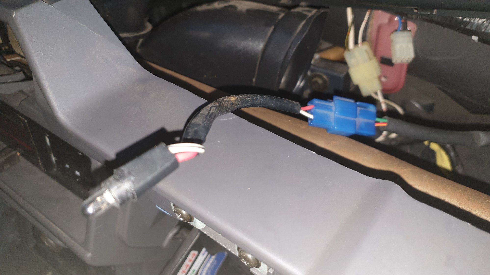

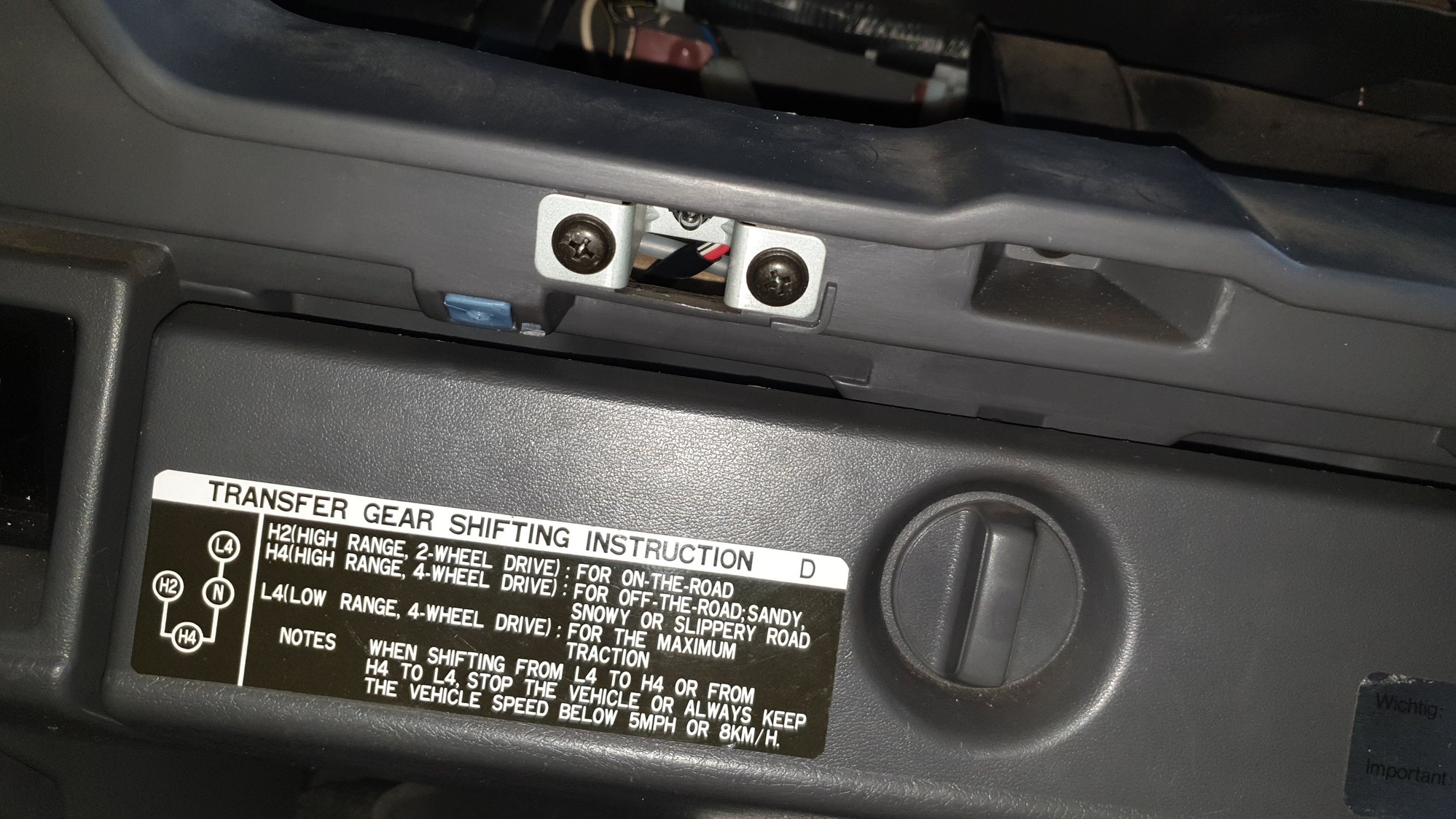

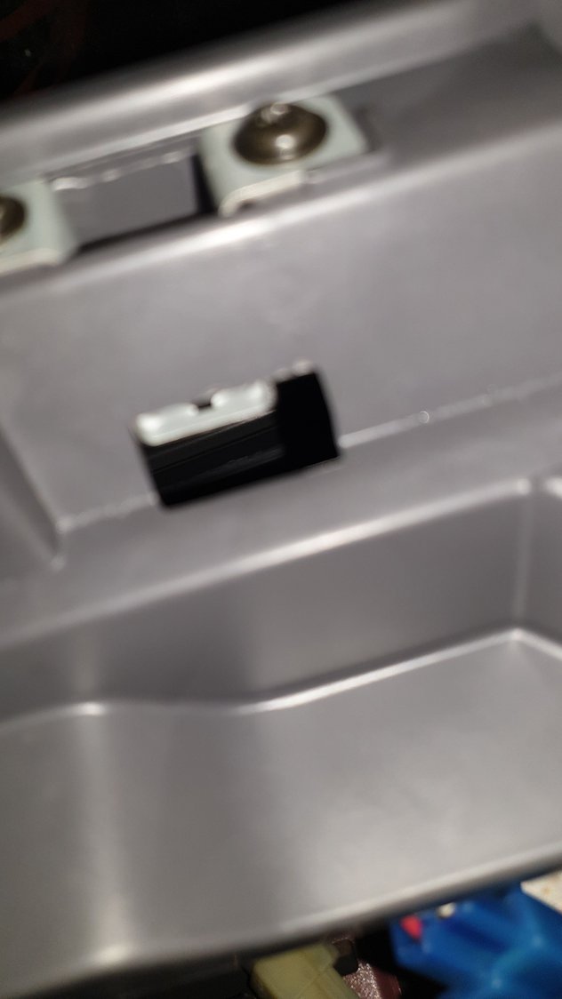

Here:

Originally Posted by SomedayJ
Anyway, you need the right led to fit the glove box light bulb hole. That hole is small and the smallest led I found can't go through it. The original light bulb performs better.
I was wrong:
You can see the problem with the led, the original light bulb emits(?) light in every direction, and it's needed down.
The led emits light to the front only, almost nothing goes down, that is the reason the original light bulb performs better than the led in that location.
Anyway I had to make the led smaller to fit it in that hole.

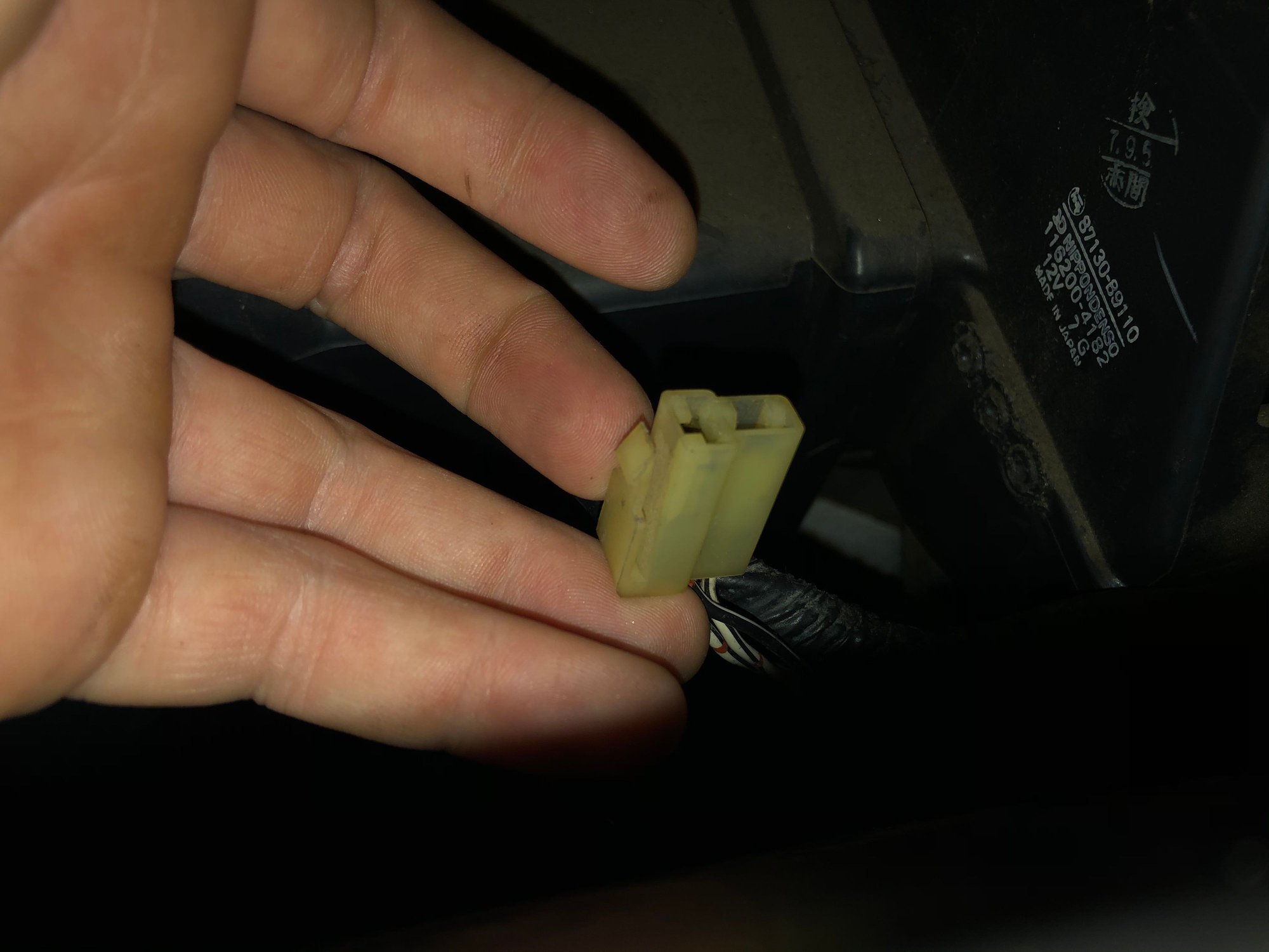

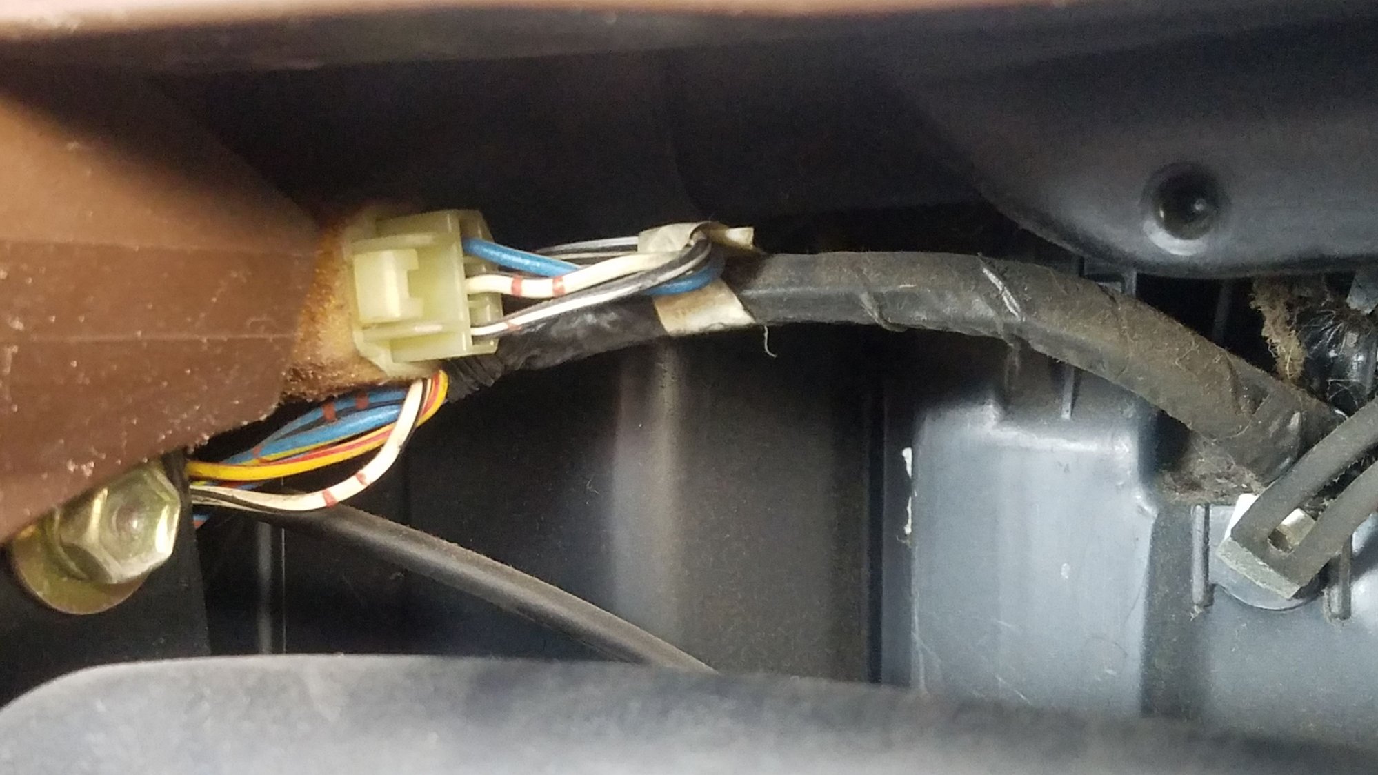

these are the unused plugs I see behind my glove box. I was wondering, my truck does not have A/C, would they have anything to do with that? I’m going to poke around some 2nd gen drawings tonight maybe the little light fixture is similar

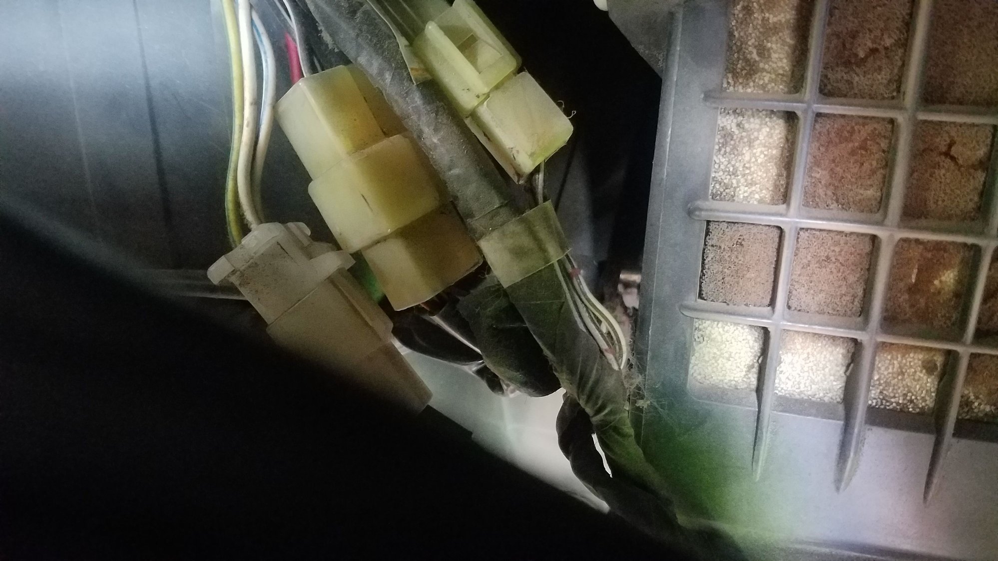

Sorry to disapppoint. Most likely AC circuit connectors. Here they are on my 1986 dlx with AC.
Left Side black relay
Right side near blower

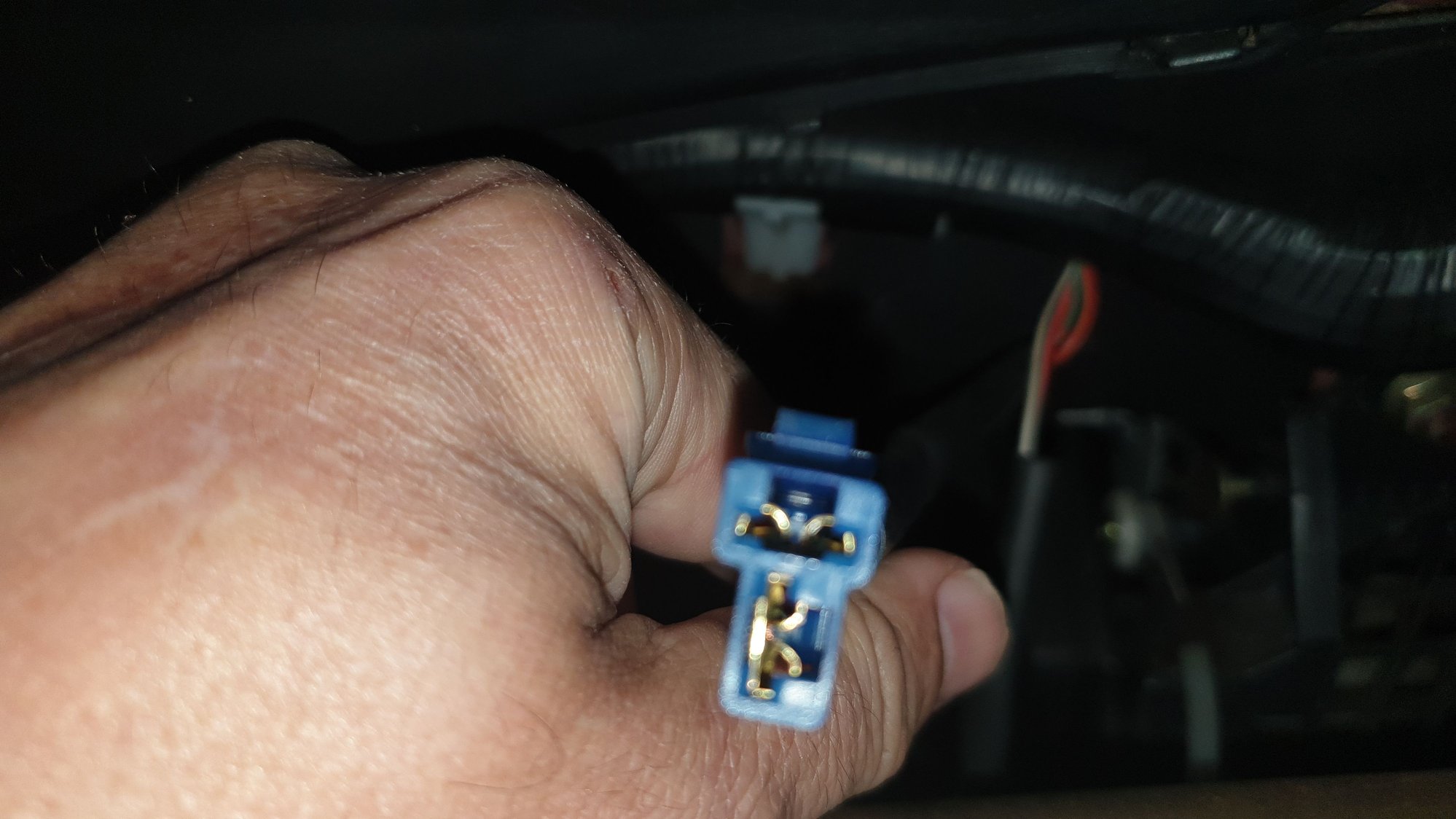

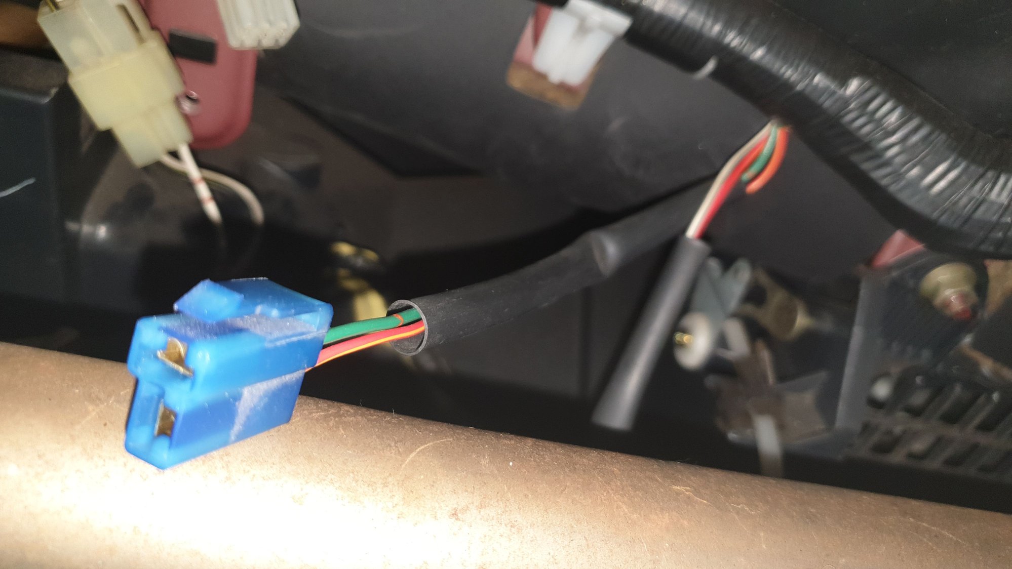

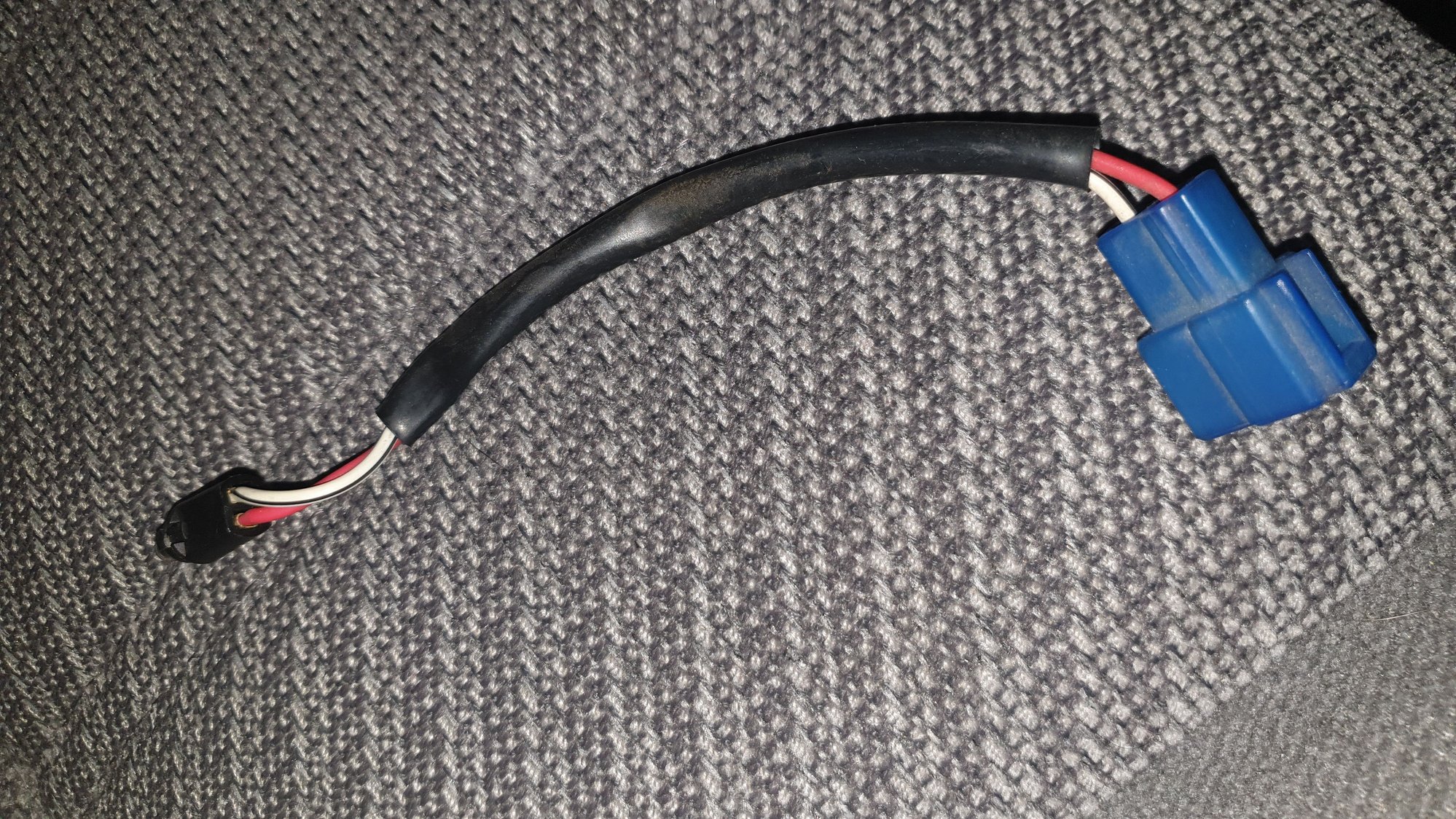

In my 88s, the glove box light connector is blue:
