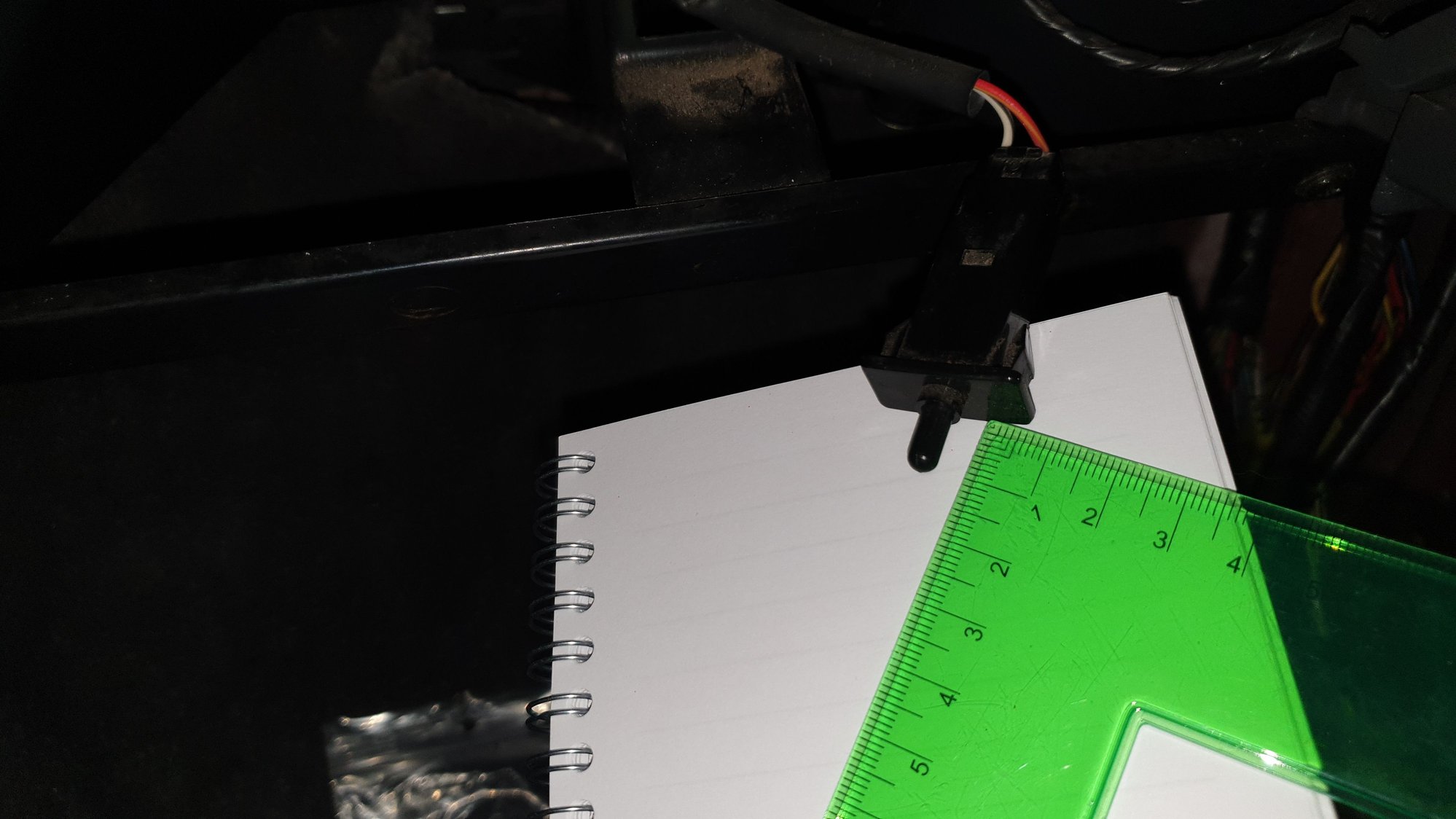

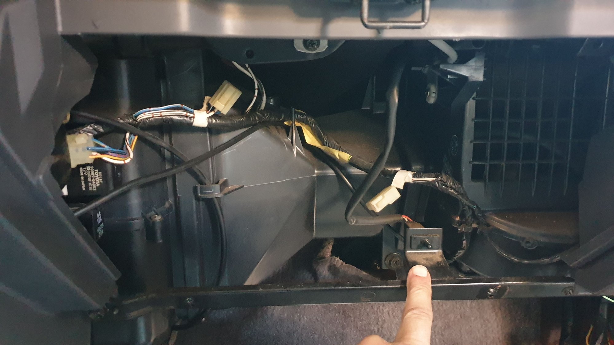

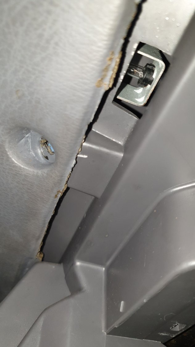

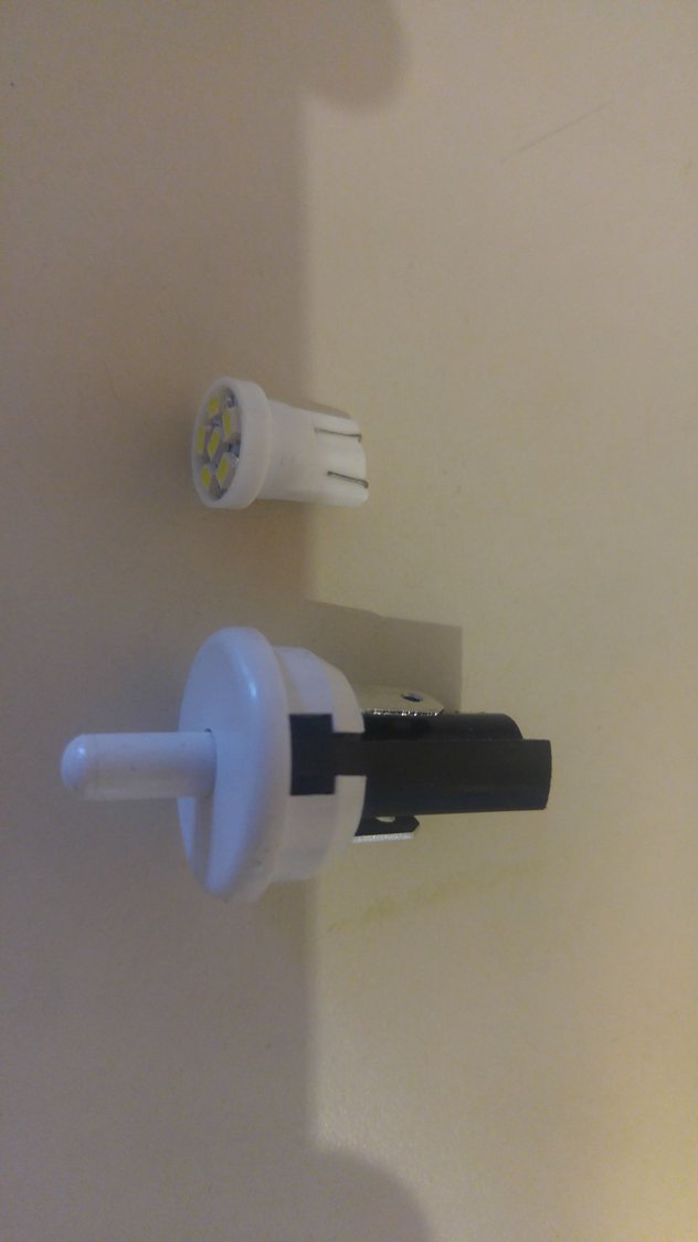

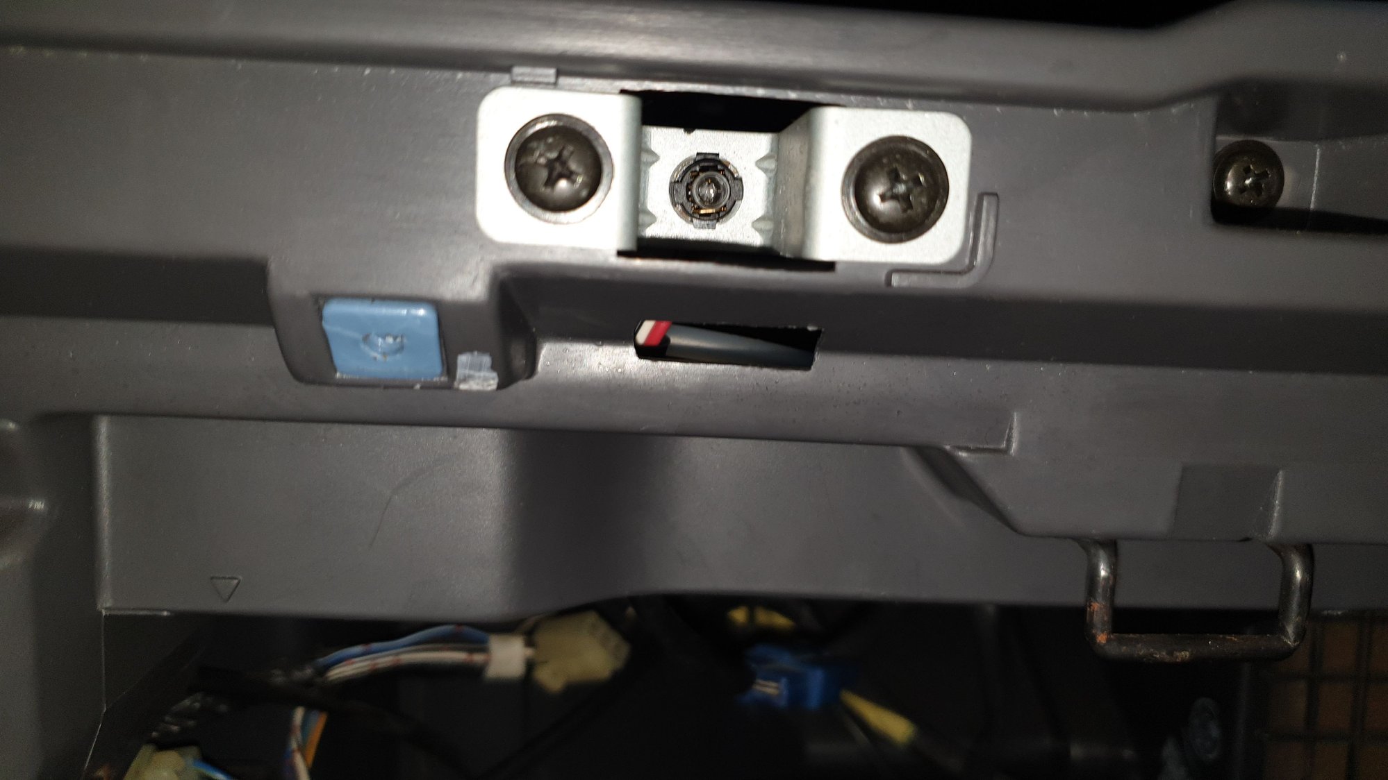

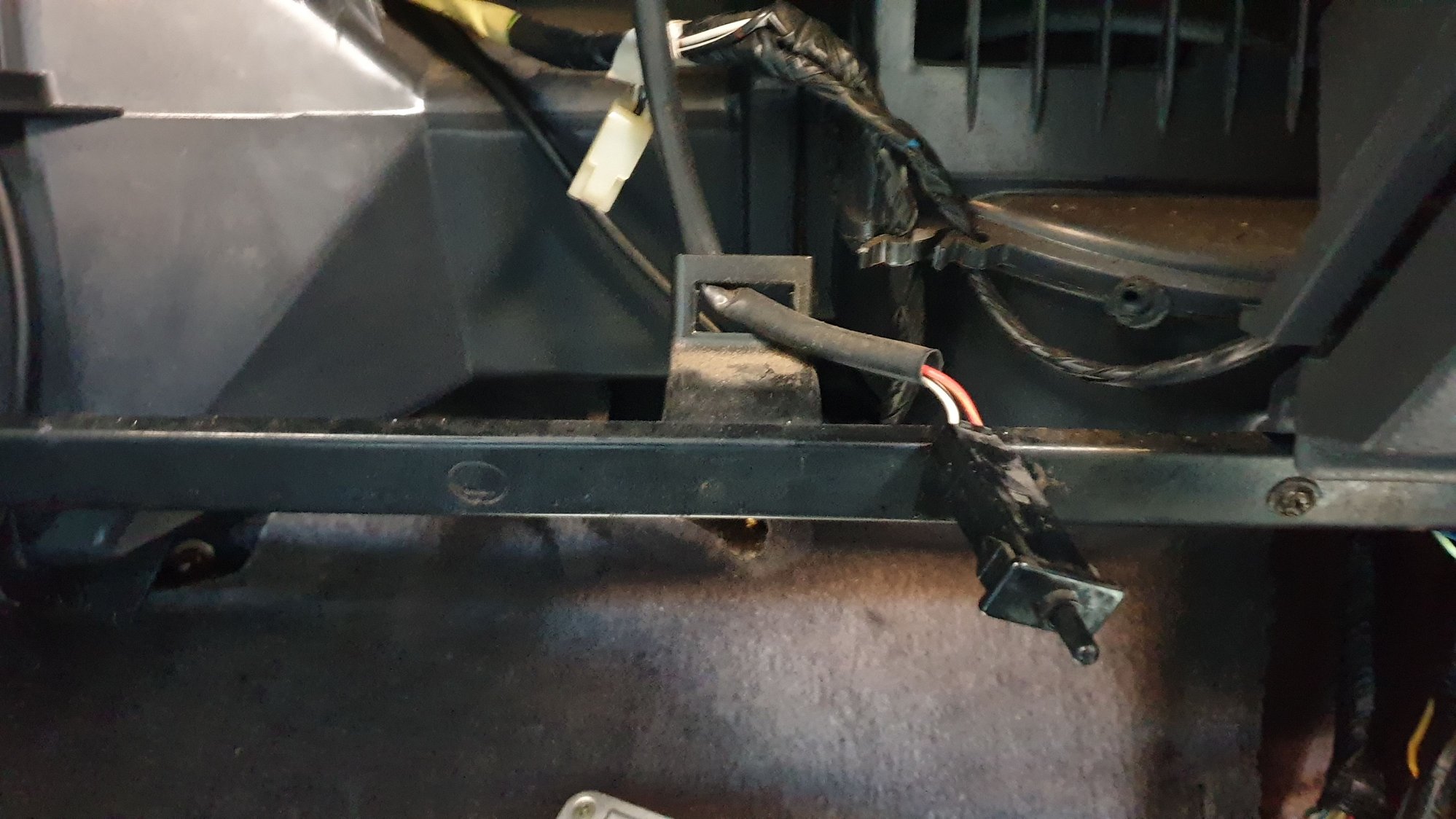

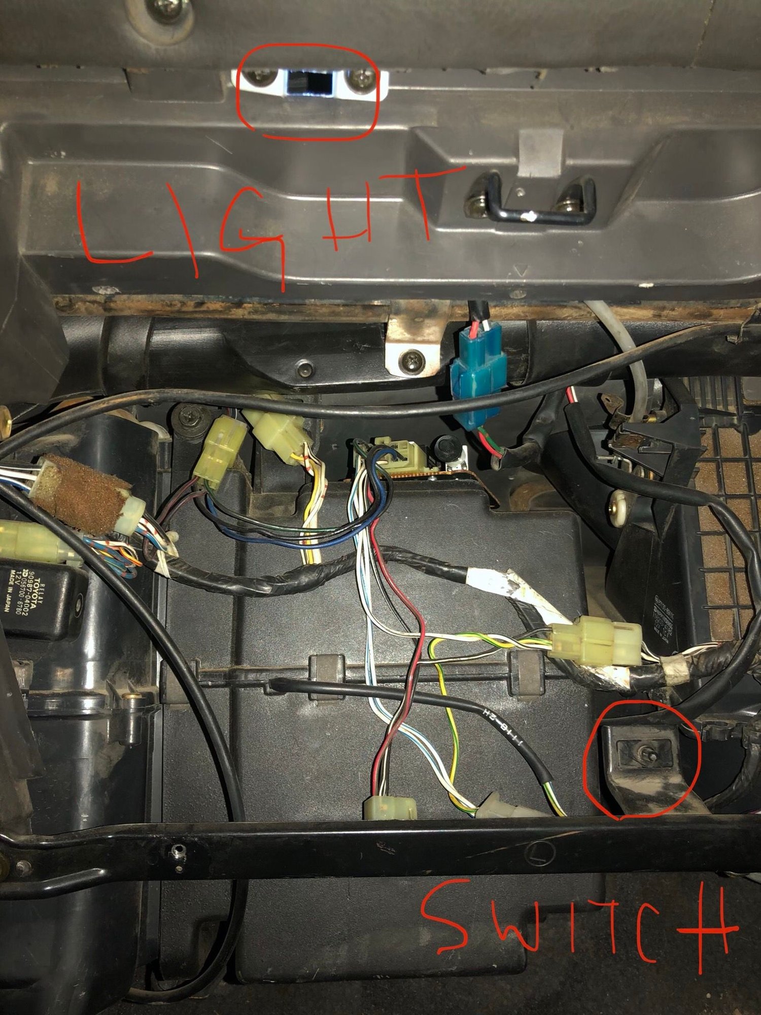

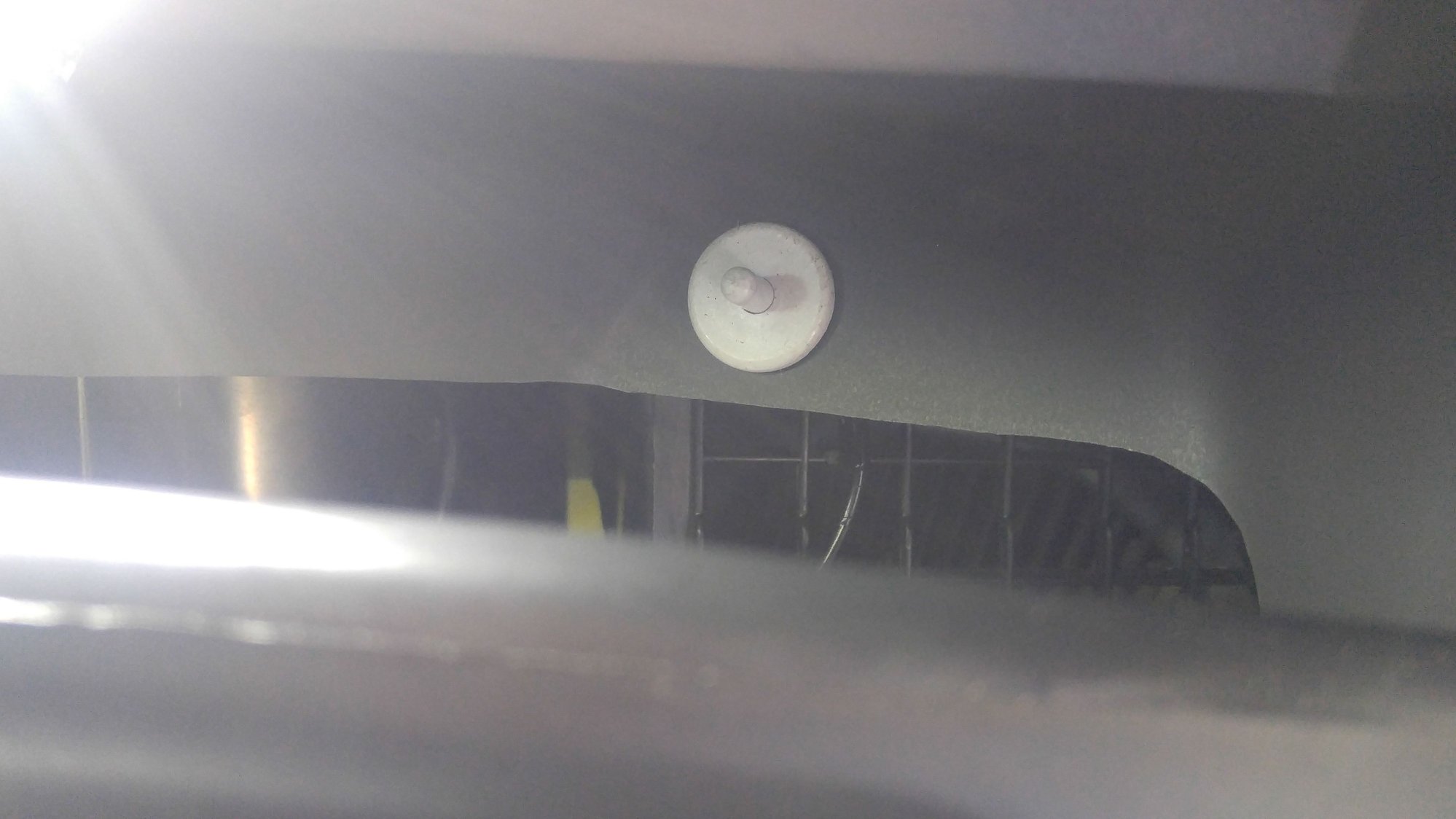

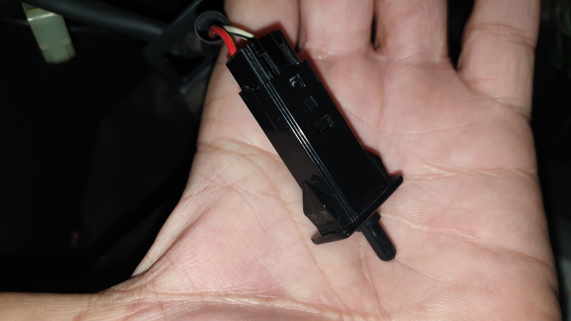

Could u guys pls post how and where the bulbs and door micro-switch are mounted? Shud be ez.to find parts and install a custom system wired to any desired fused/switched circuit.
You can follow the harness between the two, though it does disappear back up in there. Should be simple enough to make your own if both the switch and light bosses are present.

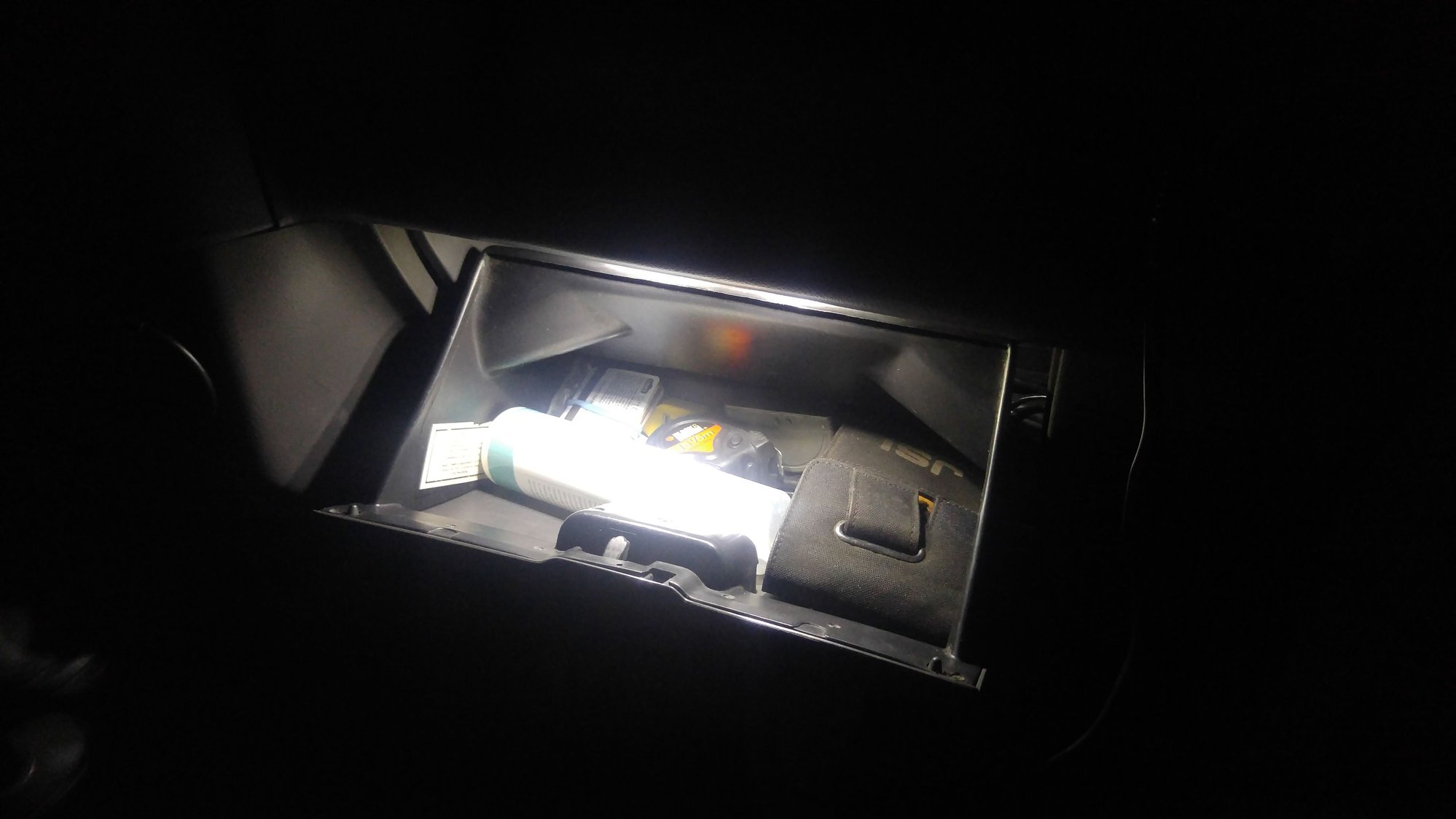

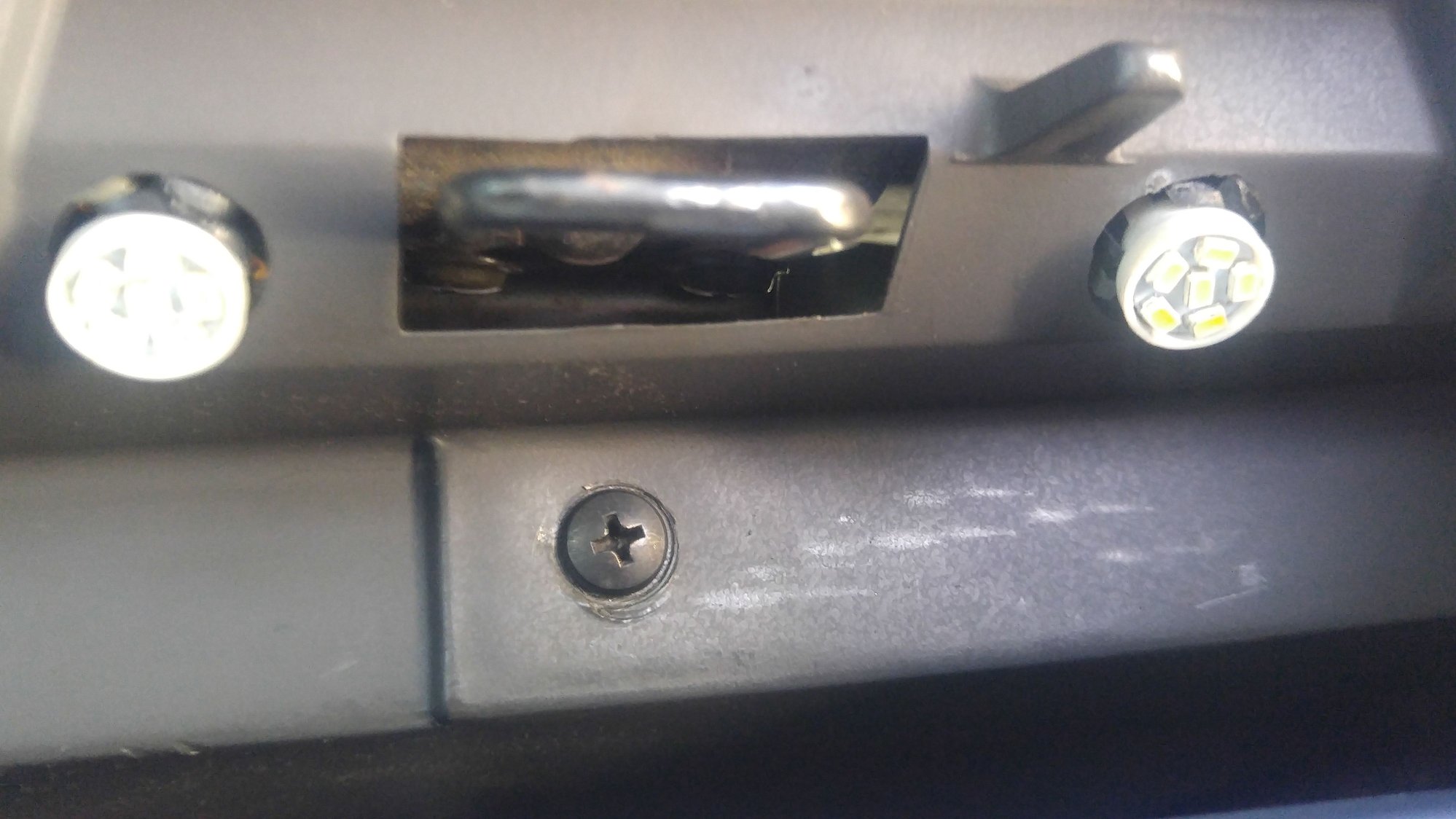

Here is what I did to add lighting in the glove box. Also added foot-well lighting that work with the dome light. I had some extra LED T10 bulbs so used those and the switch was from amazon: https://smile.amazon.com/gp/product/...?ie=UTF8&psc=1
Nice! A lot of light.
