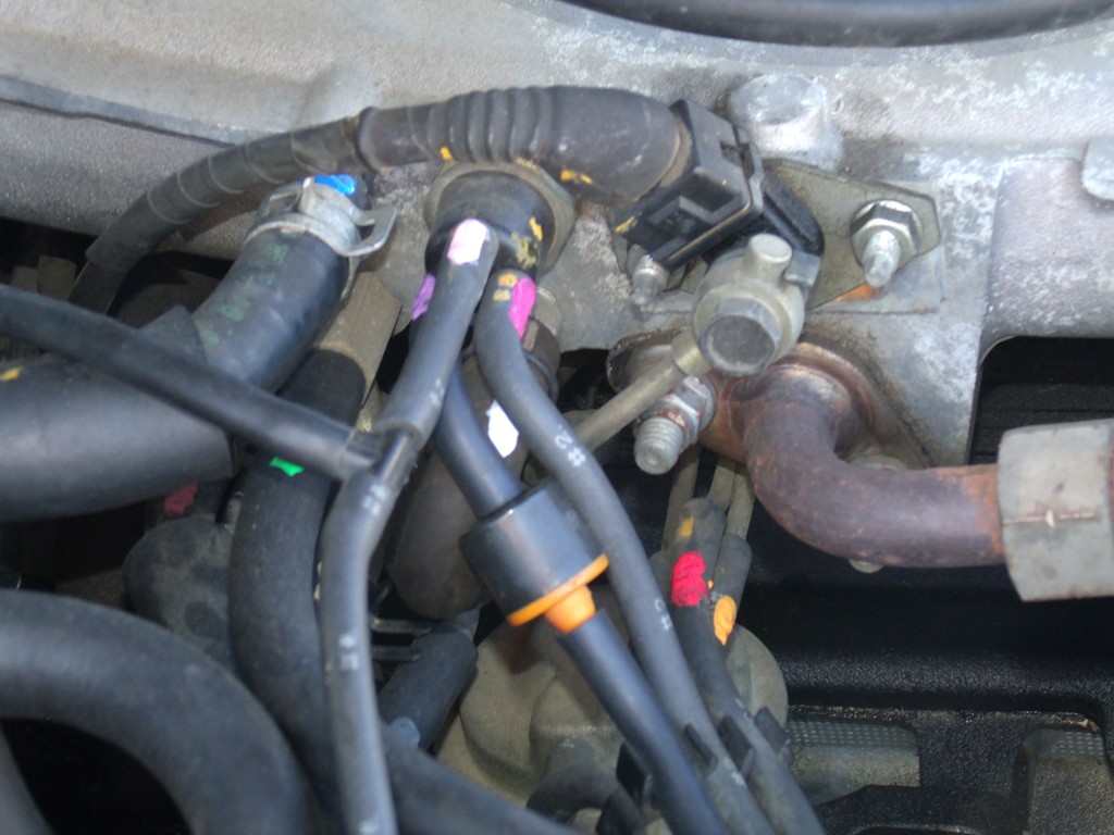

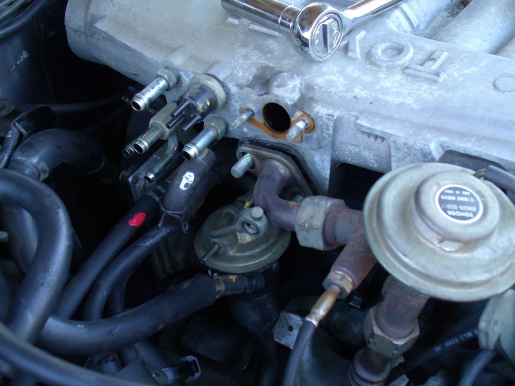

I've got some photos at home that I took before I did a valve adjustment. It might have some more angles/info the other photo doesn't. Just ignore the colors, it was just so I could identify the hoses easier. Here they are:

I also had a couple of problems with the cluster of hoses on the passenger side. I posted this on my thread for situations exactly like this.
Here ya go. hope it helps.
