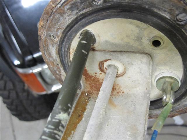

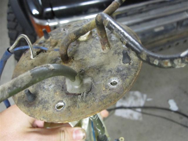

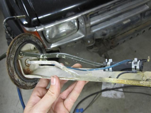

You can make that new tube. If you are talking abou the line that goes down from the from the fitting, through the plate, to the fuel pump, I made mine and it works perfect. The hard part was getting the fitting loose (I ended up replacing my fuel line all the way back to my fuel filter). I would just go to Autozone and get a steel brake line for $3. They have the fittings you need and already have the flare. I took mine fuel pump housing off of the tank, cut the bad piece of tubing off on both sides of the mounting plate. Then I drilled out the hole a little so the new tubing would fit through the hole in the plate. Then I just put the 90 bend in and the offset with a brake line bender, installed it and used a little JB weld to seal up where the tubing comes through the plate. It works great!! If you want I can send you some pics.....I am in the process of replacing my fuel pump, so I have it disassembled right now.

Here you go. I actually got the idea from someone here on yotatech. Th6" e green line is the new one. If you make the hole tight on the plate, you really only need to put the JB Weld on the top. If you look, you can see that the JB Weld didn't even come through to the gas tank side. The fix took about 15 minutes. If you don't have any tools at all, you would have to buy a phillips screwdriver, a tubing bender ($5 at Pepboys), a small tubing cutter ($3 or $4 dollars at Pepboys), and a piece of 5/16 brake line ($3 at Pepboys). So, without any tools what so ever, you could do the fix for $20 give or take and 15 minutes. Personally I replaced all of my screws and washers from the top of the fuel pump bracket as well. That took me an additional $2 or $3 dollars at Home Depot. They have metric screw and bolts there.
Good luck man.
