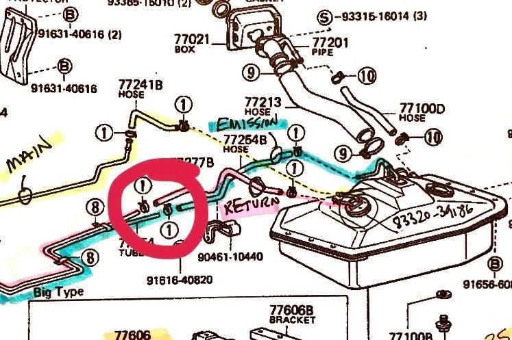

Thx Scope103 - vented gas cap reinstalled. So, after scrobbeting about under the rear cross member and top of the gas tank it is clear the the PO (AKA “The Bodger”) connected the emission evap line to the fuel return, and the fuel return to the emissions at the mid-way soft hose connectors. I think that pretty much explains everything. Thoughts?

Hey, good job! Your fuel return was pushing enough fuel into the vapor line, that when you stopped and the vapor pressure increased, it pushed it into the canister. Well, that's my guess.

The evap line is plumbed at the top of the tank and the fuel return to the bottom, so swapping these under the vehicle gives exactly the symptoms you had.
The quick test is to shoot some air into the evap lines to the tank and listen for bubbles thru the filler neck.

Co_94_PU - On my 97 RN37 the vent and main fuel lines run to a double-outlet plate on the front/top of the tank, the evap goes to a higher/centered single-outlet plate so easy to switch the double outlet at the hard line to soft tube intersection, as the routing is well-hidden above a cross-member and the tank itself.
Reversal happened at the red circle as both lines come out from above the x-member onto the floor pan
