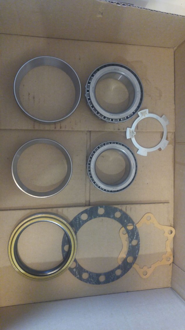

These quality Japanese-made KOYO bearing kits are on sale: https://www.marlincrawler.com/axle/f...it-1986-95-ifs
Mine came with everything in the picture below, I would check with them to make sure everything is still included in their kit:

Could you list the part numbers to the bearings by any chance?

KOYO stamping on inner bearing: LM104948, outer bearing: LM102949.
Kit part# is MCAX-1522 from Marlin Crawler

+1 for Koyo.,OEM for our trucks, and Marlin Crawler where I got my rear bearings from. Plug and play kit.
